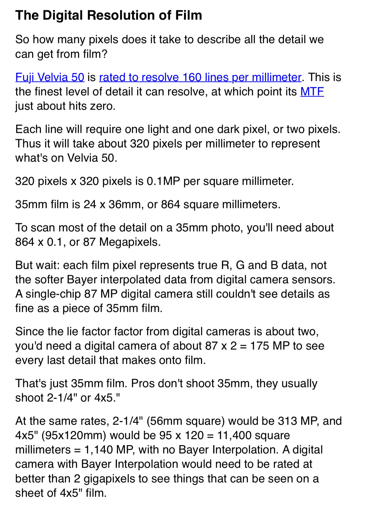

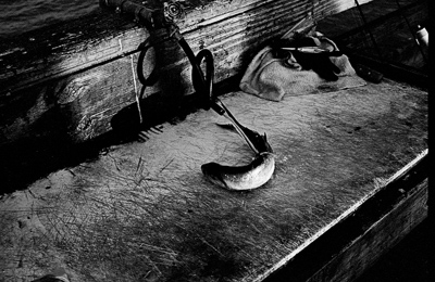

Do very low ISO films, 25 or Fuji 50 need a better lens to show its resolution...?
Good to know...!

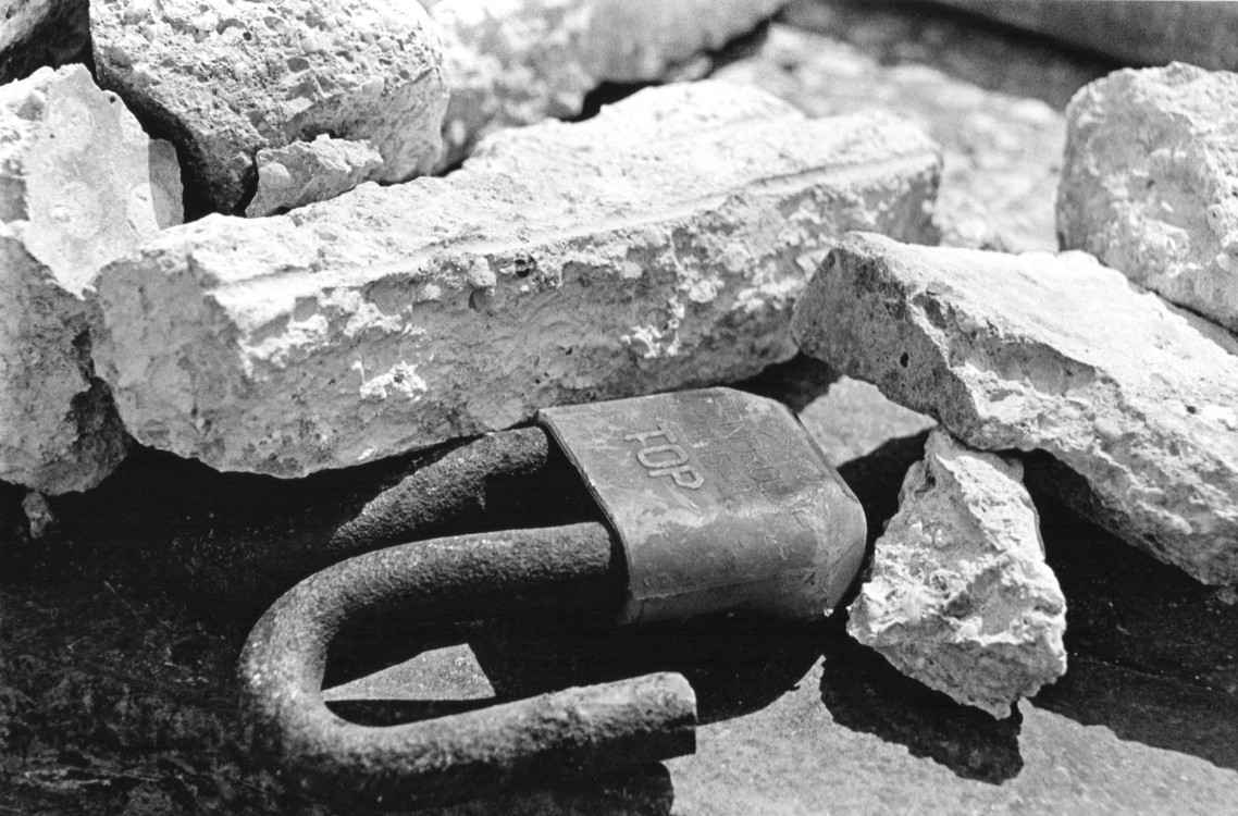

Here is a print scan from a negative shot hand held with a Nikkor 85mm f/1.4 - hence the lack of DOF and perfect sharpness. It still manages to look pretty sharp to my eye....
You have hit on a crucial factor: how it, "looks ... to my eye." The original question was about achieving the full resolution of the film. We can discuss this in technical terms about what can be objectively measured and leave it at that. But for most photographers, what they ultimately care about is how the image is experienced by the viewer. This opens up an entirely different can of worms about the human perceptual system. If perceived sharpness is a goal, there are a number of things the mind uses to gauge sharpness, including contrast. These factors may not exactly align with objective measures of resolution like MTF charts. In comparison, the importance of psychoacoustics is well understood in audio recordings. Compressed audio formats rely upon the characteristics of human hearing processes. It is known that human perception is VERY context-sensitive. How a color is perceived depends on what other colors are nearby. This is true of sharpness as well. How sharp one area of the photo is, is influenced by how much sharper it is than other areas of the photo. For example, the in-focus area of Chuckroast's photo will appear sharper than it otherwise would because part of the scene is out of focus.

That was shot with an 85mm f/1.4 Ai-S that I bought a while back in sort of minty condition. The old Nikon manual Ai and Ai-S primes still show up well against modern AF plastic lenses. More to the point, I can use them on my film bodies and the one Nikon digisnapper in my stable. More recently, I got a 35mm f/1.4 that, stopped down, is razor sharp as well - at least when the film is properly processed.
But as good as they are, they pale by comparison to the results I get on 2x3 with a 101mm f/4.5 Ektar or pretty much any lens I own in my 4x5 stable.

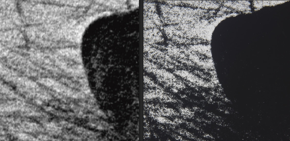

One of these is a scan of a print and one of these is a scan of a neg at 4000 dpi on my Nikon. All the theory stuff is crap. Use your eyeballs and decide.
This is the original image. You are looking at the area of the nose of the fish.
