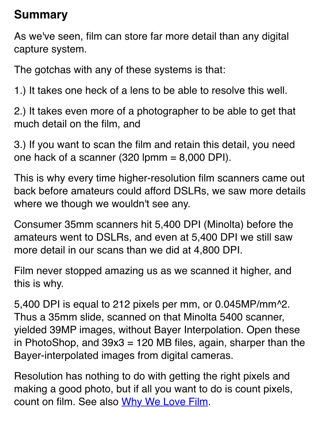

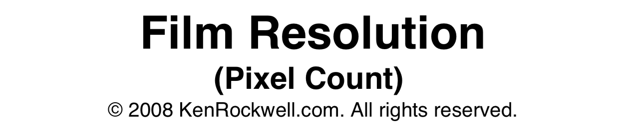

How can you be sure that those vintage Nikkors are actually capable of resolving the limits of resolution of film...?
