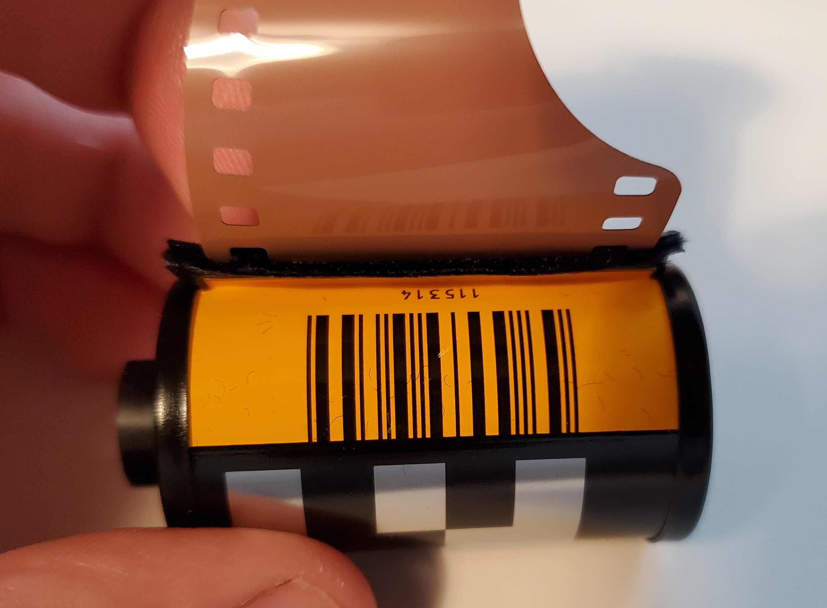

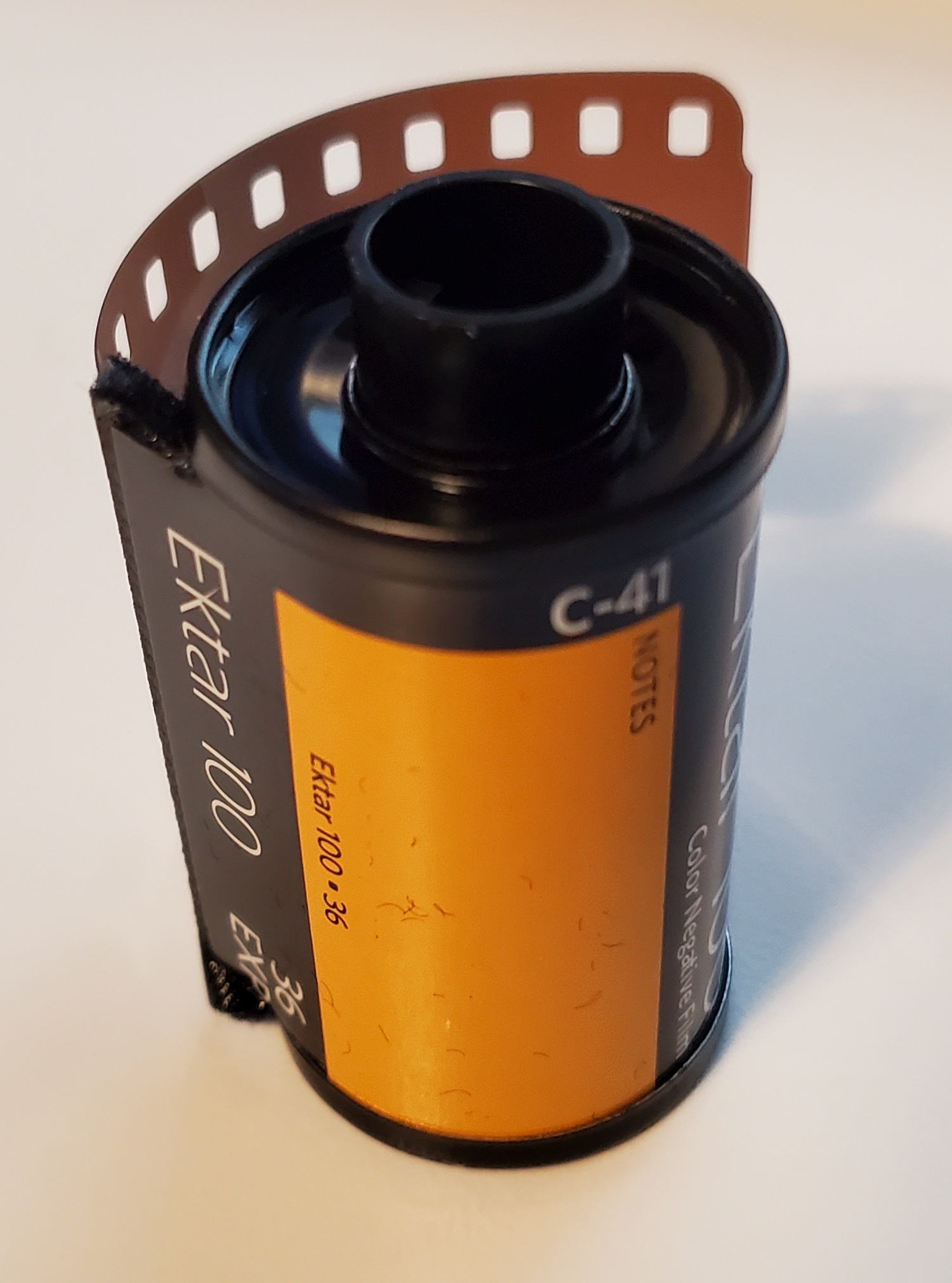

I was initially doubtful of the Kodak dust accusations, so I just unboxed a roll of Ektar that I've had in the freezer for the past two years... I've never had the felt "dust" impact negatives, but it seems to be a real occurrence.

So I got curious, and started looking through the factory load 35mm film cassettes I have.
Almost none of them are current dated - I've got a decent amount of older refrigerated and frozen 35mm film, whereas my more recent film is mostly 120.
There was a fair variety in the appearance of the felt in the 35mm cassettes, which were mostly Kodak, but included some Ilford and some Fuji.
The picture shown above looks a fair bit like some of the old (1990 Kodachrome and the Fuji, but also like some middle aged T-Max. That picture just looks like how Kodak felt tends to look.
None of them are shedding any loose lint, and there is no loose residue on anything.
