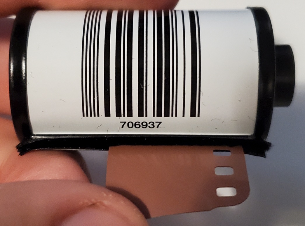

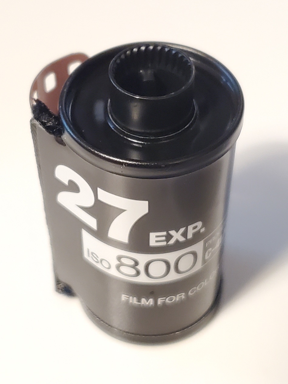

what were the markings on the cartridge. Kodak also uses a distinct spool on their one time use cameras. (with a gear design)
Here's the loaded cartridge I pulled from one of the cameras.

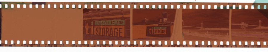

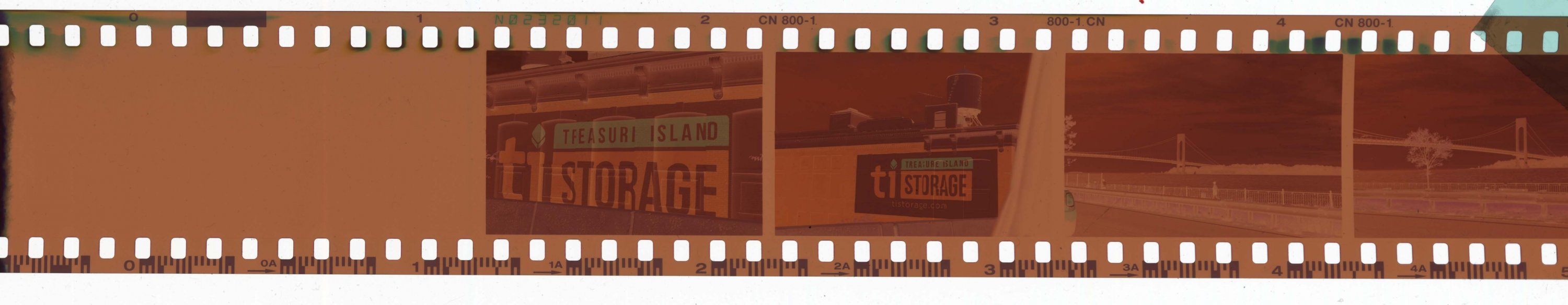

Here's a quick scan from the beginning of the roll. I believe the cassette spool had no notches in it. Upon closer inspection the base seems to be acetate rather than polyester but I'm not totally sure.
FWIW, that would be about what I would expect of the film if it was packaged using Kodak equipment.
I would also expect camera negative film to ordinarily be coated on Triacetate base, at least in 35mm. some 120 is on an ESTAR style base, but 120 has less of a risk of Light Pipe effects.

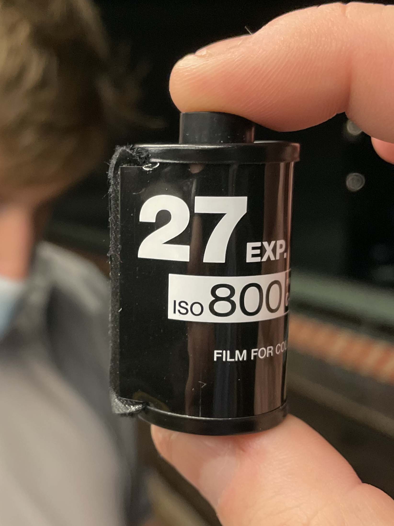

I can confirm that the roll did indeed come out of a fresh Quicksnap purchased recently from Unique Photo, but I am as baffled as everyone else about how it got there! I removed the roll and shot it in a "real" camera. This is what the cassette looked like although I didn't get a picture of the top of the spool before tossing the empty cassette. I am trying to get my hands on some more Underwater Quicksnaps for further research.
Another possibility is, maybe Lomography buys 800 speed CN film from the lowest bidder. Maybe one batch from Kodak the next from Fujifilm. This is a great story, thanks for the detective work.:smile::smile::smile:
View attachment 283086 View attachment 283087
That is definitely Kodak. You can clearly identify it by the huge amount of all the black dust particles which are spread all over the film cassette. It is typical for all 35mm Kodak films.
And if you look inside the cassette, you will find these particles there, too.
These dust particles are from the velvet from the slit. Kodak is using an inferior material compared to all other manufacturers. Therefore you don't have this dust problem with 35mm films from Fujifilm, Ilford, Adox, Foma.
My local lab - Kodak customer for over 70 years - is permanently complaining about it: The velvet is crumbling and spreading the particles all over in the lab. Much more lab and machine cleaning is necessary because of that.
To avoid having all this dust in my 35mm cameras (and facing possible shutter failure because of accumulated dust in the long run) for years now I am cleaning all my 35mm Kodak film cassettes before I load them into the camera. A bit nerve-wrecking of course, but much much better than any camera damage which could occur of that in the future.
