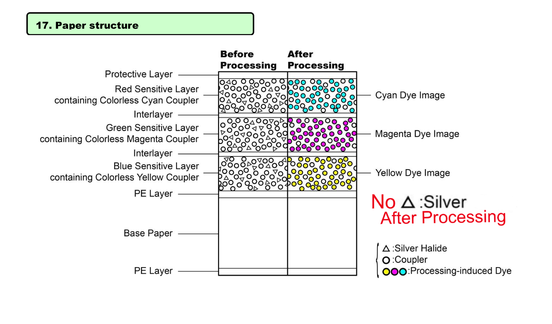

This stock is strictly tailored to the wavelength of the green laser on the Arri Laser Film Recorder.
It's not gelatin silver!
RA4 is colour.
Do I have a mistake here?
RA-4 paper is a silver-halide product as b&w paper. And silver-halide products is what Fuji referred too. And thus they are right.
Yes, it could be silver halide, but it's definitely not Gelatin Silver Paper.
When I first read the original post, I thought the OP means "Gelatin Silver Print"(in which metallic Silver embedded in the Gelatin coating) when he noted to "Silver Halide".
Ilford has more accurate definition:
https://www.ilfordphoto.com/silver-halide/
The following photo, page 5/6, From: https://www.fujifilm.eu/fileadmin/c...et/PIB_Professional_Textured_Paper_Canvas.pdf
Chromogenic, c-type, ra4 or photographic paper, could be more accurate alternatives.
I'm honestly happy to see photographic products coming back more popular.
But also, I think it's a candy gift trick to direct digital photographers to what looks to them as a big participation in film photography world.
Of course it is Silver Halide.
And from my (engineering) point of view it is Gelatin Silver Paper.
But keep in mind this term is not even found in the Focal Encyclopedia, neither is Silver Gelatin. But I know the latter meanwhile is used by art historians. But this shows how tricky terms can be.
