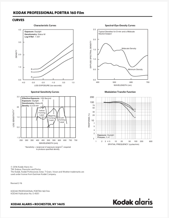

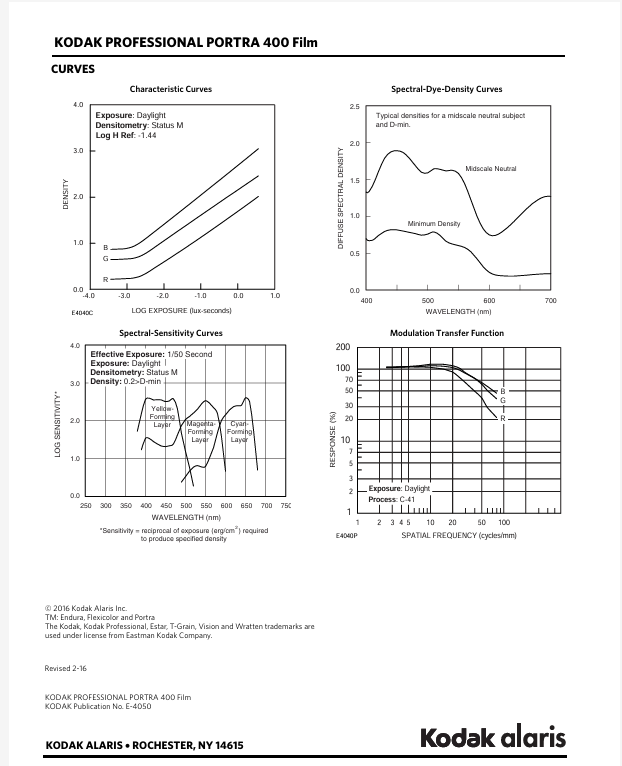

I'm skeptical about the claims about the Portra line in that linked web page.
From the datasheets:

MattKing, thanks for the Portra data sheets. I'm not sure if I understand the graphs. Am I right that the graph relevant to dynamic range is the first one in each document, the one labeled "characteristic curves"? I'm looking at it as meaning that the exposure has a latitude of -3 stops to +3 stops. I'm probably interpreting it wrong.
You are correct, but it is important to understand that the curves are truncated, in that the only data reported is the data that corresponds to where the films' performance is linear and fully usable in real world situations.
There will be response past the end of those curves. It is just that past those ends the quality of reproduction will be much less valuable.
I shared those, because they show how similar the film response is in the range where it is fully usable. The fact that one can get a bit more low quality response past the ends of the curves doesn't really tell you much of value if you intend to take photos that print or display well.

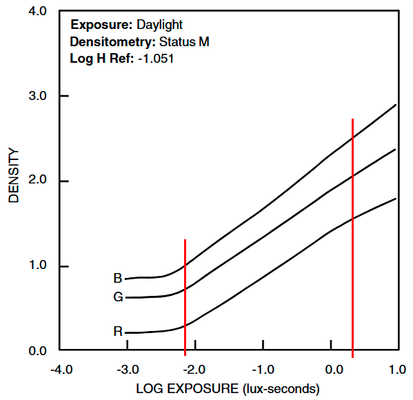

You're indeed interpreting it wrong. The x-axis is 'log exposure', not stops. Approx. 0.3logE = 1 stop. But you have to look closely at what part of the curve is actually usable:
I drew in red lines that show the approximate range over which the film can be expected to yield good/excellent results. At the left end, the range is restricted by the 'toe' of the curve where it flattens out; these are the deepest shadows and as you know, underexposing negative film makes the shadows turn into undifferentiated mush. That's what happens if you allow important parts of the scene to land in this toe region, or even to the left of it.
On the other end, the range is restricted by the crossover behavior of the film. As you can see, beyond the ca. 0.25 mark, the red curve starts to flatten off a little bit. The net result image-wise is that highlights that received this amount of exposure will be relatively cyan (lacking in red). You can't always prevent that sections of your image land on this part of the curve (brightly-lit clouds or snow-capped peaks), but it's best to prevent important parts of the scene to steer clear of this part of the curve.
As you can tell, this leaves a part of the curve that runs from ca. -2.1logE to 0.25logE, so a range of ca. 2.3-2.4logE. Divide by 0.3 gives 7.5 to 8 stops of range in which the film can be expected to yield very good results. Below that (underexposure), things will turn into muddy mush. Above it, you'll run into cyan crossover territory. The latter is generally more desirable (less problematic) than the former. Because of that compromise, people sometimes argue that the dynamic range of the film is much greater than the ca. 8 stops. Sure - if you're willing to sacrifice some color fidelity, you could allow highlights to fall in this crossover territory. Especially in the digital darkroom (a.k.a. Photoshop), it's relatively easy to correct any problems that result from this, at least for the most part.

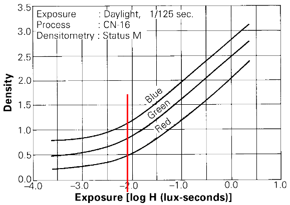

As to Fujicolor 100, it's difficult to get good data on this since this film is available so scarcely and apparently also only in certain parts of the world. There's allegedly a datasheet for it, but I honestly have very severe doubts that it's representative for the product as it's manufactured and sold today - but who knows. It can be found here: https://www.fujifilm.com.hk/products/consumer_film/pdf/superia_100_datasheet.pdf
Let's look at the characteristic curves in that datasheet:
As you can see, the toe region of the curve is quite different from that of Portra 160; while Portra's toe is quite sharp, the toe of this particular Fuji film is very gradual. This makes the choice of what section of it is considered usable quite arbitrary; I've drawn in a rather conservative and arbitrary red line to indicate a possible point. On the other side, it's impossible to give a good cut-off point since the curves run nicely parallel in the plotted section and seem to continue on like this possibly beyond the point where they stop. Assuming that you could at least get good results up to the point where the curves stop, the range would be something like 2.5logE or a little over 8 stops. It's quite possible that you can get a little more range from it in practice.
