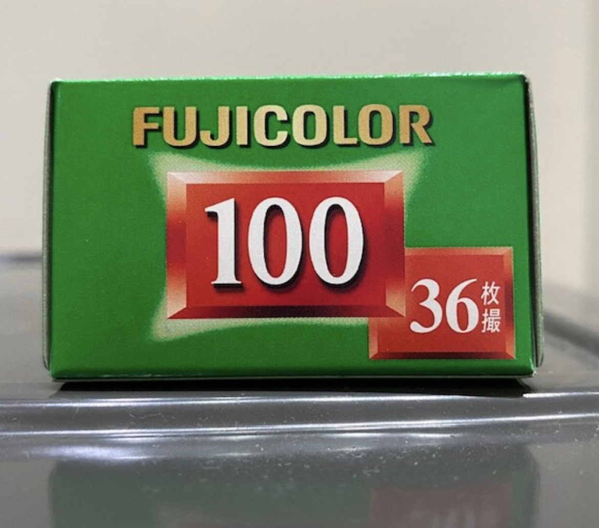

I took delivery today of three 36 exp. rolls of Fujicolor 100. They were purchased from Cat Labs. The price per roll is embarrassingly high. As far as I know, Fuji had stopped sending 100 speed color print film to the U.S market years ago. The writing on the boxes is almost all in Japanese. The expiration date is April of 2026 so I am guessing that Fuji is still making it. It will be interesting to see what the colors look like and whether this slow film is any sharper or fine grained than Portra 400. I think it costs more than Portra 400.

Could you get some photos of the box online, please? This might prove useful for future reference.

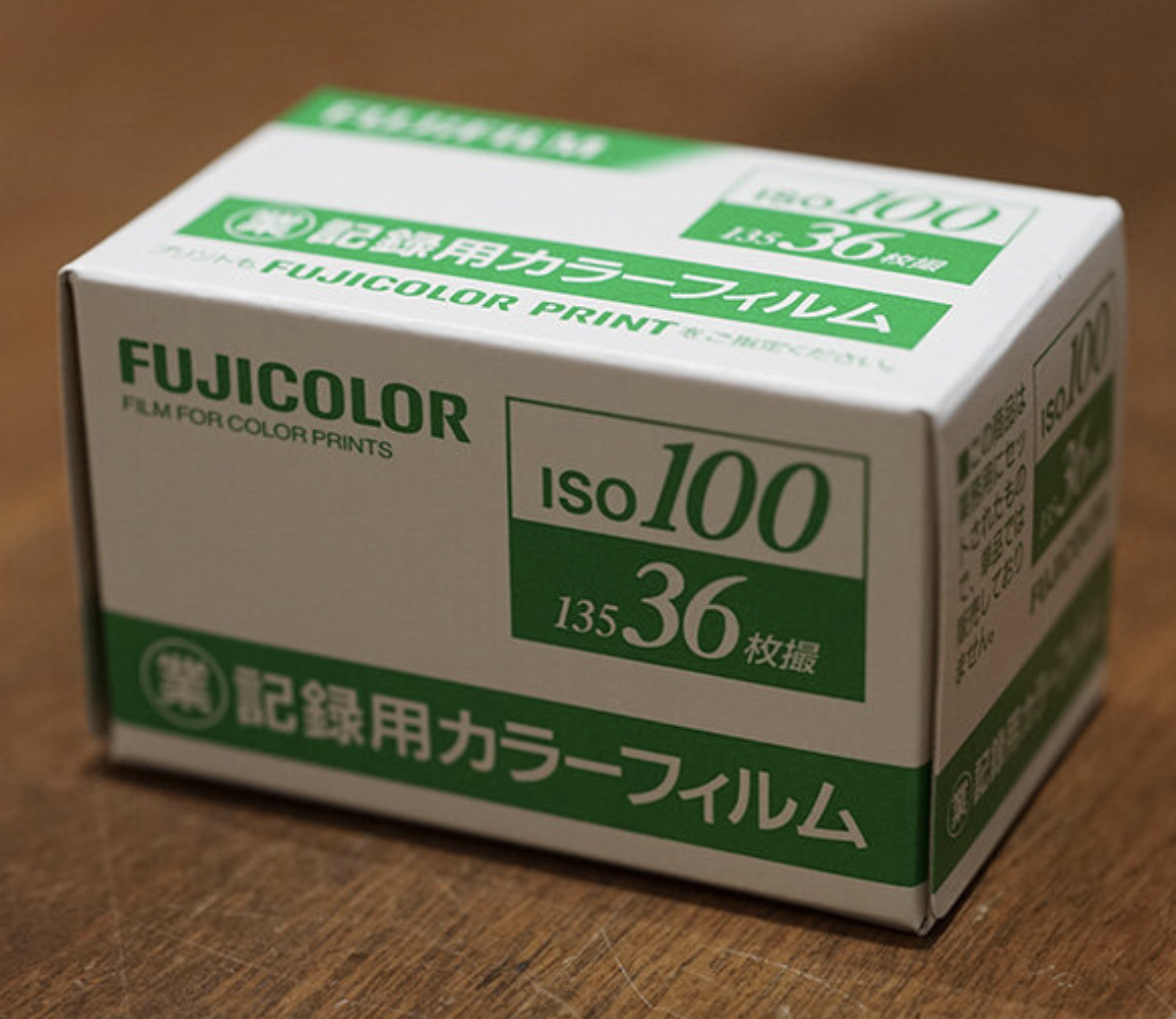

BTW, I've seen two different versions of Fujicolor 100, are these the same?
