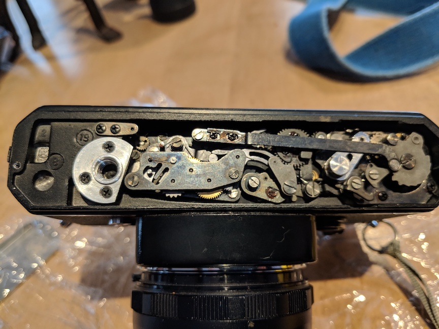

Hi all, I have a Fujica ST801 that basically I bought for the Takumar 50/1.4 that was attached to it but it wasn't sold to me as a non-functioning camera. At any rate I never tested it then gave it to someone who said the faster speeds were off. I took it back and just now have gotten around to testing it myself. At a basic glance the shutter moves fine, the slow speeds seem a little slow and B does not open it just acts like it's 125 or something fast. I shot a roll thru it, using speeds from 125 up to 2000 (which I thought was iffy in and of itself). I even put in a fresh battery to make sure. Sure enough completely blank roll, nada. Could the dial be on wrong???
any ideas what I can look for and is it worth sending off to be fixed? Or should give it away as a project camera?
Thanks in advance!

Focal plane shutters in 35mm cameras use 2 shutter curtains. Each curtain is would on a spool on bearings with an internal spring and a bearing spool OR a double spool arrangement on a shaft. Both curtains should run the same speed or as in the Spotmatic the second curtain runs slightly faster than the first.
Operation is the first curtain is released then the second curtain is released to form a slit that is swept across the film plane. The width of the slit depends on the speed selected. When slow speeds are slow the curtain spool bearings are likely dry or gummed up by dried out grease/lubricant. When faster speeds are off or no slit is formed the second curtain is being released prematurely causing the curtains to be together. If the curtains are stuck together there will never be a slit at any speed.
The camera you are inquiring about likely has both curtain spool/transport issues as well as release issues will require the top to be removed to service the release. Earlier cameras used mechanical release while later cameras used electronically controlled solenoids to release the curtains.
https://pentax-manuals.com/manuals/service/servicemanuals.htm A Fujica AX-1 service manual is at the bottom of the page.

Batteries matter not with the ST 801 except for the meter. Underneath the bottom plate are two ratchet screws which govern the shutter speeds. The one closest to the front of the camera governs the slower shutter speeds (second curtain) and the one closest to the rear of the camera governs the higher shutter speeds (capping). If I were there I would fix matters in 10 minutes but I wanted to at least tell you what was involved.
A little lighter fluid injected into the timing mechanism (box under the mirror) would not hurt. - David Lyga

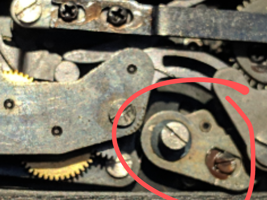

Hmmm, new hope for the camera. I think the one circled may be the slow shutter speeds. Which is the fast? Plus there is a fast shutter speed cam under the top plate. I have no problem attempting it if I knew what to do! I can find nothing on YouTube or anywhere to explain this.

The shutter assembly instructions for the shutter in the previously AX-1 manual look very close to what you picture. I would flush it with 90% Isopropyl Alcohol or Contact Cleaner and operate while wet before turning any screws.

Camera repair manuals tend to be written for factory trained technicians and may be daunting for the average tinkerer.
Looking at the total mechanical works as one piece they can be quite daunting. Looking at the sub system that needs repair then its not that bad, but you may have to remove some other pieces to access it. You can't eat a 1 pound rib eye in a single bite, can you?
Get a can of CRC QD Contact Cleaner https://www.homedepot.com/p/CRC-11-oz-QD-Electronic-Cleaner-05103/205021975 . Thoroughly spray all gears and levers visible in the bottom. tack the bottom plate on, then cock and fire the shutter multiple times with the camera upside down then right side up. Remove the bottom plate and allow the camera to dry.
Soak a wood toothpick in clock oil or TriFlow https://www.amazon.com/Tri-Flow-Squ...9117&s=gateway&sprefix=triflow,aps,212&sr=8-3 and apply a straight pin point drop on all gear shafts, pivots, and wipe the edges of sliding parts that are accessible without any further disassembly.
Doing the same for the top is optional. Test the camera again upon completion and again after a week or two of non use. Odds are it will work better if not correct.
The cleaner and oil may be available at a hardware store close by.
Remove the three screws of the tripod mount to access these shutter tensioning screws.
