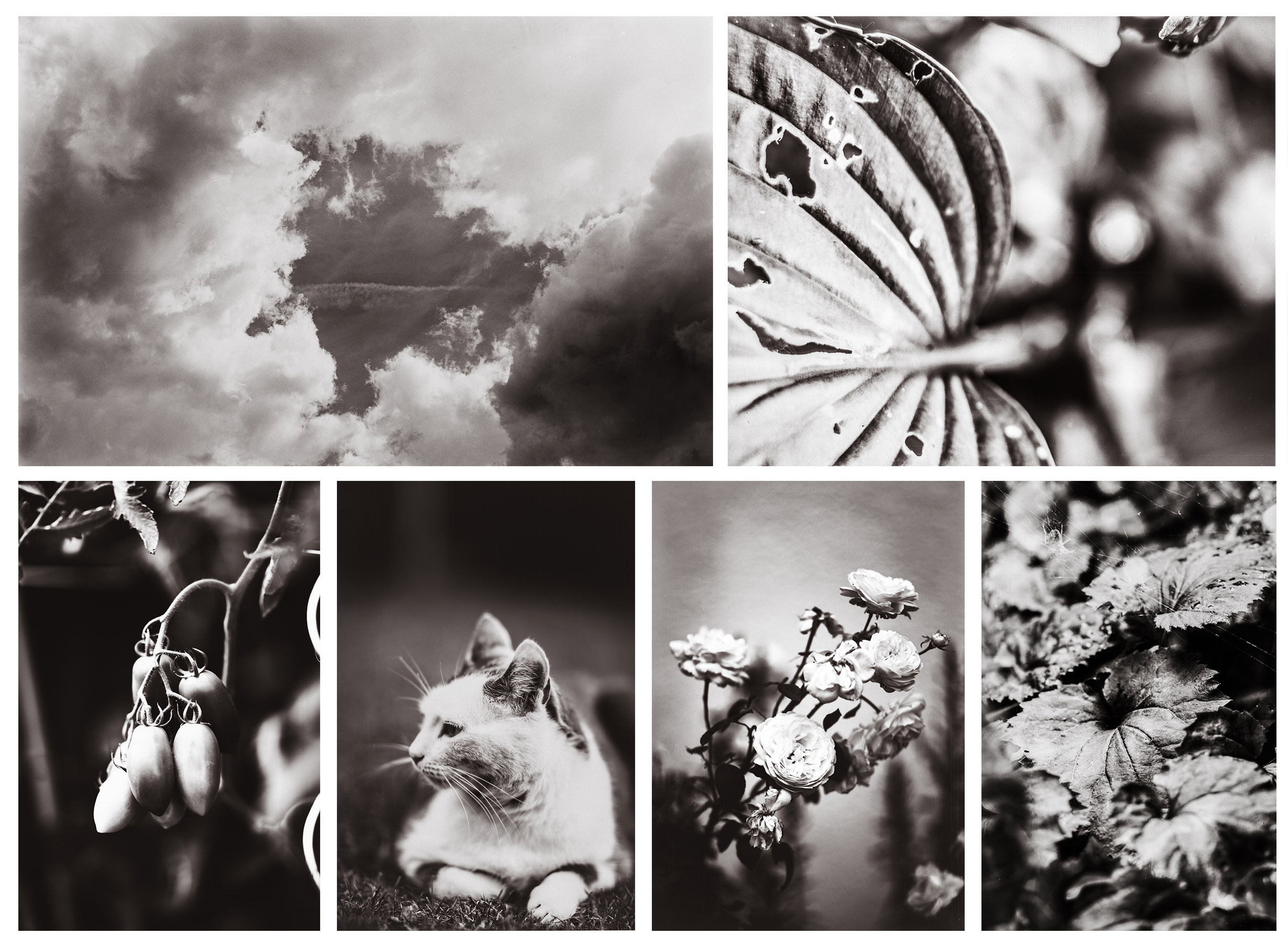

Hey folks,
I just wanted to share with you my experiences using FUJI Super HR Microfilm.
Shot at ISO 20, developed for 40mins stand in FX-39 at 20°C.
Do you have any experience with microfilm ?

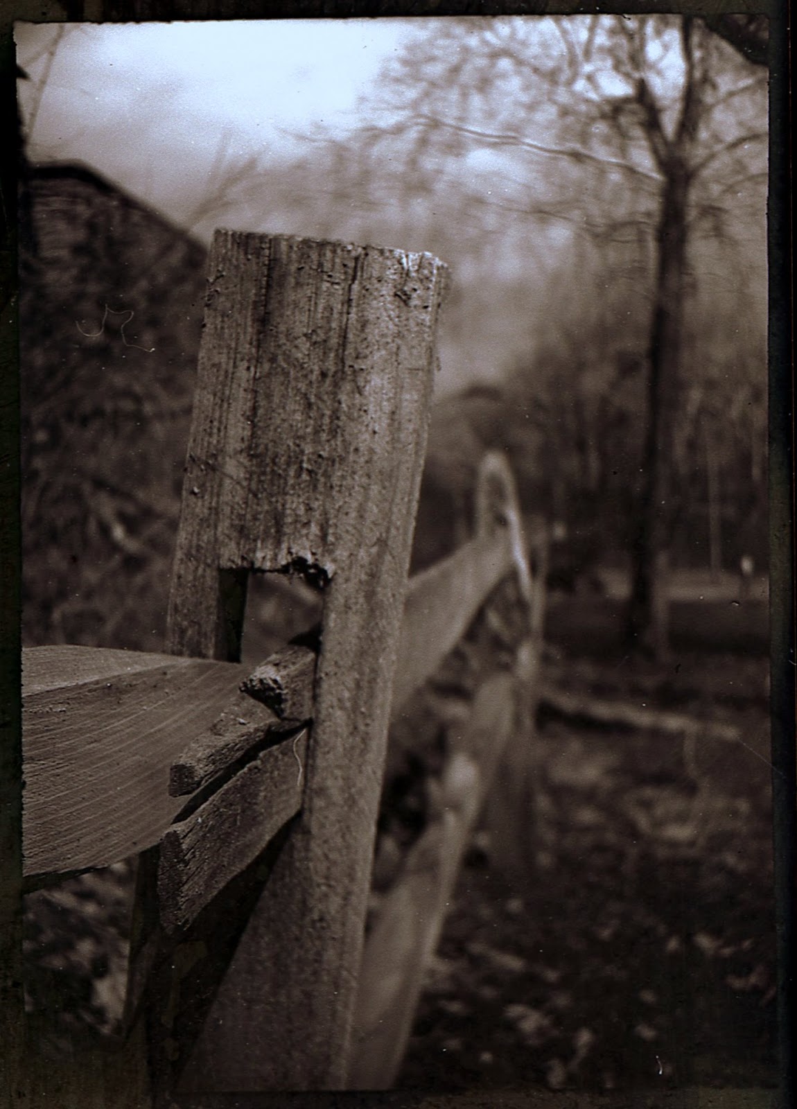

I use Kodak Imagelink with good success as a great alternative for reloading 110 cameras to give me fine grain shots with shallow depth of field in a way that belies the format.
I find the following things work great to get pictorial contrast...
Overexpose: try exposures at EI 10-12 if you can. But be careful in bright sun to avoid blown highlights.
Use color filters: A yellow is a great starting point. A green is even better, and in some settings, blue and orange filters can be magic. The fence shot attached used an orange filter.
Dilute develop: 1:100 HC-110 is my preferred soup with a time of about 20 minutes with one mid term agitation. Finding the sweet spot between the exposure and the developing is a challenge but a fun one to win.
