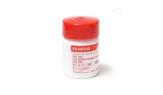

Yes, and that's not really something you'd need in a home darkroom.
An alternative to the 'official' final rinse for a C41 would be a combination of:
1 A dye coupler stabilizer (but this is optional/unnecessary for modern films).
2 A surfactant to reduce the risk of drying spots.
3 An antifungal/antibacterial compound to prevent biological damage to the film later on.
There are many ways to skin these three cats. A simple solution that will work well in a low-volume environment (e.g. home darkroom) is to use demineralized water, add some photoflo (according to the mfgr's instructions) and a few drops of formalin solution. The demi water + photoflo address #2, while the formalin addresses #1 and #3. If you can find something that will address #3 only (and isn't nastier than formalin and doesn't leave residue on the film), you'd be good for modern (post ca. 2000) films, too.

The local Fuji distributor does not offer the C-41 stabilizer for some reason.
This is interesting. I've seen these bottles but always thought they were for minilab maintenance. They are available and very cheap.
