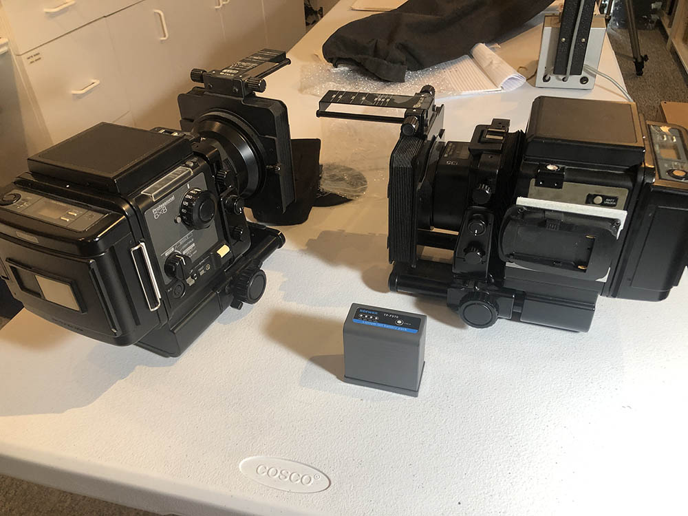

The 680 is a really amazing camera. I have two of the first model. I made a simple battery adapter on my 3D printer that allows me to use cheap and easy to find (on Amazon) rechargeable batteries. My point here is - if you can find a Model III at a good price, go for it! If you can't I wouldn't worry too much about getting a model I or a II. you might save some $$$$ you can spend on film. For me and my needs the I works fine. Your mileage may differ.

I was posting to let you know the model I and II's are solid machines, and are often overlooked, and yes the battery is really not a big issue. Sorry, if I confused the issue, I am not interested in selling right now. However if you land a nice model I or II, I would be happy to walk you through a variety of battery solutions.
All the best,
Paul
Here are my two model I's modified to use standard video camera batteries.
thanks for clarifying, for the pics, and for the note of encouragement toward the earlier models. if i get impatient in my search, i might go for one of those. they are a bit of cost savings. i even saw someone with a rechargeable battery set up that seemed nice.
