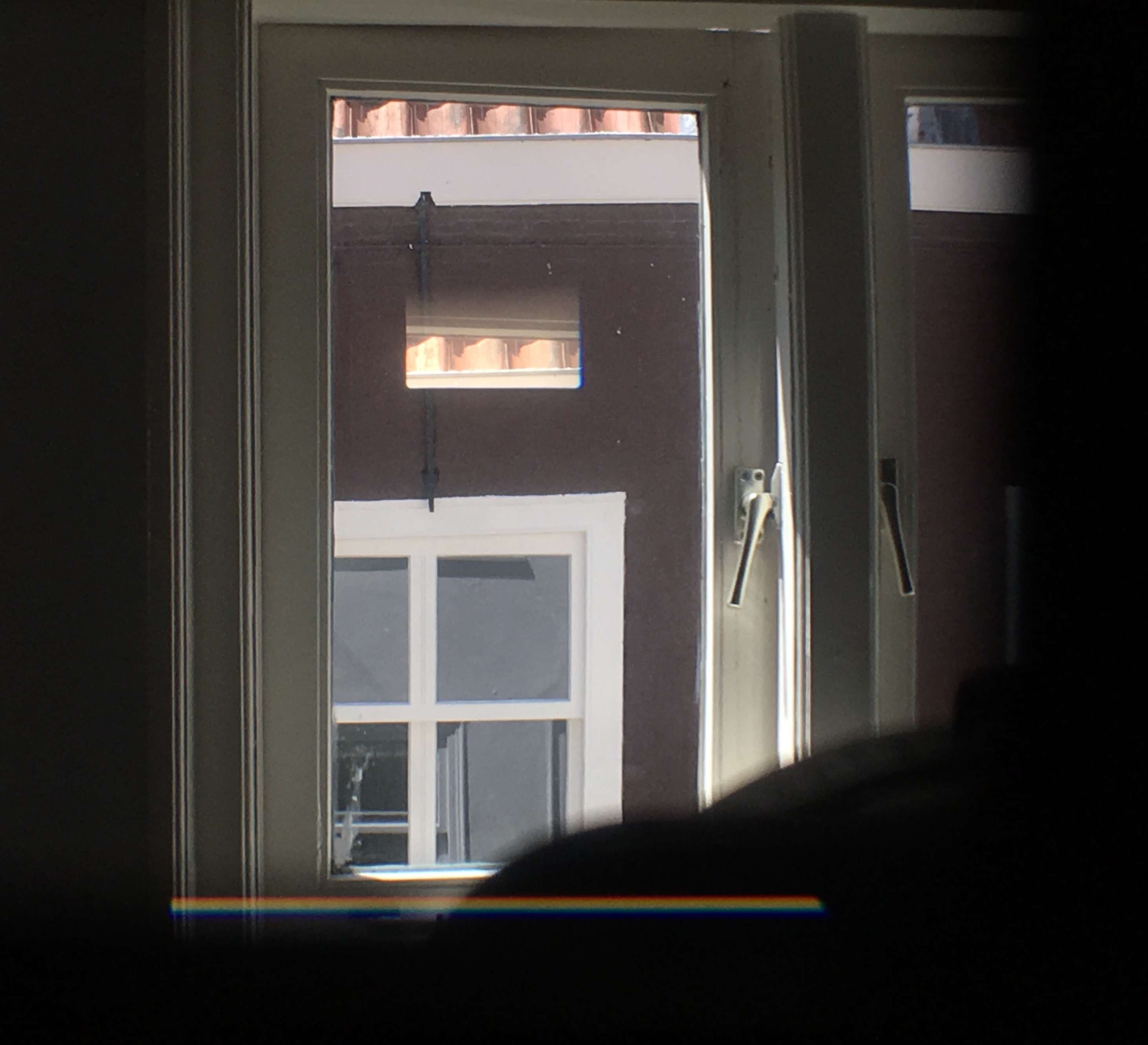

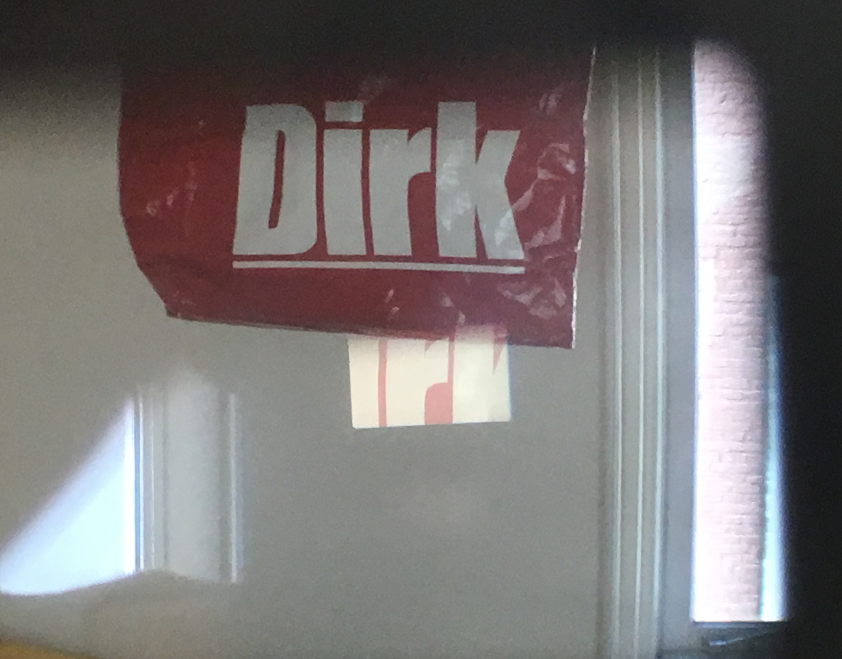

Hi Ken, i know this is an old thread, but i hope you can still help me. I tried to calibrate my gf670 rangefinder because it was not as sharp anymore. Now i think i did something wrong or touched something, because the image in the rangefinder patch is way off and i can't get it closer / merge.
I made a photo with my phone trough the finder to show what i mean. It's not high quality but you'll see the square rangefinder patch is way under the subject/letters IRK. Do you know what this is? Is it one of the screws that i need to turn? I really appreciate if you can give me some advice. Thanks, Maarten Schröder

The proper distance to start calibrating the telemeter would be the minimum of focus that I think is a meter and a half from there is a medium distance and shortly is already constituting the infinite, in his ring of focus should see indications of those distances Which will coincide with the parallel images if those objects are at the distance indicated in the focus ring of the camera, luck and a greeting from Madrid
la distancia apropiada para empezar a calibrar el telemetro seria, la minima de enfoque que creo que es un metro y medio apartir de hay una distancia media y al poco ya se consige el infinito, en su anillo de enfoque deveria ver indicaciones de esas distancias las cuales deven coincidir con las imagnes paralelas si esos objetos estan a la distancia indicada en el anillo de enfoque de la camara, suerte y un saludo desde madrid

Thank you for your reply. I will try this distance. But my problem is that the rangefinder patch won't merge with the subject. Normally i would take it to a camera store, but i am going to travel soon and i really want to bring this camera. On internet i could only find horizontal calibration. Then i found this thread and signed up. I have added another picture attached to show what i mean. You'll see i focus on a brown wall outside my window..but instead i see the orange/roof tiles in the middle. When i turn the focus ring it just moves from left to right, so the actual problem: the rangefinder patch thinks it is focussed on the orange roof instead of the wall. If someone has a solution or advice for this it would really help me. Maybe know which screw i have to turn. Thanks in advance, Maarten Schröder

I have found you cannot apply too much pressure to the left and center adjustment screws or the mechanism can be jammed low, causing your vertical focus issue. Have you adjusted using the left adjustment screw a bit to recover the vertical alignment? There might be quite a bit of trial-and-error in doing this. When I received my GF670, it was off a bit vertically and drove me nuts, but a few turns in small amounts finally locked it nice and crisp.

Scott, I know this is an old thread, but since you mentioned it. Which screw does the vertical alignment? The large one on the right does not appear to do anything (I tried). It's tightened to the max (clockwise) on my camera and making it more loose doesn't change anything. I decided not to touch the rightmost screw (the middle one is what I touched, to adjust the horizontal alignment).
So.. is it the left screw that does vertical alignment?

There 3 screws (actually, 4, there is a body length adjustment, but it is under the cover). If you look down with a good light, you'll see the two smaller screws, one is vertical. I cannot remember which screw, but I believe it is the screw on the left.
