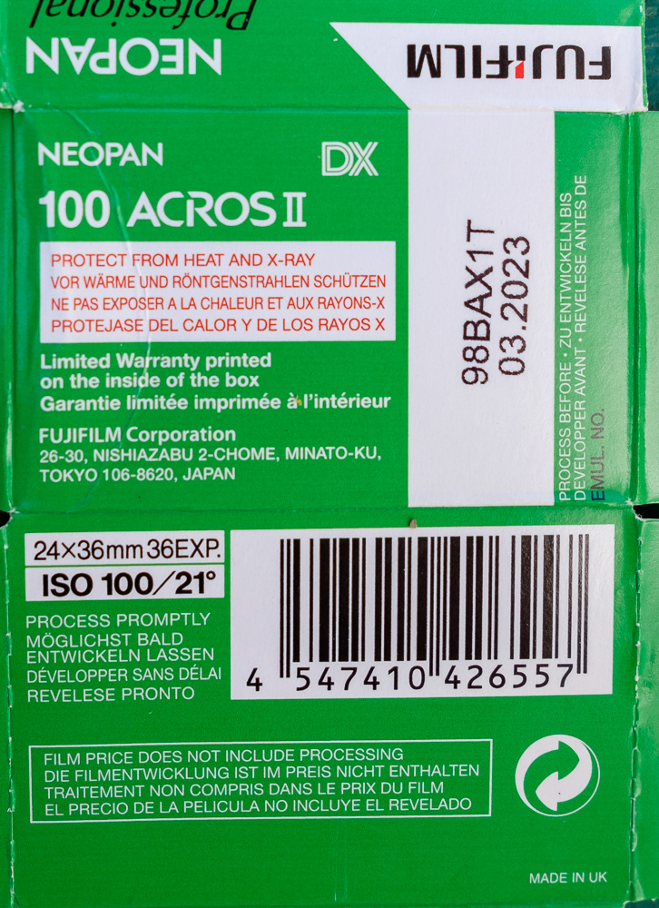

Just for the sake of discussion, let us say Fuji Acros II sometimes has faint edge markings. And we know Harman "makes" Fuji Acros II.
So how would that work? I do not know what method / technology is used to make the edge marking appear on film. Nor do I know exactly what it means to say Harman makes the film. Does Harman do everything, starting with coating the emulsion on the base? If so, do Harman use the same equipment to make Acros that they use to make their other films?
What I'm getting at is this: If the edge markings are applied by the same equipment Harman uses to make all their other films, then how / why would the Acros edge markings be different from Ilford or Kentmere films?
Optical exposure. Most likely with an array of tiny LEDs at this day and age. That's at least how Kodak does it, and Fuji seems to have been doing it that way for decades as well. The alternative is a small mask and a single light source; this is how e.g. Foma seems to have been doing it up to a few years ago at least.
Exposure settings can be different even if the same finishing line is used. And latent image stability can be different for various emulsions too, of course.
It may largely be irrelevant to discovering the problem that has caused the OP's Acros II to be totally blank but runwithsizzers has raised an interesting question All of the Ilford films I have ever developed that was fresh seemed to have pretty much the same density of edge markings when developed to the Ilford times but setting that aside can you say why the exposure setting on the same finishing would be different?
Secondly there is the question of why in the experience of some users, does Acros II seem to have fainter edge markings than the original Acros, assuming it does. This might be explained if the original Acros was done by Fuji but Acros II by Ilford but you'd think that the Ilford edge mark settings on its machine on the same line would be the same. This of course brings us back tó your statement of different settings and my question of why this should be.
Does the Ilford machine have a range of settings between which it drifts? In which case there has to be a range of edge marking visibility across the whole of the Ilford range, doesn't there? Does Ilford alter the setting specifically for Acros II and presumably at the behest of Fuji and if it is set appreciably lower then one wonders why Fuji has asked for this
