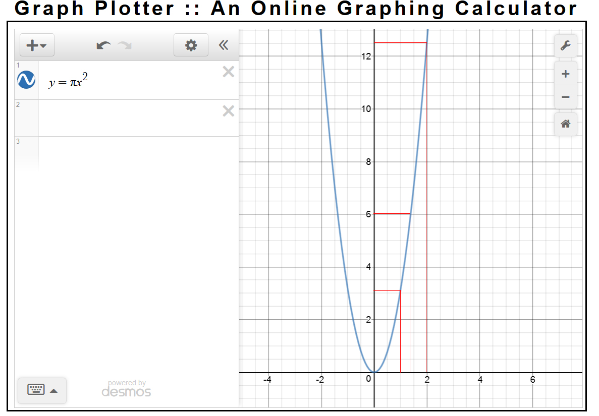

Hi guys,
Sorry for the necro bump. I was researching acros100 and came upon this thread. There is a misconception being promoted here so I thought it would be worth adding a correction to avoid the thread confusing future readers.
I've attached an image which is a graph of a circle's radius, x, vs its area, y.
When the radius is 1, the area is ~3 (pi). If the area is doubled to 6, the radius is ~1.4. Double the area again to 12 and the radius is now ~2. An area of ~24 gives a radius of 2.8, and so on. Pretty clear?
Same principle applies for inverse square law. Imagine a light emitting from the centre of a sphere. As the sphere's radius is doubled, it's surface area gets 4x bigger. That light or the surface will appear 4x dimmer as it is spread onto a larger area.
This doesn't apply to time though. If the aperture is constant, the light entering will be too. An analogy is water going through a pipe. If you double the amount of time the pipe is open from 4min to 8min, you will get twice as much water. If you only want 50% more water, you open it for 6min. Same as shutter duration, provided the other variables remain the same. Simple as that!

timekeeper you’re very correct!
Stop increases ultimately track irradiance at the image plane or radiant flux through the system in terms of aperture diameter for convenience. Remember, an optical system is a linear system. Increase the stop by 1/2, and by definition you increase the irradiance at the film plane by ~1.5x. The throughput (radiant flux, think water through a firehose) is actually dependent on aperture area, not aperture diameter. The stop numbers refer to relative diameter (stop # f/# = f/D), but throughput is proportional to area and thus proportional to stop^2. f/4 -> f/2.8 = 1.414x the diameter but 2x the aperture area and thus 2x the light coming through.
In the linear region of the film characteristic curve, you are thus compensating for throughput by reducing exposure or reducing radiant flux by ~1.5x.... not 1.414x.
You can verify this relationship with any type of imaging media or detector, so it’s not a function of the imaging media itself. Which makes sense because, as a linear system, the behavior of the system is independent of the output.
