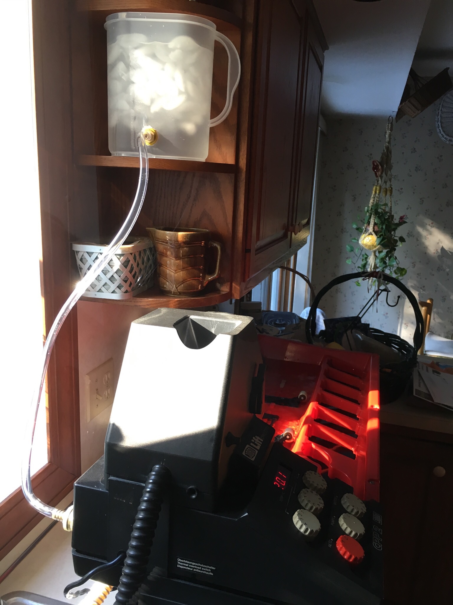

So I built this ice water tank for the JOBO on a hot day to keep the temp at the proper temperature.
I built a better one and don't need this one. I can either disable it and return the parts to Home Depot and throw out the tank, or sell it to someone whose not as handy as me.
It works great, it's gravity fed, but I'm not even sure it needs to be, the solenoid inside the JOBO opens and closes as needed, there's not much pressure but probably keeping it slightly elevated above where the hookup is would be good enough, I only put it on the shelf because it fit best out of the way there.

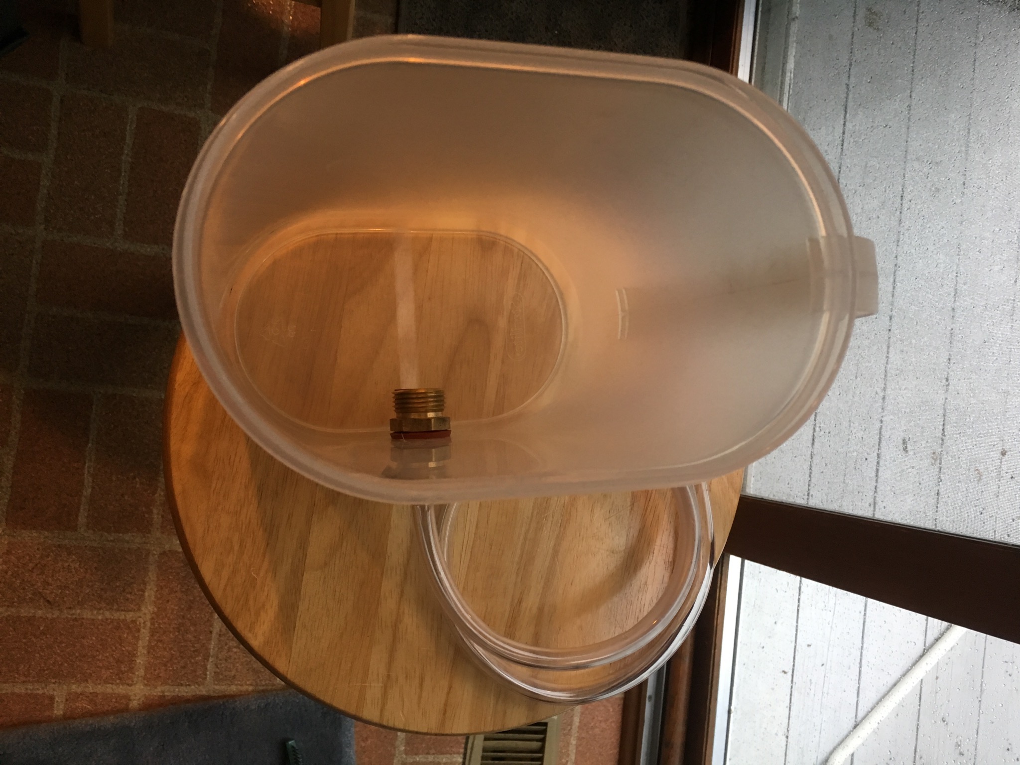

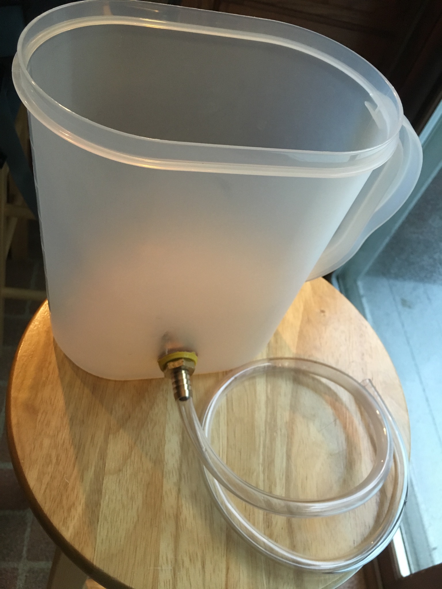

Here are 4 pictures, one of the setup and 2 of what you'll be getting in the mail

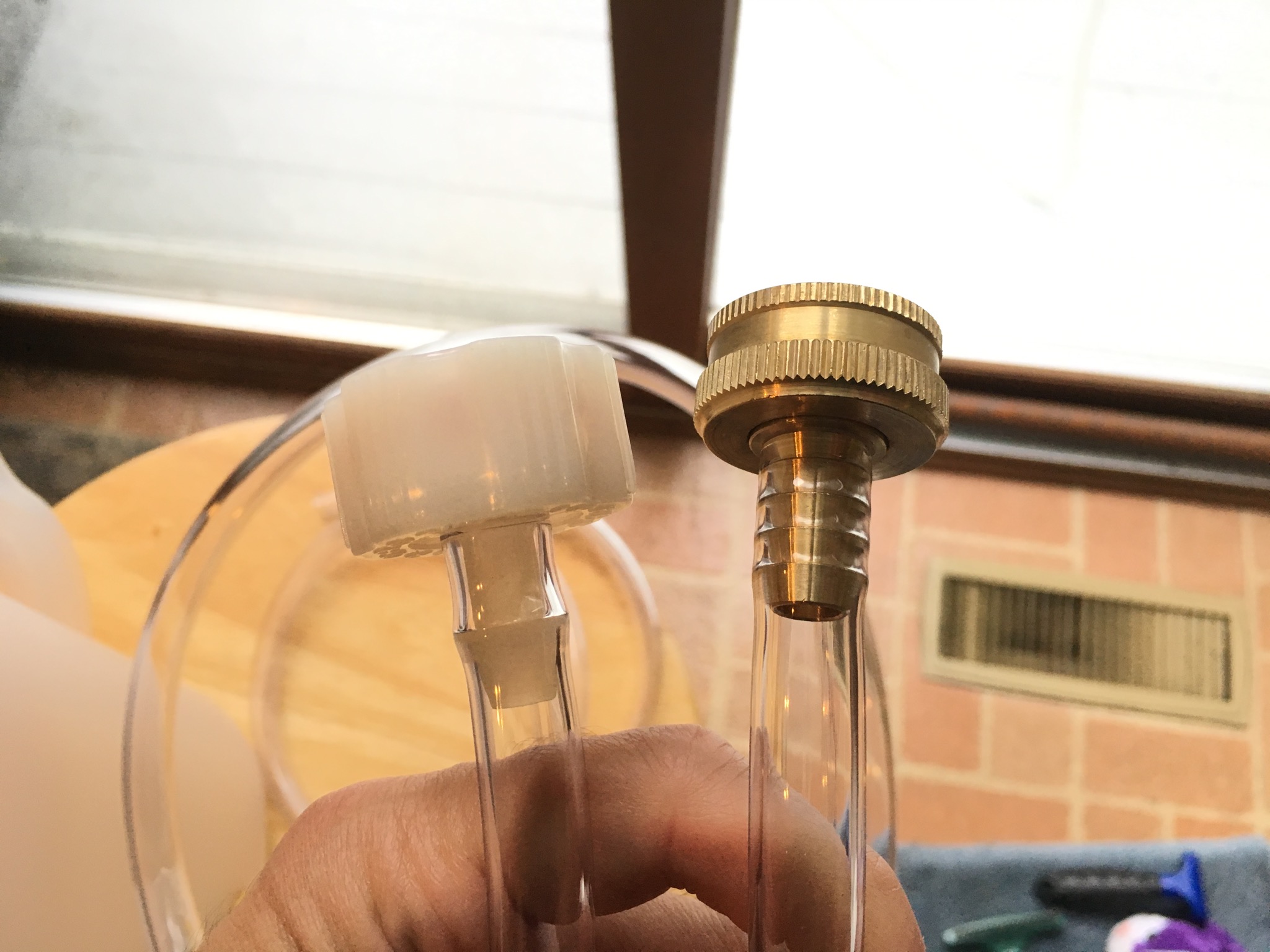

The only thing you'll need to get is a garden hose size end for attaching to the JOBO itself but that's cheap and easy to find at any Home Depot type store. The last picture are what they look like FOR REFERENCE, there are plastic and brass ones. They are called "3/4 in FH x 3/8 in ID" that's 3/4 for the garden hose size and 3/8 for the nub to go into the hose tube that's included.

Suffice to say 77 degrees in the house, 68 degrees in the processor's water because of this I was able to process 10 8x10 sheets and 6 rolls of 120 the other day.

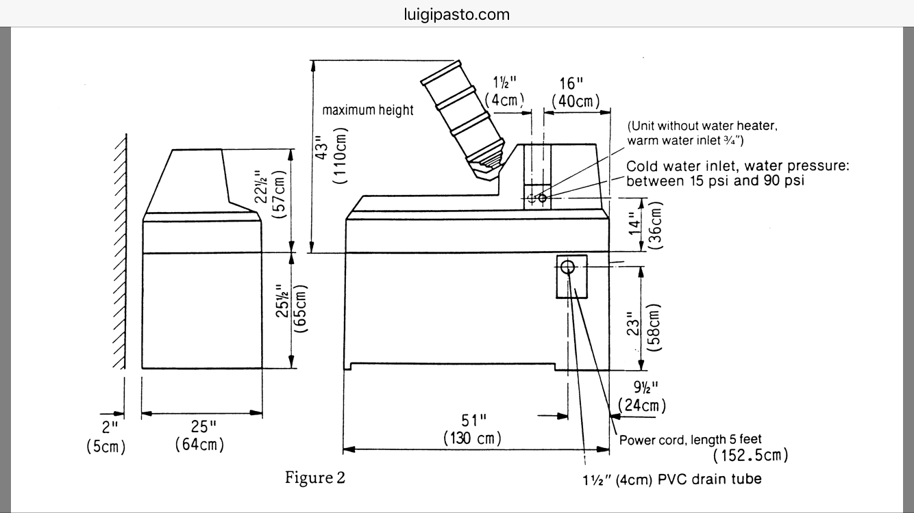

If I want to use my ATL-3 in the summer, I have to develop at a higher temperature and change the times accordingly. I wonder if this system would work with my machine I better check on the water pressure requirements, but I would love to have a chiller.
I believe it's the same as the CPP2 I have.
There should be a "male" plastic hoze screw on the back of the ATL3 that is the "cold water solenoid".
This screenshot from a quick look at the ATL3 manual shows a "cold water inlet" although I'm not sure it's the same thing, the ATL3 is more advanced than the CPP2 to my knowledge so should also have a cold water solenoid as part of the cold water inlet I would ASSUME.
The full manual is here...
http://luigipasto.com/files/documents/joboatl3manual.pdf
Hope that helps
There are three models of the ATL-3, with two of them having the same hot and cold supply connections. The third one has it's own water heater tank and only has a single supply connection, for cold water. IIRC, the two models without the built in heater are 110V and the other is 220V in the U.S. models. That may help you identify which you have.
