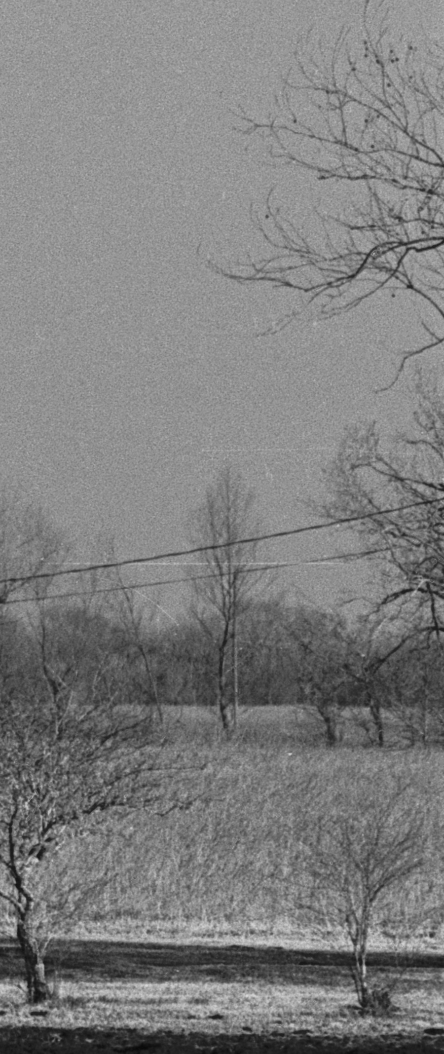

Hi Everyone, a couple of weeks ago I wrote about how pleased I was with a 35mm Super-Takumar lens I had recently bought on the Bay. Several people responded that they thought the 55mm f/1.8 Takumar was one of the better 50-55 lenses. That jogged my feeble memory and I looked in my boxes of negatives. In 1984, I tried some Kodak Technical Pan film with my wife's Spotmatic in Sugar Land, Texas. I exposed at ISO 25, used a big tripod to hold the camera, and stopped down 2 or 3 f-stops from maximum opening. I developed the Technical Pan in the specific Technidol developer (please ignore scratches and dirt). I scanned the negatives in my Plustek 7600i scanner at 7200 dpi (which, I have read, really is about 4800 dpi). Regardless, it is a big TIFF file. The first picture below is a farm taken with the 55mm Super-Takumar, resized to 1600 pixels wide. Then two sections from the full size frame show detail. This isn't a scientific test by any means, but it shows how much detail was captured in the film with that wonderful 55mm f/1.8 lens. Finally, the last picture is a historic 1927 Southern Pacific depot neat the former Imperial Sugar plant, taken with a 28mm SMC Takumar. The depot has been moved and now serves as home for the Chamber of Commerce. After that, I only used Technical Pan once again, in Greece - another project to scan.

I doubt that scans from 35mm Tech Pan or Kb14 really do much justice once you start looking at the fine detail.

Wow. love the tonal gradation of Tech Pan in Technidol. I tried Tech Pan in the early '80s when I was living in NZ and was stumped for which developer to use, (no advice on internet - had to go with advice from photo mags of which I bought a lot). Ended up using Patterson Acutol but in bright Kiwi sunlight I found the contrast was way too high and switched to Patterson Aculux which was a bit more manageable at the printing stage.
What is undeniable though is the fine grain of this film and with various Canon FD lenses I got some very detailed pics but not with your gorgeous range of tones. This was about the time that Tmax 100 came onto our market and I switched to this for my fine grained film.
Ian
That is so true. I was so impressed with the results I was getting from my SMC Pentax 50mm f4 macro lens but didn't really know just how good it is until I tested it using Kodak Techpan shot @ ISO25 processed in Technidol. The left side bottom shows the center section scanned and shown. Above it are the 100% crops of scans using Pentax K20D (14.5MP), above it a 4000dpi scan from my Coolscan and above it a scan with a Nikon D800 (36MP). Notice that even though the D800 has more pixels than a Coolscan, the results are practically equal. To the right, I optically magnified the same section and you can see just how much more actual detail was not resolved.
Full res version-> http://www.fototime.com/8372250EA44CB06/orig.jpg
Of course I am still not sure if this lens could have performed better had it been factory new. But I do know that it will not be the reason for loss of detail.
