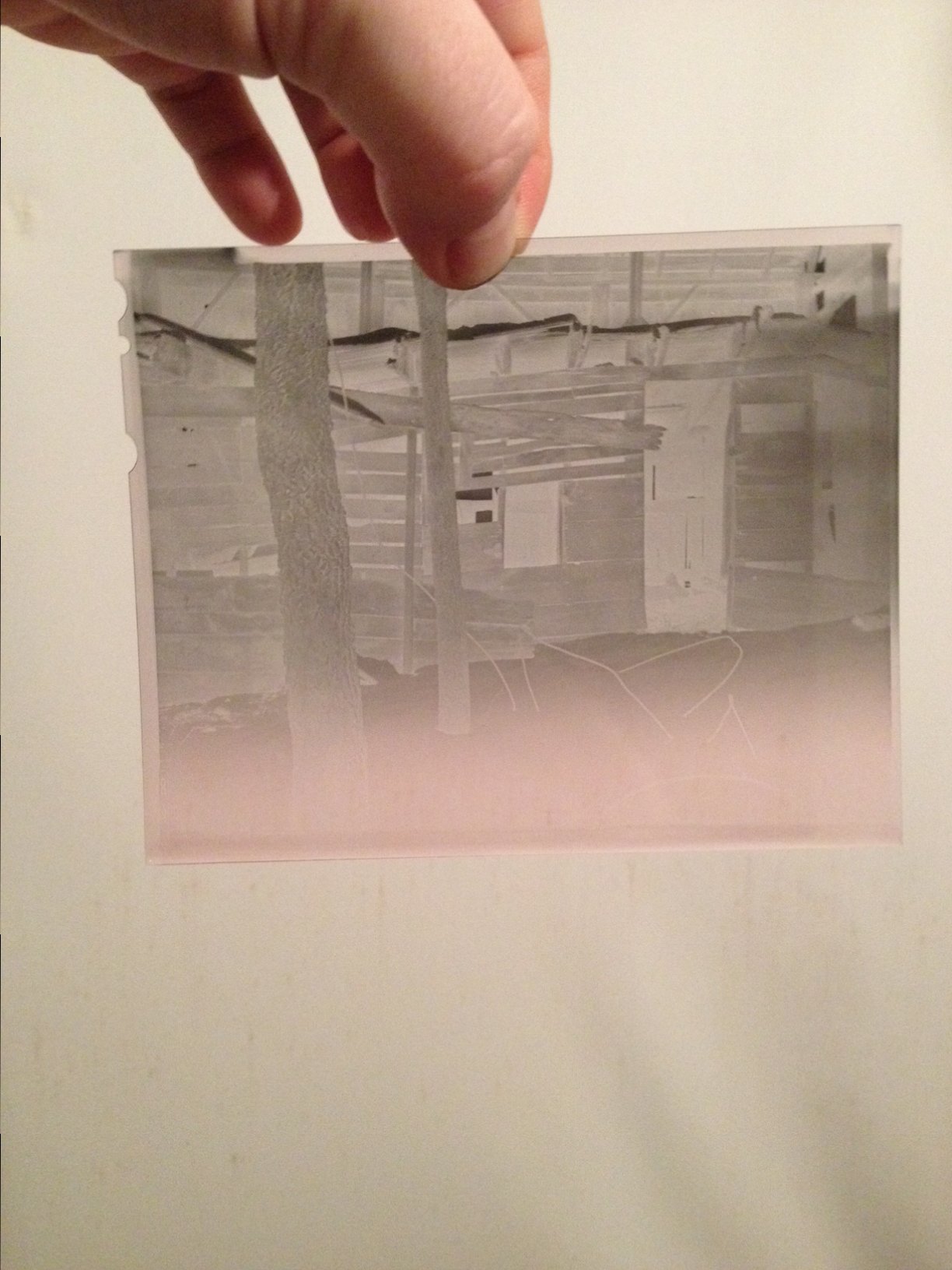

Would anyone be willing to help me diagnose what went wrong here?
This is HP5+ stand developed 54 mins in homebrew FX-2, rinsed twice with water, fixed in TF5 for 10 minutes, using a Fedco tank.
I've used all the chemistry to successfully process other films tonight so I'm at a loss. The negative is still in the rinse as I write this.
Any help is appreciated.

ps. the problem is the pink remaining on one side.
Looks like the film hasn't been fully immersed in the developer and fixer, in some tanks the spiral rises up the column and then isn't fully submerged. Paterson and Jobo use locking rings to ensure this doesn't happen, often these don't get used.
It looks like something like that has occurred, you need to check your tank.

Even so, whether OP used a tank or not, it looks like the pink side of the film didn't see enough developer, and then not enough fixer, because some of the built-in dyes are still visible.

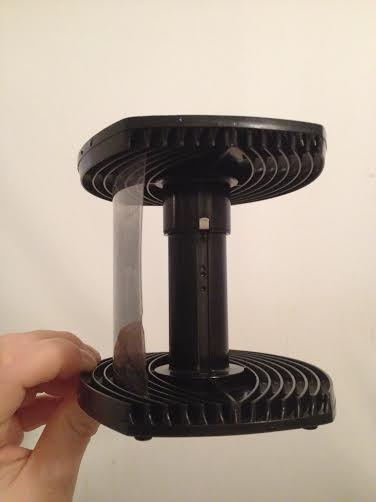

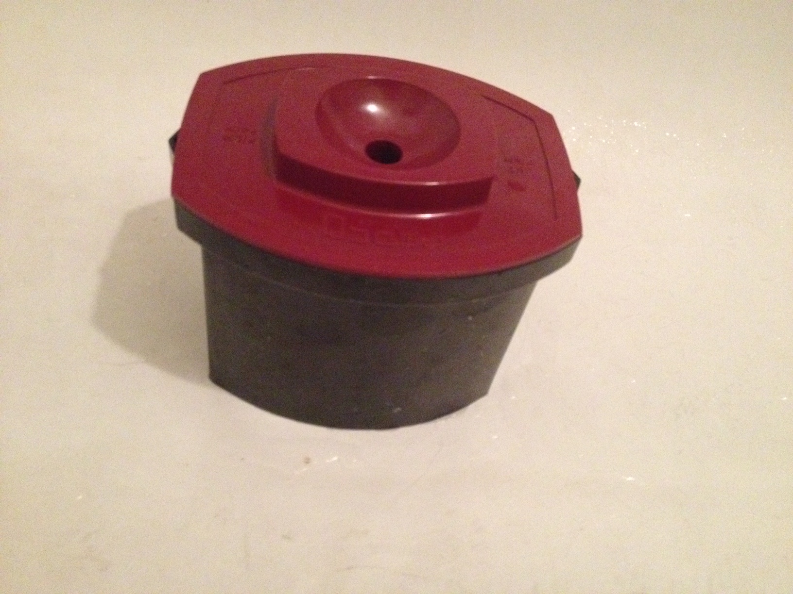

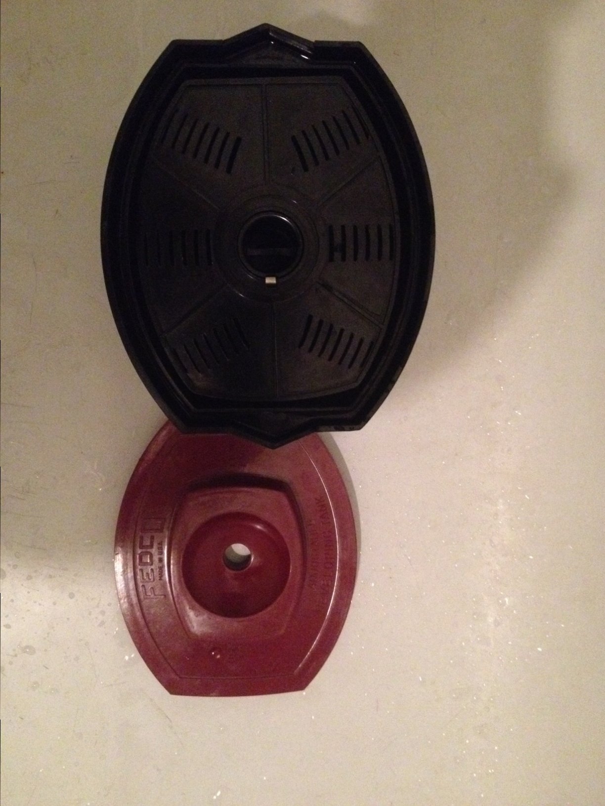

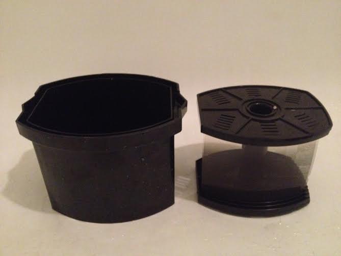

Ian, I think you're correct that it's the tank but I can't deduce the why.
I've been stand developing using a daylight tank with hangers. After much practice and waste effort, this is a process that now works fine. But the daylight tank will not work fine for normal development because agitating causes surge marks through the hangers.
So I stand developed using this Fedco sheet-film tank which DOES use a sort of spiral, or what I think of as a spiral. The end goal is to get comfortable enough using this tank for normal development (a la agitation). It holds up to 12 sheets of film and is adjustable up to 4x5.
I've attached pictures to illustrate.
Prior to souping the film, I ran a few tests to determine 1) how much solution is needed to fill the tank to the top so that it covers the entire spiral but doesn't spill over (Answer: 1.5L); and 2) in which direction to place the film (Answer: emulsion side out; emulsion side in gives uneven development around the edges). I practiced loading and unloading several times in the light.
So the current problem is that I filled the tank with 1.5L of developer and 1.5L of fixer. So I don't understand how 1/4 of the frame could not have been submersed in one or both. Maybe I'm going crazy? It's such a clean line demarcating the problem area that this result would make sense if I had only added, say, 1L of developer instead of 1.5L.
But I did not! Unless I am in fact going mad and can't measure.

For anyone interested, I solved the mystery. Ian, thomas, others, were all right. The fluid wasn't covering the film—but not because there wasn't enough in the tank.
I had placed the tank in the bathtub for the duration of development, near one side of the tub where it begins to slope.
The tank leaned enough to drag the fluid level down on one side of it (unfortunately, the side where my film was) ... hence the clean demarcation.
