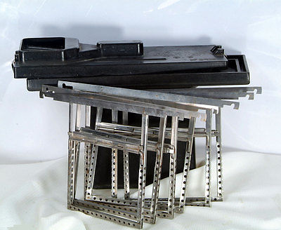

Second, do you use a daylight tank to develop?
I have an old bakelite one that will do up to six films in a quart of solution. I like it for its economy.
My first two batches of two films each, were evenly developed. I used an agitation method of gently tilting it to each side, two times each direction, each minute.
Is this the correct way to agitate?
The last time I developed, I just shook it and got very uneven development, more developed in the center of each negative than on the edges.

Wow. Your kitty is amazing. Glad you like Ted Forbes. As for film processing, I started out with 4x5 trays and shuffled the stacks. I learned this technique in Ansel Adams book The Negative. It takes practice and I got scratches once in a a while. I also use a Yankee Agitank and they're ok. For 8x10, I use a tray and process a sheet at a time. I shoot Fuji 8x10 HRT X-ray film which I process under a safelight. I have a friend that has great success with a 4x5 Combi PlanT tank. http://www.freestylephoto.biz/459809-HP-Combi-Plan-T-4x5-Film-Developing-Tank-with-Lid
All daylight tanks require practice loading. Good luck with your LF journey! APUGers are the best.

I've been using HP CombiPlan T, too, for some 14 years. It does 6 sheets in 1 l of solution, daylight.
I get even development (checked with my densitometer), ease of use, and hardly ever at all a slipped sheet. My agitation is fairly robust, with 3 full inversions with a twist over a span of 5 seconds, every 30 seconds. I've published curves for my two recent film/dev combos on APUG.

Jobo 2509 4x5 sheet film reels. I use Besseler Color tubes for my 5x7 (2 each) and 8x10 (1 each) developing. Use a roller unit for consistent processing on those. I use the Jobo like a regular film tank (timed inversion).
Smaller films are done in nylon screen tubes in a patterson series 4 tank.

I like your tank. Never seen one before. Normally, the film hangers are used with open hard rubber tanks in the dark. Done that before and it's not fun. But your metal hangers are really easy to load. Glad you're getting good results. Be consistent.

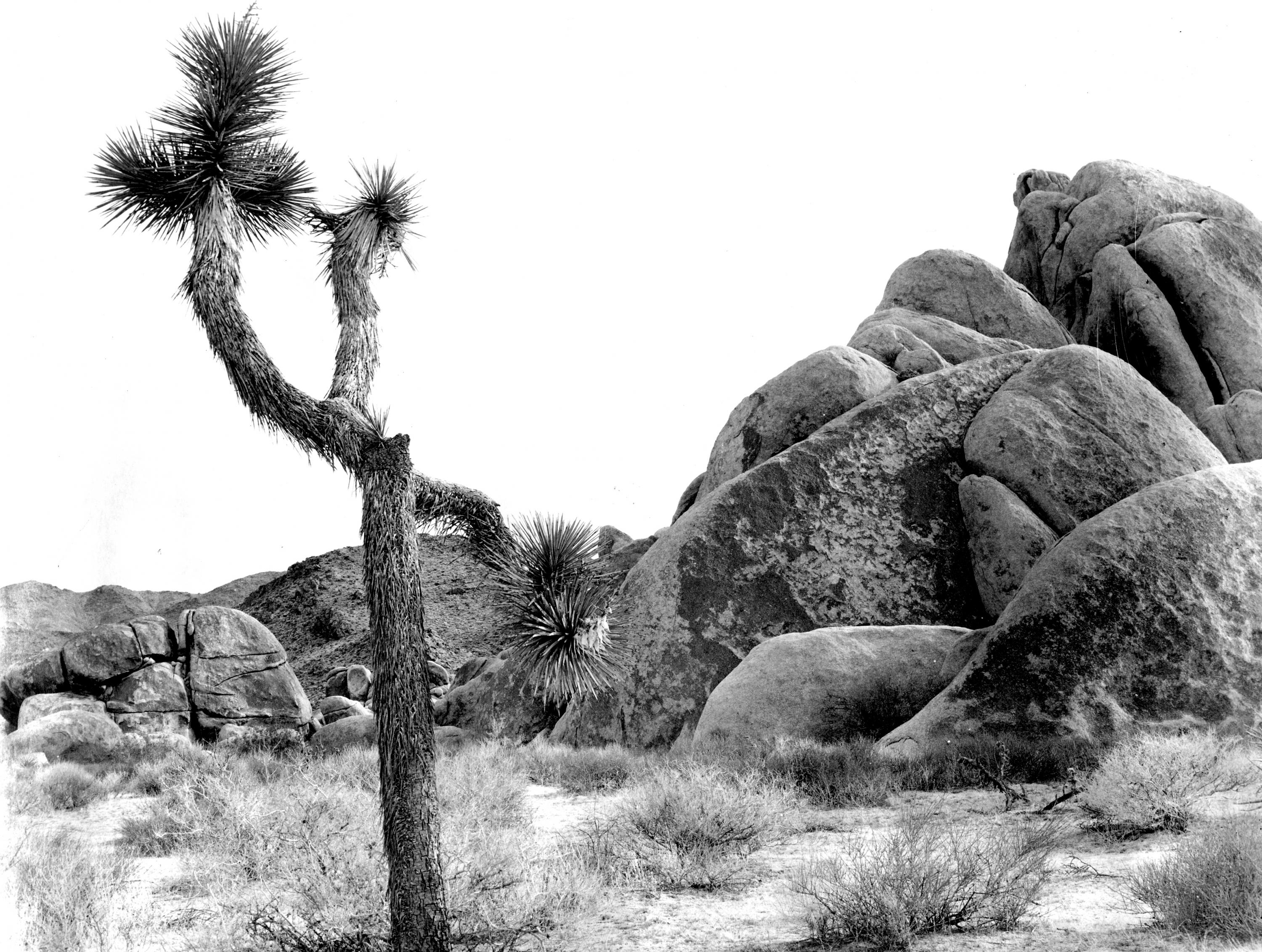

Just a quick print of what I think is my first "successful 4x5 negative"
I have a few more from this batch that are successful but I haven't printed them yet.
HP5+ / TFX-2 stand / Y-G filter / expired Brovira G-5 8x10 paper
Regular Rod
Aug 6, 2012
665
Derbyshire
Are you being careful when handling the film? There are some quite serious scratches on the right hand top quarter and what could be a rub mark on the left in the sky area. The dust is not a big problem. The black dust is from particles on the film when you made the exposure so maybe the dark slide and the interior of the camera need a clean. The white dust is from dust on the developed negative when you were making the print or scanning. An anti-static brush can be a help as can a careful blast from a compressed gas duster.

Good job!
Joshua Tree Nat'l Park
I've had scratches on my film when I first got started. Probably from loading or processing the film. As for loading film, I use a paint brush to clean my film holders. I'm too cheap to buy those compressed gas dusters. But an Igloo ice chest to store your film holders. I have a couple of those lunch box sized ones. I get them from the thrift store from about $5 each. Keep the inside of your cooler clean and your film holders will be clean too.
