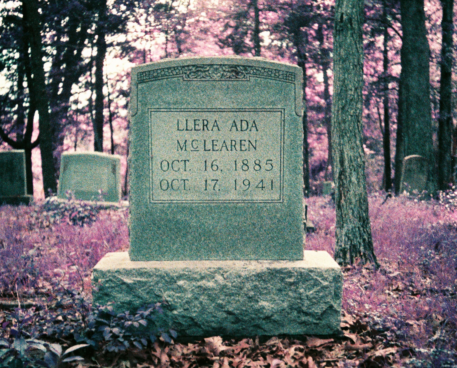

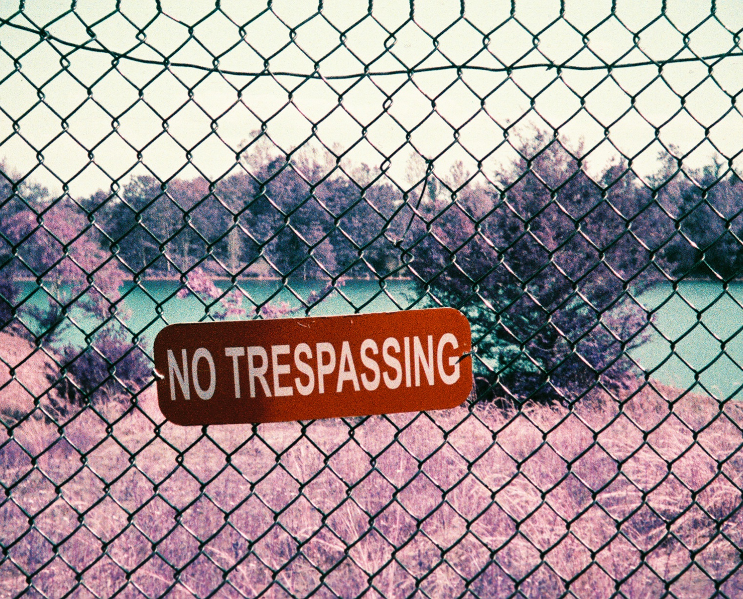

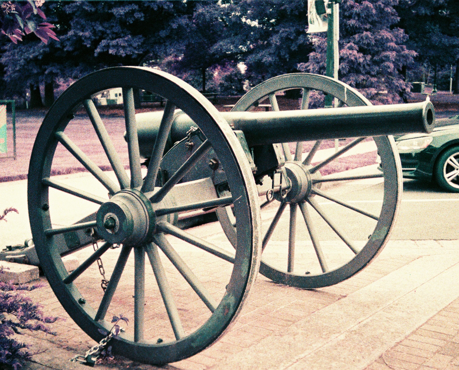

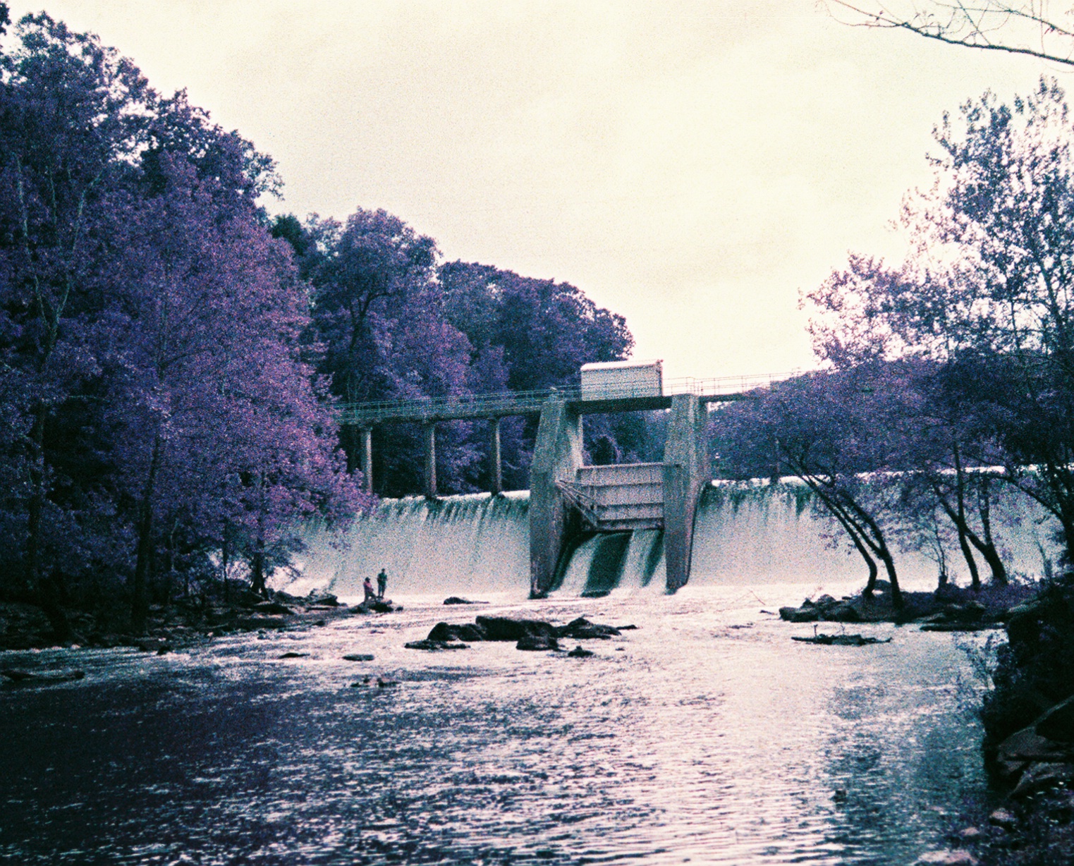

So, I finally finished a roll in the A110 and got it developed. I shot Lomo Purple. Nothing specific, just random shots around my area to get a feel for the camera and confirm functionality. I think the Purple makes for some interesting shots in 110. Now that functionality is confirmed, I'm letting the battery sit in the camera for a few days to gauge the voltage drop. The battery measured at 5.6v yesterday, we'll see what it's at Sunday.
Enjoying the camera, thanks @Huss!
Cannon in Old Towne:
Dam fishermen:
Old cemetery in the woods (that's one of fresher burials there):
No Trespassing (local quarry):
