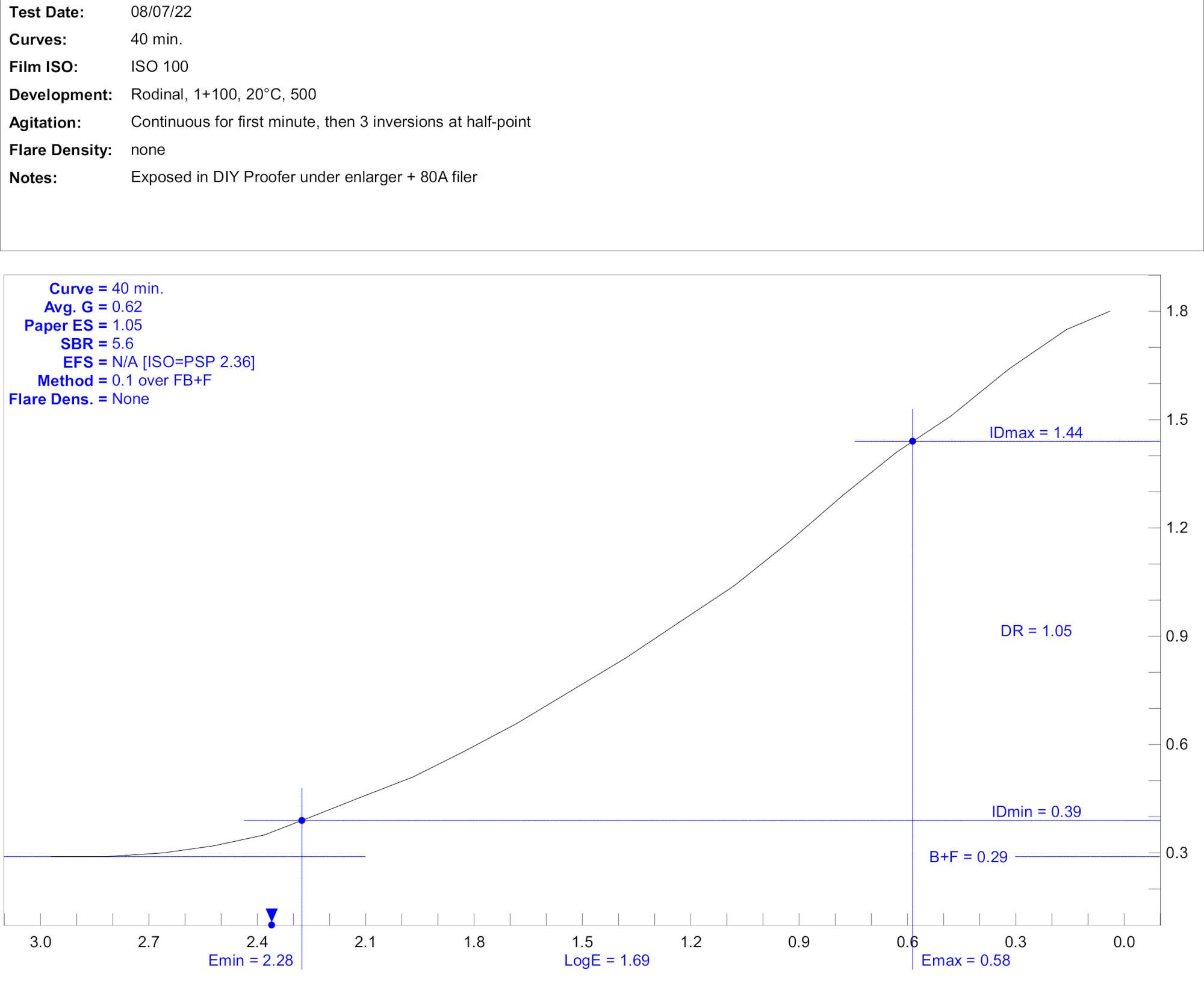

I know it's an old thread, but I thought I'd share my experiences with FP4 Plus and Rodinal. I have chosen a semi-stand development for negatives that need nice tonality and a bit of extra contrast. I use Rollei R09 One shot at a 1+100 dilution at 20C for 40 minutes. By the way, I recently tested the Rollei R09 One Shot against Adox Rodinal, and they give virtually identical results for this technique. I agitate continuously for the first minute and then three inversions at half-point. I find that the initial agitation is crucial to getting even development with this technique. The curve below shows the results of this kind of development.
