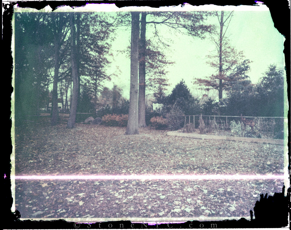

So I've been meaning to experiment with that whole bleaching the negative of the peel apart films to get a B&W negative to scan.
I didn't have the gelatin bleach that everyone talks about but I had normal liquid clorox bleach, so I used that, I coated the back side to take off the black backing, and washed the negative, I decided to scrape off the edge where some of the paper was still suck, and scratched some of the emulsion, so I figured I would do it all around just to give it an interesting look, and then I noticed that it seemed like there were 2 layers, a thick purple, and a lighter purple layer, so I scratched the corner to see if the lighter purple had any image information on it, it doesn't appear to, so I didn't scratch further.
The pink line across the image is just refraction from the ANR glass i had put on top to keep it flat, I don't have a 4x5 ANR glass piece yet unfortunately...
Anyway I was told specifically that the image would come out as a B&W negative, and that color couldn't be made from these, but to me the image looked like it had color in it, so I scanned it in color and definitely there are colors... so I wanted to share.
I did have to dial in the tones, but mostly because the ANR pink refraction caused the auto-color settings to go haywire... cut I didn't add color, simply took it to the beat white balance I could given the film itself is pretty dense with a very pink mask (the term mask could be wrong but I mean as in a base color layer that is all pink, like a Color Negative has an orange base color).
Have a look.
And a crop to show some of the colors...
Now a few points about this image, for one, this was dusk, it was a 15 SECOND exposure at f/16 with my toyo45a. I was GOING to shoot a sheet of Provia100f after this, so this was a test image, but decided the scene was lame, and also the sky had lost it's colors. (yes I know you can do even longer exposures to get the sky to be even more colorful but at the time I was going for a balance of the scene and sky, by the time the test was done and checked, the land was too dark, and a properly exposed sky would have only given a silhouette of the treeline).
The point in telling you all that, is that, it's possible MORE color might pop on a scene that is more intense, this one was very bland, dim, even, non-contrasty light scene, which would have been fine for maybe Velvia50 to saturate the color over time, but not for the fuji stuff.
Anyway when I have more time I'll try with a negative that's more colorful if I can find one.
Just looking for thoughts etc. and wanted to share.

Ned, the B&W ones are FP3000B ... that's three thousand. And I'm told you couldn't do this method with those, not sure why yet but I'm going to try, however I suspect it's because the negative gets totally burnt out from trying to expose at such a high ASA...
Bethe, I could have sworn you were the one who said that the color ones' negative was going to end up B&W ... but perhaps that was a misunderstanding and you were saying that you could only PRINT them in B&W because the color was too hard to print?
Curious what the negatives that I over or under exposed would look like, this one was done at the proper exposure (relatively) and seemed to scan OK after some tweaking though, my scanner software always auto-does it and with anything that's abnormal (like the pink streak from light refraction off the ANR glass) it totally throws it off. This was fun!

OK that stupid pink line was driving me crazy, so I opened up phtoshop for the first time in ... oh God .... 8 months? and then had to figure out all over again how to do anything... and I got rid of the pink line.... poorly at that... hah! and now the blurriness bugs me, but at least the pink isn't there...
