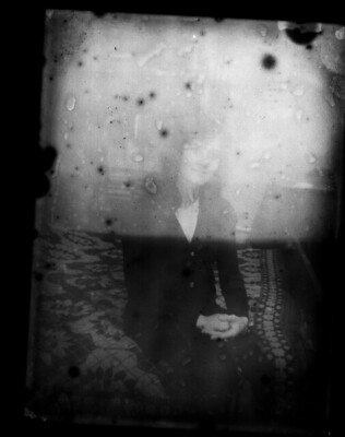

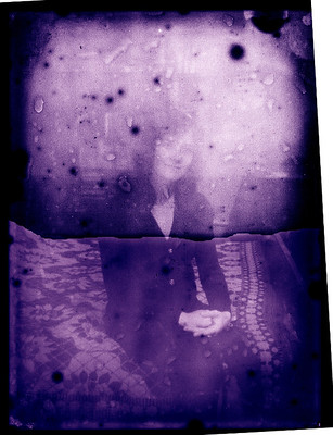

About five years ago I was working with a sheet of film I found in an old Soviet Fotokor camera. I got this image, with apparent moisture damage and possibly a lightstrike from a dark slide being pulled back. I played with scanning in color mode (as I recall--dimly) and crushing the warm tones, skewing the scan toward the blue end of the spectrum. That seemed to bring up some details in the subject's face and in the background. I stand developed in Rodinal simply because I had no idea what the film was. Today, I'd use HC-110.
Found in a Fotokor 3 by terry, on Flickr
Found in a Fotokor 8 by terry, on Flickr
It had an odd and seemingly self-contradictory effect. It increased contrast and reduced fogging in the upper half of the image and yet reduced contrast in the lower part. A friend told me to try this--I'd never have thought of it myself. Anyhow, it clarified the subject's face a bit, which was what I wanted to do. If I had better photoshop skills I could have cleaned it up a lot and maybe made it presentable.
