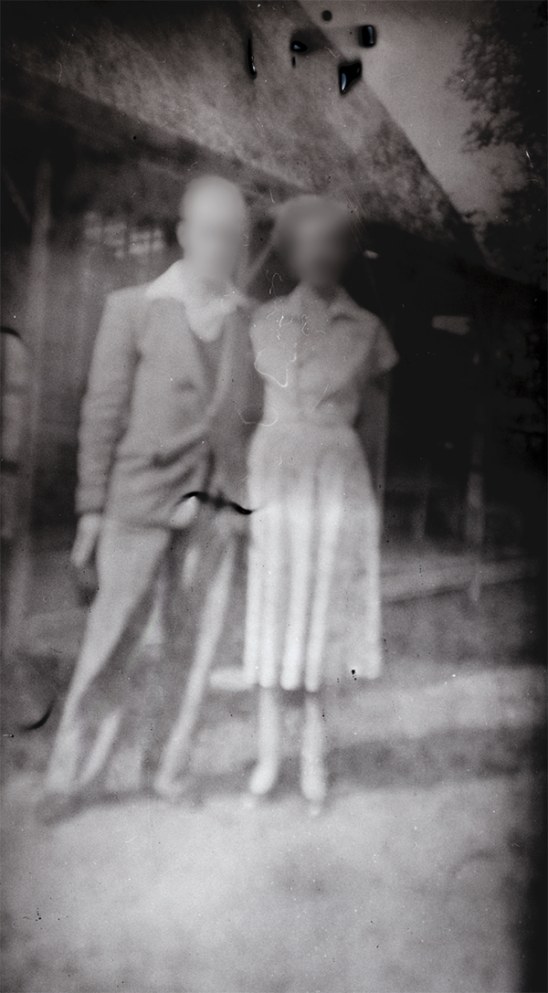

I have finally managed to attempt developing this old film. There are good news and bad news.
The good news is that it worked: there are indeed usable photos from what appears to be 1940 or thereabout. I was hoping something would show, but I was also skeptical about it so it was really a great surprise!
The bad news is that there are only two exposures (although the roll was fully wound when I've found the camera). I am not sure if indeed it was not exposed, or I somehow ruined it.
The film (or better the two shots) is now drying, maybe I'll be able to share these two negatives.
I can't hide that I genuinely felt a chill down my spine when the film came out after washing and I could recognize a man and a woman in what looked like a snapshot from a vacation. The image looks a bit soft, even for "older" cameras. But there is surprisingly very little fog and the image is clearly visible. The second photo is less clear, I can see a field with a black car and sheep.
I may have been a bit overenthusiast that night re-reading my words about the quality of that negative, it must have been the excitement :D
I did manage to scan that first frame from the roll, the only one that is clearly saved. We'll never know what happened to the rest: frames that were never shot, film ruined by decades of storage or simply my clumsiness with something so different.
So here is a negative scan of that first frame (I thought at bit about it and decided to crudely blur the faces of the man and the woman in the photo).
