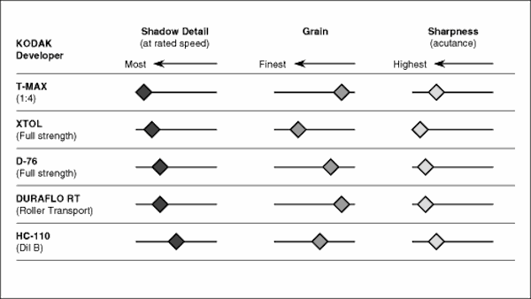

It's worth remembering Kodak's own developer comparison chart and then comparing D76 with Xtol:
