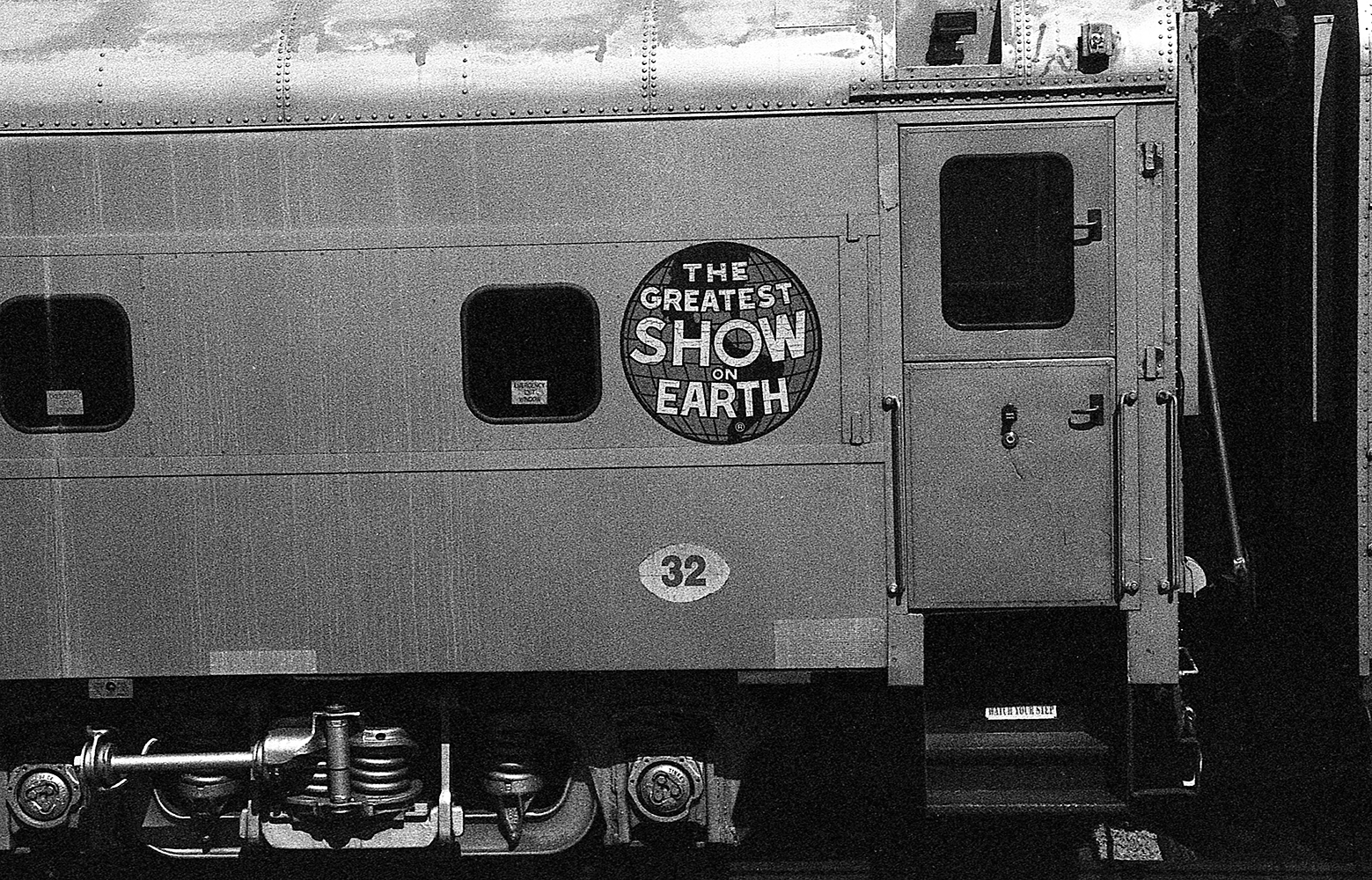

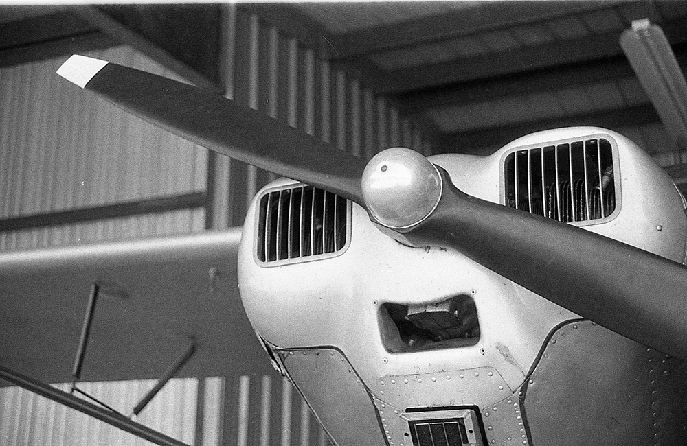

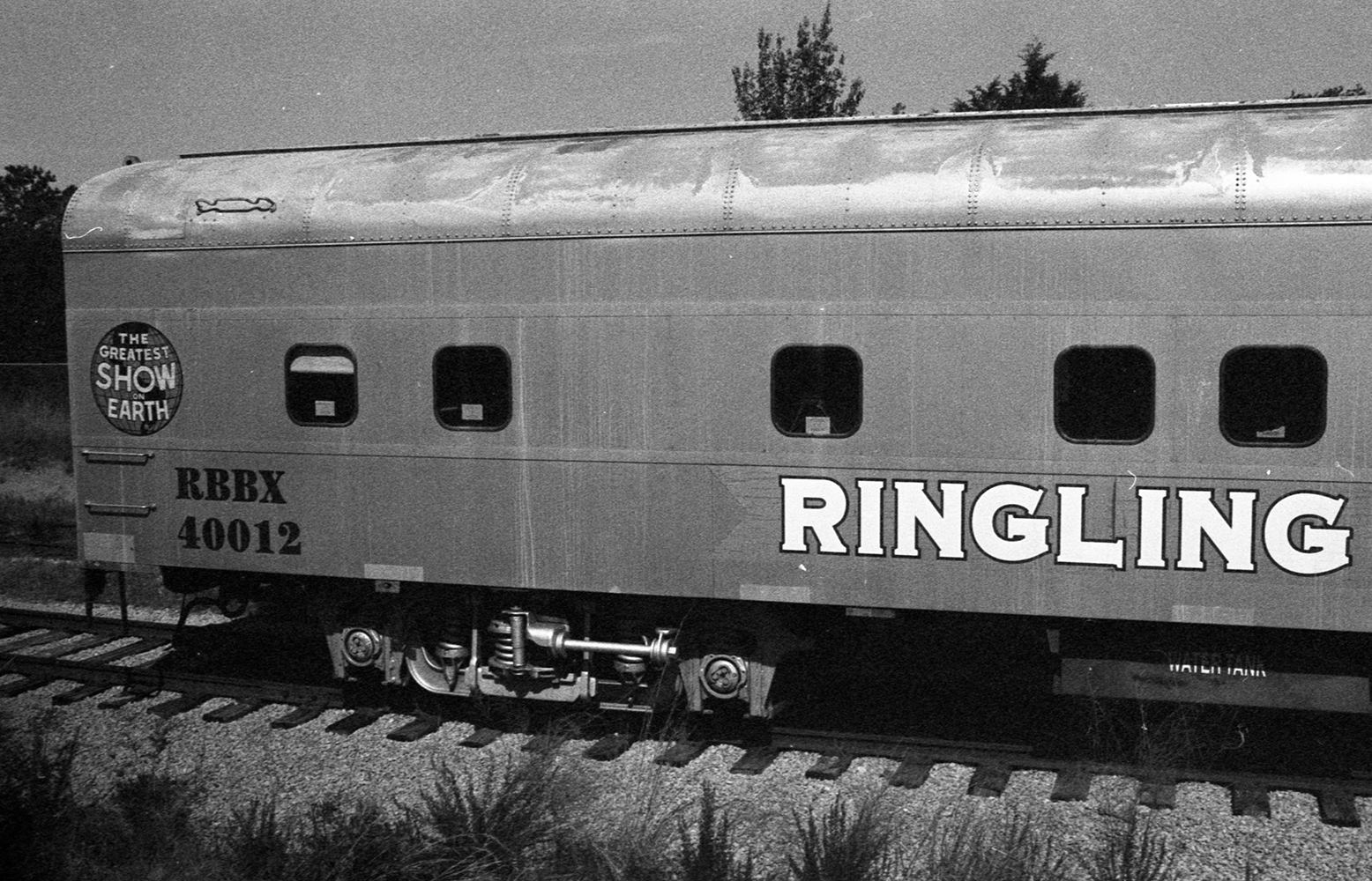

Congratulations! Though I didn't know the graininess was missing, what dilution and what film? I like the grain I get with Tri-X but not so much with Kentmere 400.
Film was Arista Edu 400 35mm, expired 2014, which I rated at 320. Processed in Rodinal 1:100 for 15 minutes. I’m sure I overdeveloped this roll and blew a few exposures as well. It was mainly to verify my “new” Nikkormat FTn is functional (it is!)
I’ve processed a couple of rolls of 100 ISO film (same 1:100 ratio) with less apparent grain, but this is the first roll of 35mm I’ve tried. I bought the Rodinal because it’s cheap! Lol. I’m planning to make some D-23 soon.
Reminds me of Tri-X in Microdol-X circa 1968. I think they look great! The Foma films may be the closest thing we have to the films like Super-XX, Ektapan, etc. Look at the sharpness!
Nikkormat and lens AOK.
The Arista 400 is inherently very grainy anyway. Rodinal only accentuated it. It wouldn't look that different in another developer.
Thanks, that's good to know. This was leftover film from my daughter's high school days. Don't think I'll be ordering more.
Thanks. I shot a lot of Tri-X and Plus-X in high school, 40-something years ago! Some of my RC prints from those days are still around my folks' house.
It’s now sold as Adonol.
Or in Canada, as Blazinal.
And from other sources, and in slightly different versions, as Rodinal, and under other name as as well.
I'm not a fan of fast film in Rodinal, but that looks very grainy even so. Also, your time of 15 mins at 1:100 seems short. Hard to say after the fact, if I was guessing I'd say hard agitation and/or warm developer is the cause.
An acutance developer like Rodinal does emphasise edge sharpness and grain. It can be controlled by increasing dilution and gentle agitation. I use it all the time with 100/125 ASA films rated at box speed or 64 ASA, and they're full of tonality and small grain. Of course appearance is always a matter of taste, so take my comments in that context.
Thanks for sharing your thoughts. I'm unable to pinpoint the exact cause, mainly because it's been MANY years since I processed my own film, and there are several variables at play. The solution was room temperature, no more than 70 degrees, but it could have been higher I suppose. (One day I'll get a thermometer!) I agitated 10 seconds every two minutes. Perhaps that's too much. 15 minutes at 1:100 has been fine for 100 ISO film (so far), but I'm pretty sure I used less frequent agitation.
I did not consult the mass dev chart for this roll until after the fact, and it recommended a full 60 minutes! I thought that was extreme, but it may be more accurate than I imagined. I'm in the middle of another Edu 400 roll, so I'll have to reconsider my approach for it. Both rolls expired in 2014, FWIW. As mentioned, the roll was mainly used to test the functionality of my FTn. Clearly I need more preparation and practice.
That's likely to be the problem!
I do 2 gentle inversions every 30 seconds. You're unlikely to be over-agitating.
12min 30 sec for me, so you're in the ballpark depending on exposure.
That would be stand or semi-stand development at 1:100 or 1:150. Basically you leave the film in the developer without agitation, except for a turn after half an hour to limit bromide drag. This gives a compensating effect, bringing out shadow and highlight detail to the max. It can give flatish tonality but is good with slow high contrast films, or for development on harder grades of paper.
Limit your variables and you'll soon nail exposure and development. Without a thermometer you could easily be 100% out on dev times, and introduce bags of grain and contrast. Keep it at 20oC/68f. Good luck!
I made an error recalling the Mass Dev Chart recommendations for Edu 400: it was 120 minutes at 1:100! It's semi-stand development. I may try this on the second roll. Nothing to lose, right?
