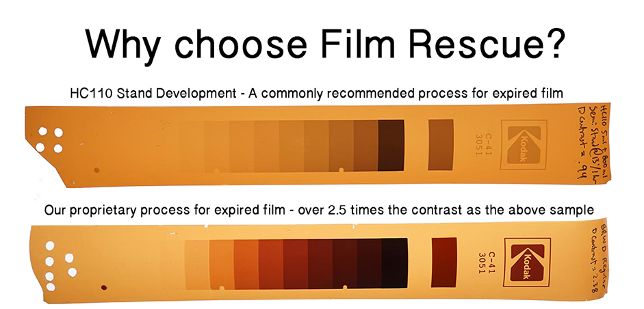

When I was starting out in film photography, I found some film in my grandfather's camera, and I took it to a lab for normal development (also Kodacolor C-41). I really regret it -- it came out totally blank. I wish I would have sent it to some place like Film Rescue International:
https://www.filmrescue.com/
I really think they have the best chance of getting something off of the film. Remember, if you do process it yourself and it doesn't turn out, you can't do it again!

Disclaimer: I have never personally used Film Rescue International since I have only ever "discovered" a single roll of old, unprocessed film and I was unaware of their service at that time. I have simply heard that their service is very good. They are based in a small town in my province, and I've been meaning to go pay them a visit for quite some time now.
What is their advantage? I don't believe that they have access to some obscure chemicals or something like that. They do have a lot of experience developing old films or films that have been stored in unfavourable conditions. With their experience, they can make a well informed guess as to how much restrainer to add to a developer, for example. They have 12 unique processes that they have developed and have shown to produce a reasonable image for different expired film stocks. They don't use standard C-41 processing. The process they choose is based on film type and age. They certainly seem to have the scanning and digital image processing chops to get the best possible image off the film (which could be difficult for a very thin negative), but their advantage comes from their experience in tested developing formulae for these old films. I don't know any of the specifics of their process, and I imagine such information would be proprietary. You can see here that at the very least they know how to do basic sensitometry and have a process yielding a better result than most home tinkering:
They are also conservative, and develop all films as B&W first to have the best possible chance of obtaining an image. As mentioned above, they also do film acceleration.
Could you do it at home? Yes, but if you only have a roll or two, you will be fooling around with tweaking developer formulae and use up all your film doing clip tests! I just say this from my own personal regret. I don't have any horse in the game -- anyone is welcome to do as they like. I just think that if you think there is any chance you will care about the images, Film Rescue's service is worth it.
If the film comes out blank, they don't charge anything, so they are motivated to get the best results possible. They have listed some serious clients (Smithsonian, LBJ Library, Jewish Holocaust Museum, etc.).
