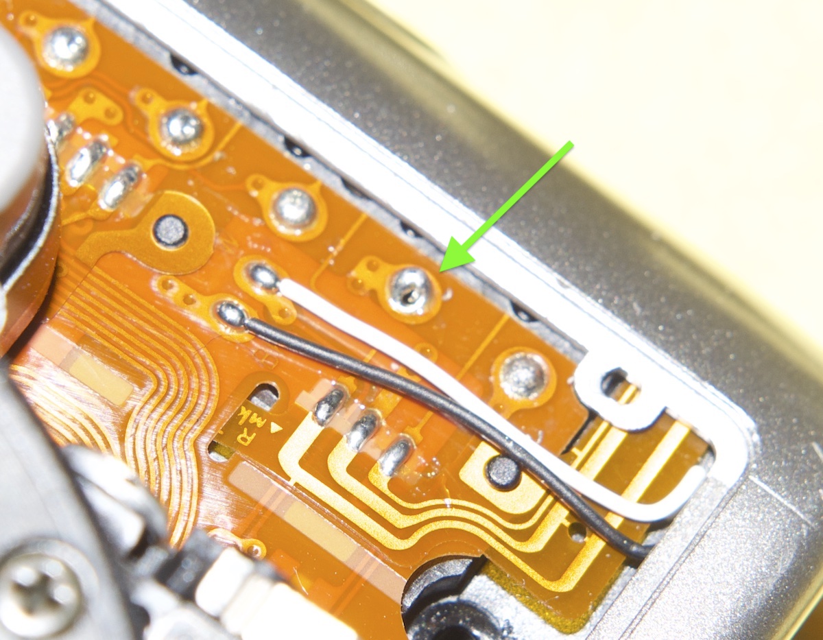

Older electronically controlled cameras (which are no longer serviceable due to lack of spare parts) have a reputation for being difficult to repair - if at all.
But often it is not the electronic components that break (excluding electrolytic capacitors) but rather contact problems or problems with the power supply, which can be remedied quite easily. If you find them and have access
Minolta note in their service manual for the X-500/570/300/370 that were on the market in the 80s and 90s:
Trouble is most unlikely to occur in electronic parts, such as ICs, diodes, transistors, resistors, and capacitors. Therefore, check the cause of trouble, with the focus on the defective soldering of lead wires and electrical parts, and switching contacts.
May it stay that way for the next few decades!

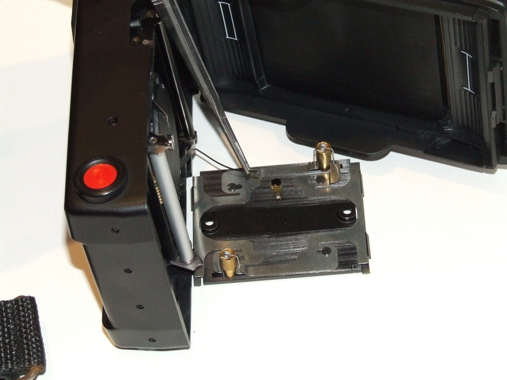

This little wire broke off the pressure plate of a Rolleiflex 6000 series. Without the wire, the motor would not stop after the film wound up to the takeup spool. Easy repair, but hard to find because it is hidden under the pressure plate.
