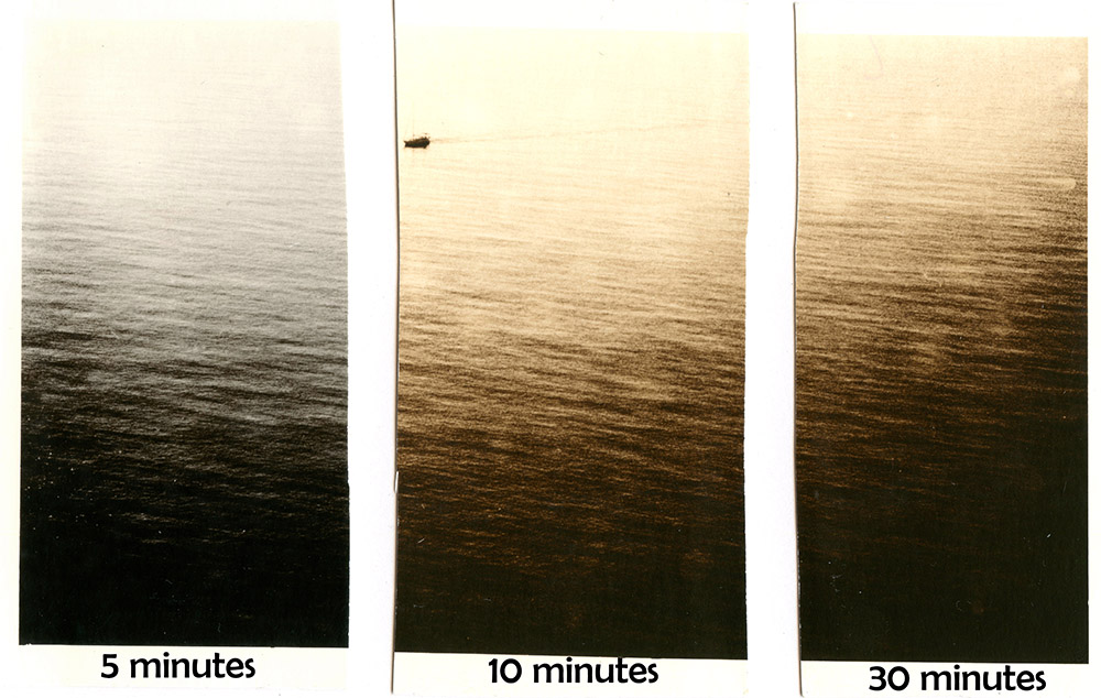

I already tried to leave a lith print a lot in selenium. In my case, got darker and colder in the first minutes, and after 5 minutes, turn to red-brown. But did not change to something else not even after 30 minutes..I will post some photos wen I scan them. If you want to see some lith prints of mine (since here is about toning) here I posted some without toner: https://www.facebook.com/andreifarcasanuphoto/?fref=ts

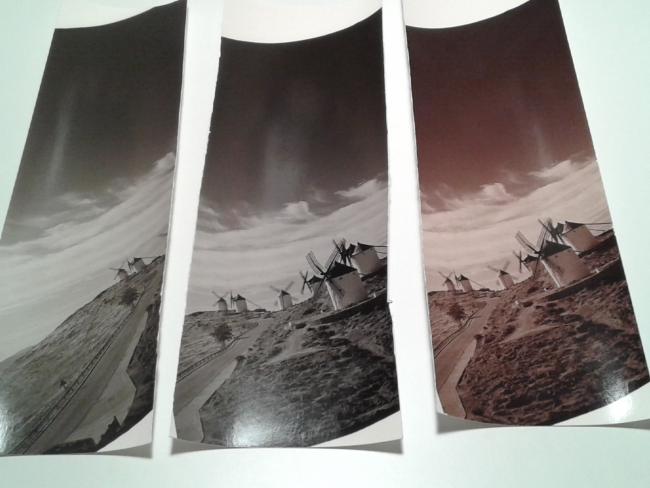

this is my test: lith print (was yelowish-brown) and after, toned with selenium, dilution 1+14
