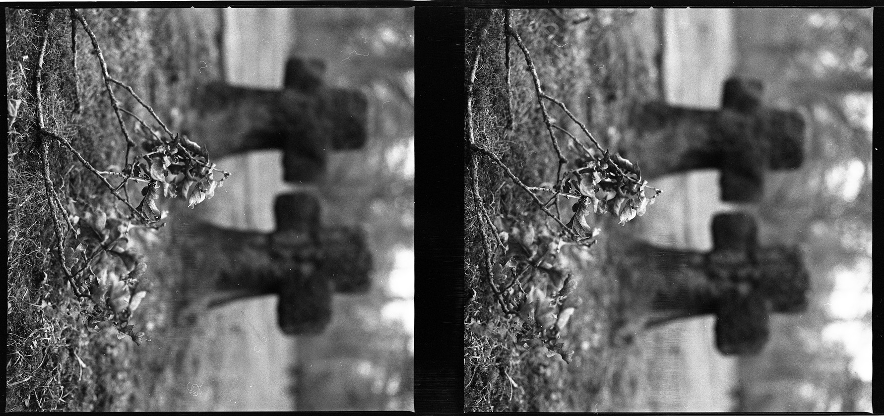

Let’s talk scratches again.
I finally got the time to scan two negatives clearly showing these d***d scratches.
As you can see they come in regular waves, transverse to the length of the film, about 1 to 1,5 cm long with in intermediate distant of about 3 cm, over the whole breadth of the film. It looks to me that the distance and the length is the same as the piece of tape used to stick the film on the backing paper.
Imagine the film rolled, then try to locate the tape, you can feel the tape due to the little thickness of the roll, so, you can locate tit. Well, the tape is on the very same location as you can see the scratches. There, were the tape is, the friction tension between the emulsion and the paper is the strongest. This can be motivated because there are scratches on the space in between the frames too.
What stroke me too, is that the scratches are getting more present towards the end of the film, what you see here, are the negatives number 8 and 9, numbers 1 and 2 are barely showing scratches .
The camera was a Hasselblad 500C/M and a recently (two weeks), by a factory recognised repairmen, CLA’ed A12 film back. The film is FOMAPAN 400, all tough the name exposed on the film is “ULTRA 400”.
This was the last time I shot FOMA…
Philippe

Dear Robert,
I do admire and respect your loyalty to the brand you trade!
In the 30 years I shoot with Hasselblad, only FOMAPAN (400) has shown this issue (see my latest post above). I shot all kinds and brands of film, I never struggled with this issue.
I do remember the Ektachrome Panther, who, in the beginning, was prone to pressure fog, but NOT in the Hasselblad, only in the Technorama, that’s all. To anticipate the issue due to the loading system, I had my film-backs CLA’d and trimmed (and paid for it), which apparently did not solve the problem. I did this because I liked the way FOMAPAN translated the subject in to an image, regardless the rather present grain whit witch I could live. Only the persistent issue of the scratches made me turn away from this emulsion.
One can hardly state that, knowing this, it is the behaviour of the customer that has to be changed instead of the product. Unless that this product is so exceptionally special that an even special handling and care is imposed.
I treated FOMAPAN the way I was used to do with all the other films, witch is, to my humble opinion, rather normal.
I refuse to blame the loading system of my camera which is, BTW, among the most professional ones. And if the camera is really to be blamed, then Victor Hasselblad could not design and build camera’s that can handle all the worlds films.
This concludes this case for me, it is up to Foma Bohemia now.
No hard feelings,
Philippe

- First, as Foma said, particles could be present between film and paper and provoke this marks. The presence of such particles in 35 mm cassettes, to my mind, could provoke marks aslo in 35 mm.
- Second, the backing paper is too rough and provoke, by itself, and in combination with a friction in the camera (so also depends on camera).
Another point: I received rollei films from a batch that was converted in Foma. Clearly, it was catastrophic ! Big scratches all along films. Rollei had to change the company that converts their films, and there are no problems now.
So, in conclusion, Foma MUST check all their converting process, and machines, and they MUST IMPROVE THEM.
I will write agin to Miss Hojna to tell that to her, now.
Aurelien,
French Foma Dealer.

No I don't think so, because this involve ONLY converting machinery. This is what we received:
"Let me inform you about production break scheduled for July 2010 - the break in the finishing dept.
we plan in term from 5. till the 26.7.2010.
At that time FOMA will install new environment friendly technology"
I think it only concerns the finishing and cnverting machinery for films,and especially the 120 converting machine, that is the point of our problem. I don't about 135.
I think they will stop the old Forte converting machine, which is THE actual problem, and go back to their own machine, with improvments.

Tout ceci pour vous confirmer que j'ai eu le même problème de micro rayures sur toute la surface du film.
le frottement du papier (trop abrasif) me semble la bonne explication aux vues de la finesse, la répartition, et la longueur de ces micros rayures.Il y a obligatoirement une différence de longueur parcourue entre le film et le papier dans un parcours en C et donc un déplacement relatif film/papier ( beaucoup moins dans un parcours en Z).
