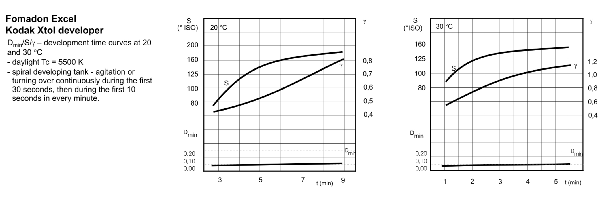

Could the 30 degrees be a typing error?
I know some people love this film in sheet sizes as it's usually a lot cheaper than the main manufacturers films.
No not a typo, they post 20 degree and 30 degree times for all their films. 100 reaches box speed (or more) at 20 degrees, but 200 only does at 30 degrees except in Microphen, and 400 never does. According to their own spec sheets. They are good films, just not quite the ISO posted on the box.
Here’s 200 in XTOL, from the spec sheet. ISO rating on the left, measured on top curve. Lower curve is density, numbered on the right. Base+fog on the bottom line.

These 2 graphs seem to show that at 20C the S curve gets close to ISO 200 but not quite and at 30C there is no 200 on the graph but it reaches ISO 160 Have I read these graphs wrongly?

That’s right: for XTOL. The rating is quite different with microphen.

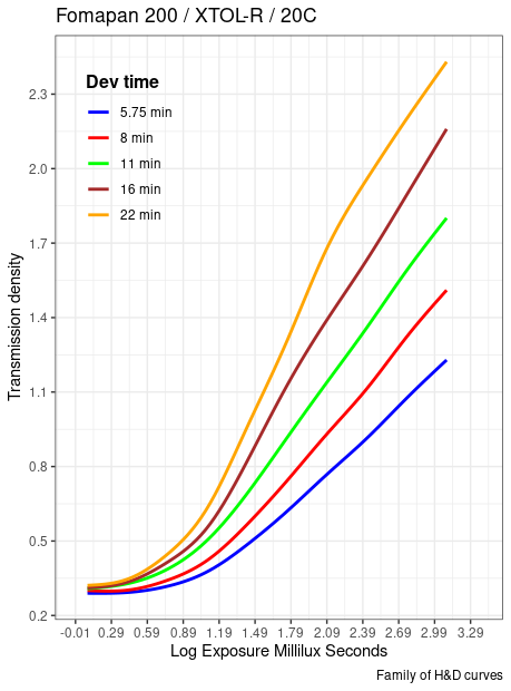

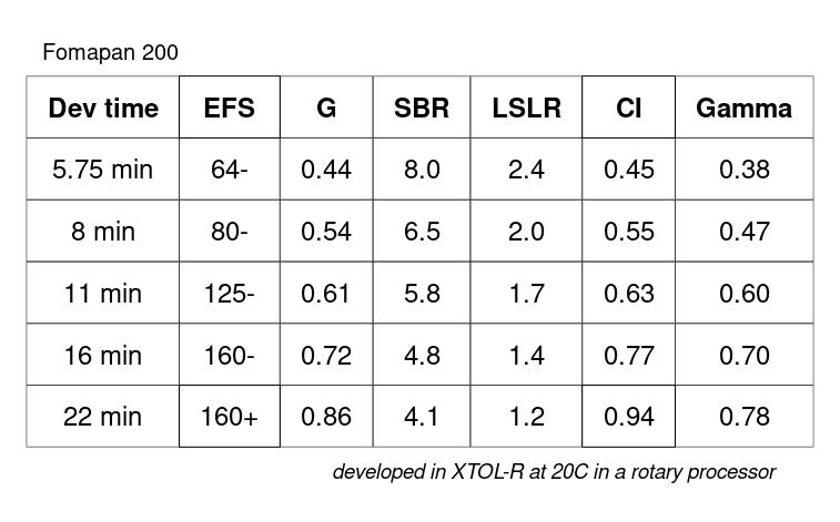

Here is a summary of my results. I am working on a larger analysis, but it will take me some time before it's complete.

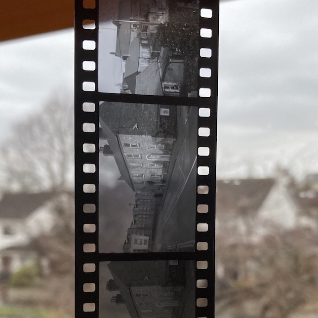

Hi everybody, for the sake of completeness I tried to reverse the entire Foma lineup, the 100, 200 and 400.
Maybe it's not relevant to this particular thread but what I've found is to my surprise that all of the Foma emulsion are equally good when reversed, particularly the 100. It's almost on par with the Fomapan R 100 specifically designed for b&w slides.

While I haven't tried it with 200 and 400, I once experimented a bit reversing Foma 100 and like you I found it worked quite well.
I used Fomapan 400 as my test dummy in reversal bleach testing when developing the peroxide/EDTA/Citric acid bleach I posted to the formulas on this site. Fomapan 400 reverses well. I can't speak for 200 or 100 but I believe @Tsubasa from what I've seen.

I don't mean to dispute anyone else's claims because I am not familiar with their process. If you look at the summary table, you can see that the Contrast Index can be easily manipulated with development, from around 0.45 all the way to 0.94, in XTOL-R, at least. I would guess that it would be similar with other general-purpose developers, such as D-76. So I would say that, yes, contrast will build up much like other pictorial films.

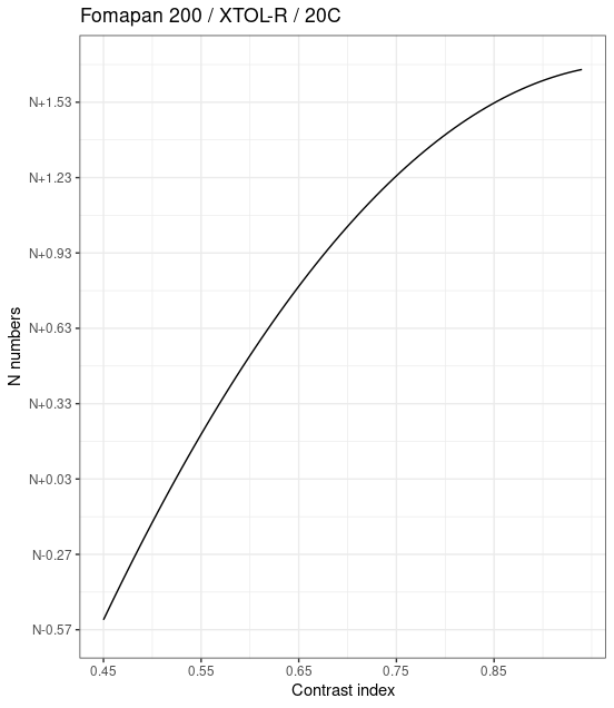

Here's a plot of N-development to CI (for a condenser enlarger), in which I am using the BTZS convention for establishing N-development, which should also be applicable to Zone System methodologies. Regardless of which convention we use, it's clear that contrast increases "normally" with increased development time with Fomapan 200. Click on the thumbnail for a larger view.
