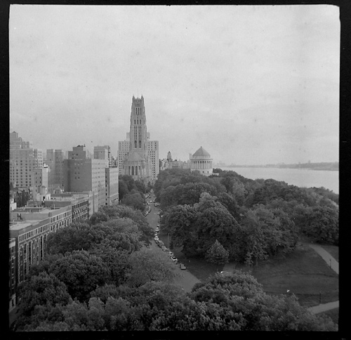

It doesn't look anything like Tri-X of any vintage. It is said to be a T-grain film, but it's fairly grainy. It looks like a film from the 1930s. Think of Alvin Langdon Coburn and films by Fritz Lang. Lots of action in the midtones rather than at the ends of the scale. I've processed it in D-76 (1+1), 8.5 min at 68 deg. F., agitating every minute. I think I'll test it in ABC pyro, which I've been using more an more lately.
One good thing about Foma rollfilms is that they don't seem to have been as prone to light leakage as some of the other East European 120 films.
Here's a test shot, which I think I took with the Voigtlander Perkeo II. It was a foggy day, so the "flat" quality (not necessarily in a bad sense) of the film is somewhat exaggerated.
