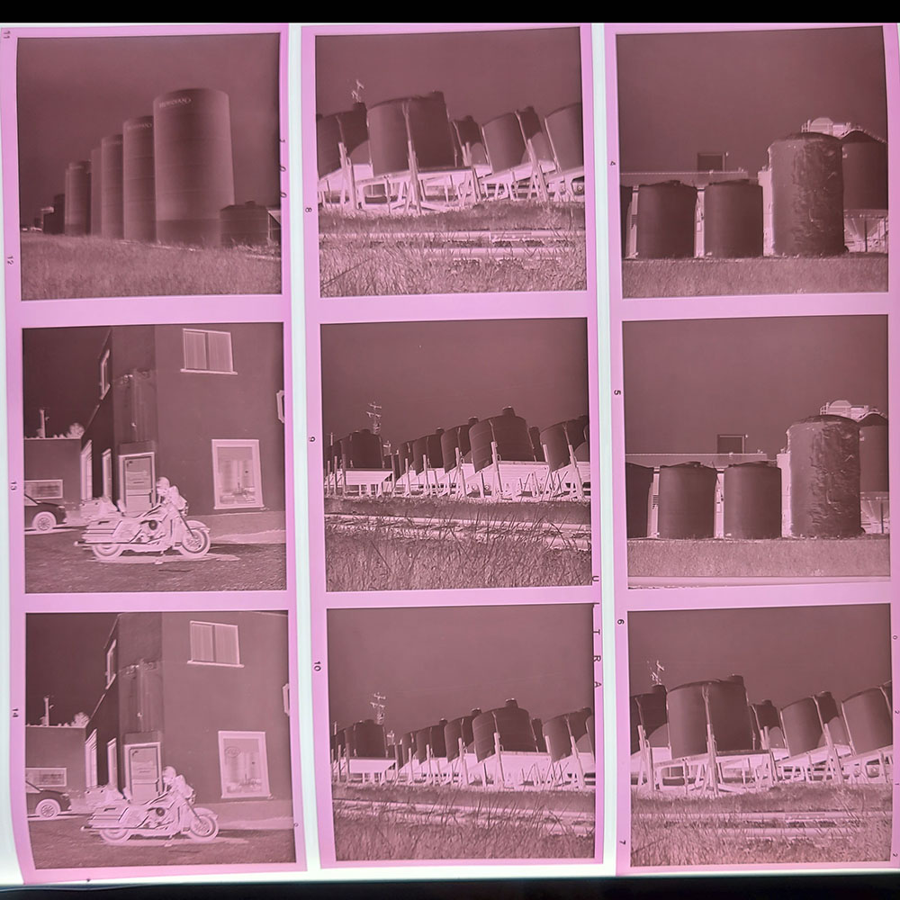

So I have been shooting Fomapan 100 for a few years now but recently changed to Fomapan 200 and I would suggest the Pyrocat may be what requires further investigation.
When I first saw this thread and the Magenta cast I immediately recognized something that has happened to me. To confirm I went though my archive of negs to see which ones have a magenta cast, according to my notes the only Foma 100 Negs I have with the cast are all developed in Pyrocat HD 1+1+100 for 10mins @20deg (curiously the volume isn't listed) in a Jobo CPE Plus. I have other negs developed in ID-11 and Fomadon Excel (Xtol clone) and all of these have the regular neutral base that I would expect. The Magenta ones still managed to be contact printed however it probably helps that I needed a high level of contrast adjustment for the images in this case, could be quite the problem if you are going for low key however I do not have an example of this.
Interestingly none of my Fomapan 200 images have this magenta cast even with the same process. What I suspect has happened in my case is I have done something wrong with the minimum amounts of pyro required as the strongest examples I can find for this are all on 4x5. As I switched to Fomapan 200 about a year ago I don't have any 100 around to do further testing with. I would suggest to anyone who is serious about getting to the bottom of this, start by trying to replicate with pyrocat and then seeing if you can replicate with another developer. If I would have to guess try going below minimum valuers of chemistry for the amount of film being developed however this is just a guess on my part.
I hope this can help and gets us a little closer to the truth.
Thanks! The next rolls I process will be with Rodinal. I might even cut one roll in half and do one in PyroCat-HD and the other in Rodinal.

Not sure if this will help at all, but I find that the anti halation dye in 120 Fomapan 100 is quite stubborn. It takes me 3 changes of water during pre soaking to get rid of most of it. I've decided to do this elaborate pre soak with this film just in case staining developers interact with the dye, as Pyrocat might have done for you...

The Foma 100 I have is not out of date. I processed it in PyroCat-HD 1:1:100 semi stand. Fixed in Ilford fixer for 5 minutes. Washed for 20 minutes. It also got a 3 minute pre soak. The negs as far as density etc look wonderful but the heavy magenta colour of the substrate will cause issues with split grade printing using a colour head. Generally you use full magenta for contrast and full yellow for highlights. Since this substate has so much magenta I will have to see how this will work out.
The film itself is very thin and curly and on the rebate is says Ultra 100.
See this image below.
I've had similar (ongoing) problems with TMY, but even worse. The solution (pun intended) was to soak the film in an alkaline solution for several minutes and then re-wash. Now I just add the alkaline soak before the wash. I've used sodium carbonate, sodium bicarbonate and the used developer as soaking solutions. All worked fine, it just took a little longer with the weaker solutions (bicarbonate).

Doremus - I get zero residual magenta dye stain with TMax films. It washes right out. I use alkaline TF4 developer.
