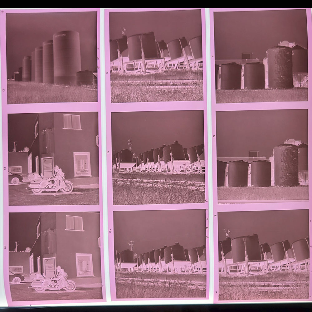

The Foma 100 I have is not out of date. I processed it in PyroCat-HD 1:1:100 semi stand. Fixed in Ilford fixer for 5 minutes. Washed for 20 minutes. It also got a 3 minute pre soak. The negs as far as density etc look wonderful but the heavy magenta colour of the substrate will cause issues with split grade printing using a colour head. Generally you use full magenta for contrast and full yellow for highlights. Since this substate has so much magenta I will have to see how this will work out.
The film itself is very thin and curly and on the rebate is says Ultra 100.
See this image below.
That looks nothing like any fomapan I've run through my hands. It looks more like the Kodak antihalation dye, except the edge marking does clearly show its fomapan.
That looks like some sort of massive overall stain (catechol can effectively behave as a coupler - after all that is all that the 'stain' image from staining developers is...). You might be able to de-mordant it somehow. It likely results from the exhaustion of some part of the pyrocat when used in the manner you claim.

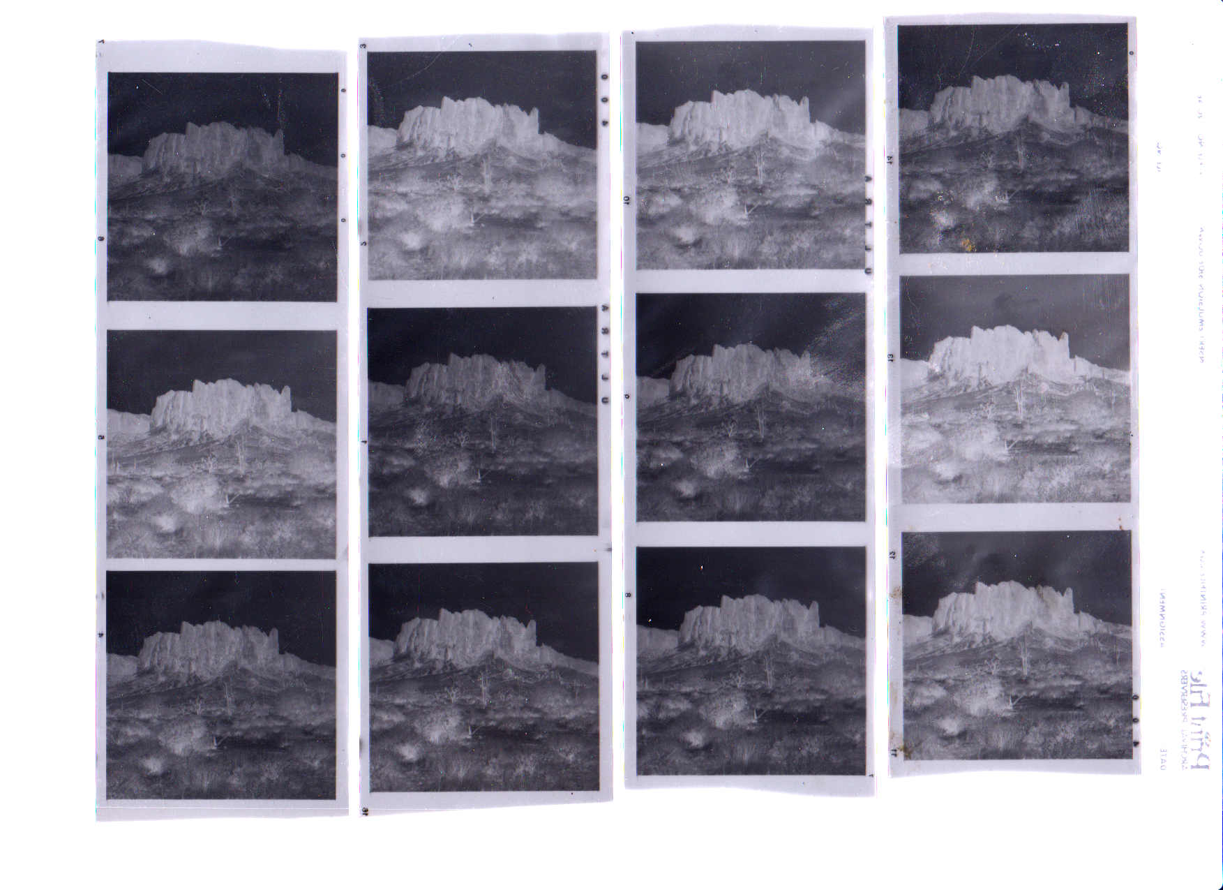

What I find odd it is my last roll of Ultrafine Extrem 400 is edged marked Ultra, my 35mm Ultrafine 400 is marked UL Tranfine exream 400, all my Foma is edged Marked Fomapan, well the 200 and 400, I have not shot any 100 in a very long time. Here is poor quailty scan of my last roll of Ultrafine. Sorry it is hard to see the edge marking.
What I find odd it is my last roll of Ultrafine Extrem 400 is edged marked Ultra, my 35mm Ultrafine 400 is marked UL Tranfine exream 400, all my Foma is edged Marked Fomapan, well the 200 and 400, I have not shot any 100 in a very long time. Here is poor quailty scan of my last roll of Ultrafine. Sorry it is hard to see the edge marking. View attachment 280179
That all sounds pretty fishy. Those markings on the roll you posted above are definitely Fomapan 100.
@DonW I second this... no version of Fomapan 100 available in the last 18 years that I've been shooting it has had that color. The older stuff on the thicker polyester base was blue. The newer stuff is clear. Both have a lot of dye in there (blue in the old stuff, green in the newer). @Lachlan Young 's explanation seems the most reasonable to me. Perhaps it interacted weirdly with the dye in the film.
Your right, kept looking in my back log of unprinted negatives and found the Ultrafine, it is marked Ultrafine extream 400, the first roll I posted must have Foma 200 which is all I have had on hand for several years. Need to be a better job or labeling the negative page.

Foma apparently will package film for other companies. Possibly some other manufacturers film was accidentally labelled and sold as Foma. The recent Fomapan 100 I have shot in 120 has a dull gray base. Even if your developer interacted with the dye, I would expect the magenta to be superimposed on the dull gray base, and not replace it.
It's not on a grey base. What you assume is 'grey' is either fog and/ or residual dyes. Officially Fomapan 100 in 120 is on a clear base (like many B&W 120 films in fact). The 135 base has neutral-ish grey tone to resist light-piping effects. Under certain conditions, you can get a dihydroxybenzene to act as a dye coupler. What has happened here is the developer has fallen apart in such a way that large amount of dye was formed of quite significant persistence.
The magenta example is ludicrous. Something went quite wrong.
