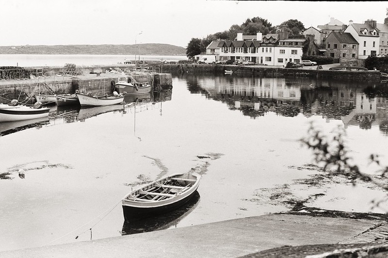

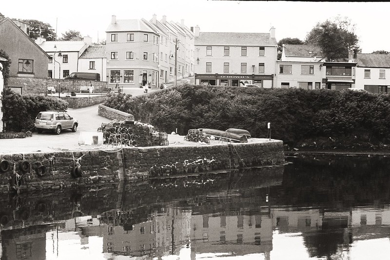

I have processed Fomapan 100 in Ilfosol 3 for 8 mins @20C at 1+14 and always got great results. ( I know the Massive Dev Chart suggests 7.5 mins)
Here are 2 examples of Fomapan 100 shot with a Fed4b and using sunny 11 rule.

Foc, your examples definitely look overcooked...
@foc I have started with MDC times and in my case they're off by a mile. This is subjective of course, I use stock ID-11 as a reference as I prefer the standard/balanced look.
Of course, to each his own. Personally, I have found MDC to be fairly reliable but as always test to your own likeing.
Not overcooked but maybe poorly scanned.
