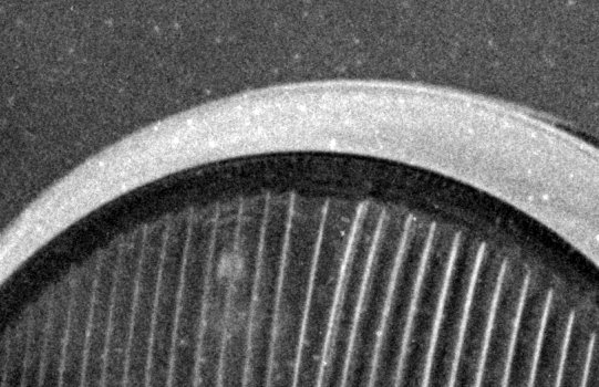

Fomapan 100 - defective lot!

That would be unusual on a Kodak product, as they are checked for this type of defect 100%. The two defects are called 'comets' and 'chatter' and are easily detected. One results from bubbles or dirt in the melted emulsion and the other results from uneven coating speed or chemical feed to the coating surface.
EK uses a laser scanner to detect such defects.
PE
I might have the same defects. My batch number is 09256 - 9.
If you sent in the material together with the other undeveloped films (together with a copy of your invoice), you will get replacement by Fotoimpex.
Foma will replace all defective film material.
Robert
Oh yes, that's exactly the defect I was talking about! The same ugly small comets! I have mistaken them for snow, so call me naive too :smile: They can't be anything scratch- or development-related, they are made from silver grains - my 100x microscope told me so :smile: I wonder how FOMA has managed to skip this obvious kind of defect during their QC? judging from what people all around the globe says, the whole 09256 emulsion lot has been ill-coated and should be all removed from sale - but only good sellers like Robert took some actions to protect their customers. So I hope this batch will end sooner or later, and the new Foma 100 emulsion would be better, i. e. not this stellar :smile:
I have only shot night shots with this film, so I thought the spots were stars or something... when looking through them now I realise they can be defects.
Robert
Ok! Do I need to send the developed films back as well? I have taken several pictures that I like, and I would not like to part with them, spots or not.
PE
Yes I agree. It can be due to some mistake I made in processing. My processing skills have improved quite a bit since that film, processed as I was getting back into analogue photography.
A little OT, but I processed a Tri-X 400 120-film a few weeks ago, with pinholes. I don't think it was my processing. Sometimes defects slip through I guess... :smile:
That's the worst part of story. Ruined pictures that you like. I am sure you don't need to send your negatives, send them an e-mail with scans - also I think they should already know about their fault and would replace the film with no extra words.

I have sent an e-mail to fotoimpex, with links to the scans and a reference to this thread. I'm sure they will get back to me soon.

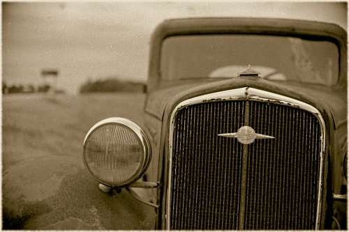

I've had the same problems described above, but with Arista.EDU 100 - NOT the Arista.EDU Ultra 100. I understand that the .EDU is Fortepan, the .EDU Ultra is Fomapan. I've had nothing but good experiences with my Fomapan (so far).
My dev process was D76 1:1 8 1/2 minutes, then rinse and fix. Agitation for five rotations every minute.
I'm enclosing an example. This has happened to me twice now, it is very aggravating. I hope it doesn't happen with the .EDU Ultra, I've just ordered a bunch of it!

Wiggy, that looks like what I might expect if you had undissolved borax crystals suspended in your D-76 -- local overdevelopment. Did you mix it (from Kodak package or raw chemicals) just before using? Of course, it could also be chemical fogging from conditions in storage, repackaging, etc., or from contamination of the emulsion with old or exposed halide crystals during or before coating. The latter is what one might expect in a factory with the problems Forte has had the past couple years...
Yes, Wiggy, your kind of defect looks like local overdevelopment dots from undissolved chemistry - not a stuff like we've seen in Fomapan 100 emulsion. There are no "tails", and the density distribution is another than in Foma... I've never met those in person on Forte films, but I can remember older Svema films (that was phenidone causing small spots like yours). Today's Forte film is quite good, and I can recommend is to anyone - the sheet film, Fortepan 200, makes an excellent portrait film with soft rich gradation when exposed at ASA 100 and developed in Microphen for 6 min 30s.
Donald,
The D-76 was/is fresh, but not this week fresh, more like this month fresh. I mixed it from Kodak package, but took care to ensure thorough dissolving of all the powder. Also, I have processed other films, such as Agfa APX 100 and Fomapan 100 (Arista.EDU Ultra 100) in the same soup at the same time - only the Fortepan (Arista.EDU 100) seems to be having the problem.
I did note that when I developed my Fomapan, I used the instructions from Freestyle's website - only noticed the directions printed inside the package later on - which showed that agitation should be constant for the first minute, then five second for every minute thereafter, total of 8.5 minutes, D-76 1:1, temp 68 degrees F.
I would think that if there are borax crystals in my D-76, all my other B&W film stocks would be similarly affected - but perhaps they are more tolerant of the problem?
In any case, I had a brick of the Arista.EDU 100. Never really liked it due to it being so curly that it was hard to scan - could not make it lay flat in the scanner tray, it wants very much to curl up as if it were still in the can. I even had trouble getting it on the reel to process. But I finally got one of those old Kodacraft aprons - works a treat, and even seems to make the Fortepan lay a bit flatter when dev is done (strange, but true). But I've had the problem with these damned spots each time I've tried the Fortepan lately, and other films I've shot and processed at the same time do not exhibit this problem.
Any thoughts?

OK, sorry to jump in on your discussion, then. From the way it was described, I thought we were seeing the same thing, only with me it was the Fortepan not the Fomapan. Fortepan may be good, but since I've had this problem several times now and only with Arista.EDU 100 films, I think I'm going to stop using this one and turn to the Arista.EDU Ultra (Foma) which has treated me very well so far.

Wiggy, you're correct that it's very unlikely you'd get that effect in the same tank where other films didn't show it. Those other films can't very readily be more tolerant, since the effect is local overdevelopment and is more dependent on the developer than on the film.
I might suggest that use of aprons could contribute, though -- the aprons might have collected randomly selected chemicals from decades of use, and now release those chemicals, sporadically and locally, while almost in contact with your film. And, if you're using the apron in a tank along with other films on steel or plastic reels, you might in fact see an effect from the aprons that didn't affect other films in the same tank.
