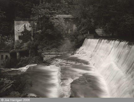

I use the fomatone mg variable contrast for my warm tone prints and I really like the paper. It has a brown green to brown olive color which can be toned down (the green) by using GAF 135 and following that with selenium @ 68-70 degrees 75cc/L for a minute or less. The prints will be very nice warm color that I really like. Longer selenium produces a strong red color that I don’t care for. Here is an example.
