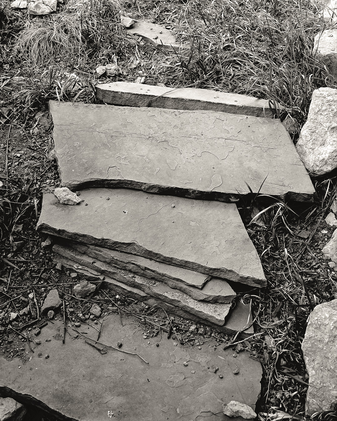

I also like Fomapan quite a bit. Here is 100 at 5x7 in Pyrocat HD

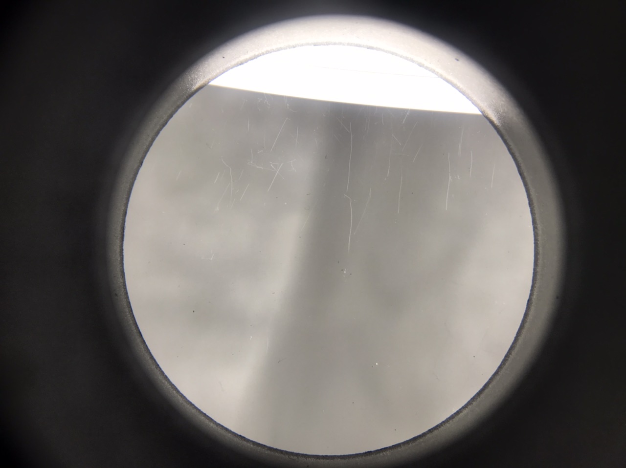

I have some foma 200 4x5 drying right now that have scratches all over them. Once they dry I will test with some nose grease. Printed small 5x7 the scratched don't really show up under a diffusion enlarger but printed at 11x14, the scratches are very bad. Bad enough, I might just go back to hp5. I have never got scratches like this with hp5.

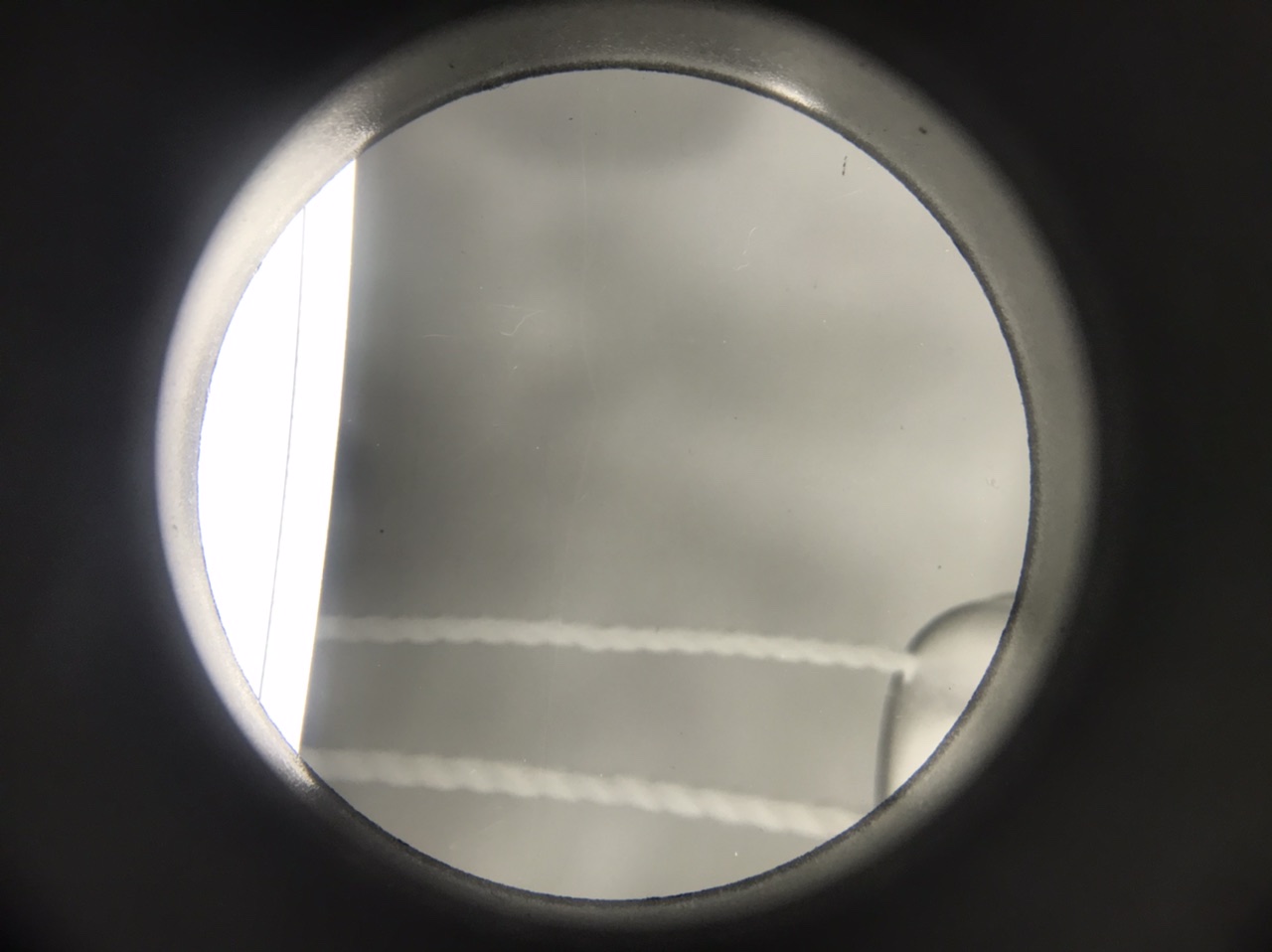

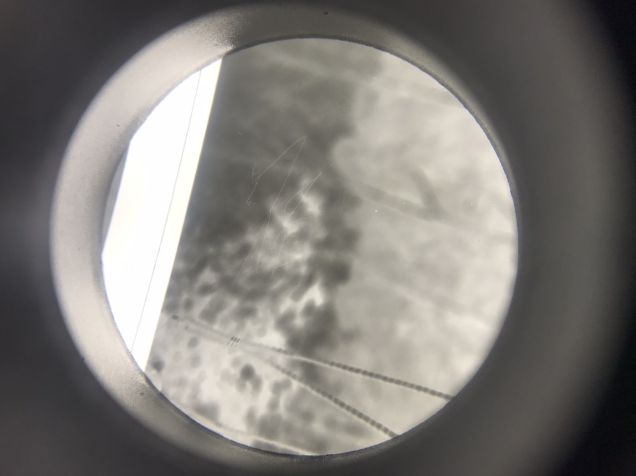

Here are the scratches I'm dealing with foma 200 4x5. I am in no way assuming these are coming like this, I think it something I'm doing, but have never had any scratches with hp5, fp4 for tri-x. I have always tray developed using the shuffle method. The scratches seam too always be closer to an edge.
7BCDF522-A589-4C2F-B643-C48D4843C70C.jpeg BD3F3776-3033-4276-ADB1-04A479CFB78A.jpeg CBF582A3-FD5C-4746-B42B-08E239810A70.jpeg
