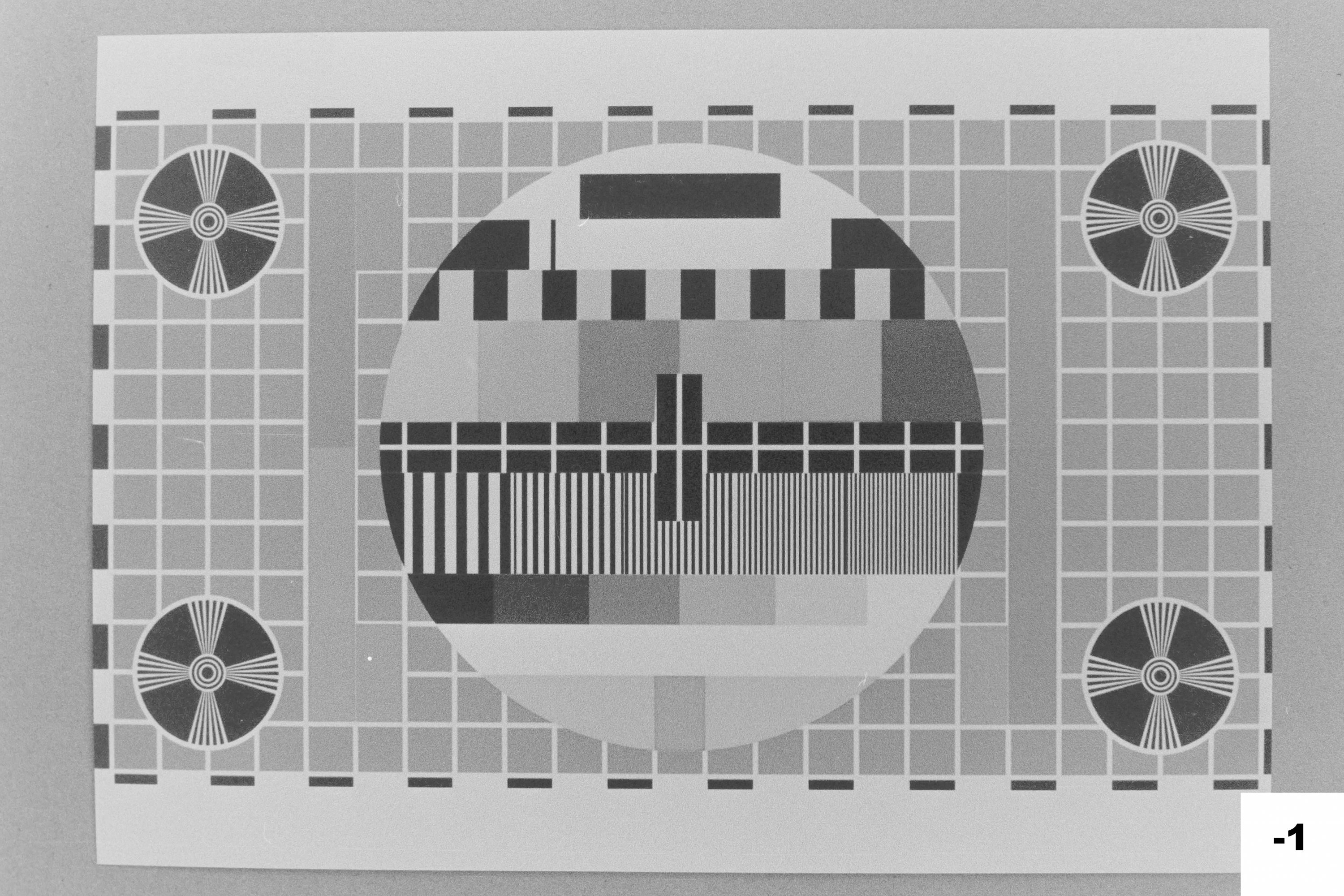

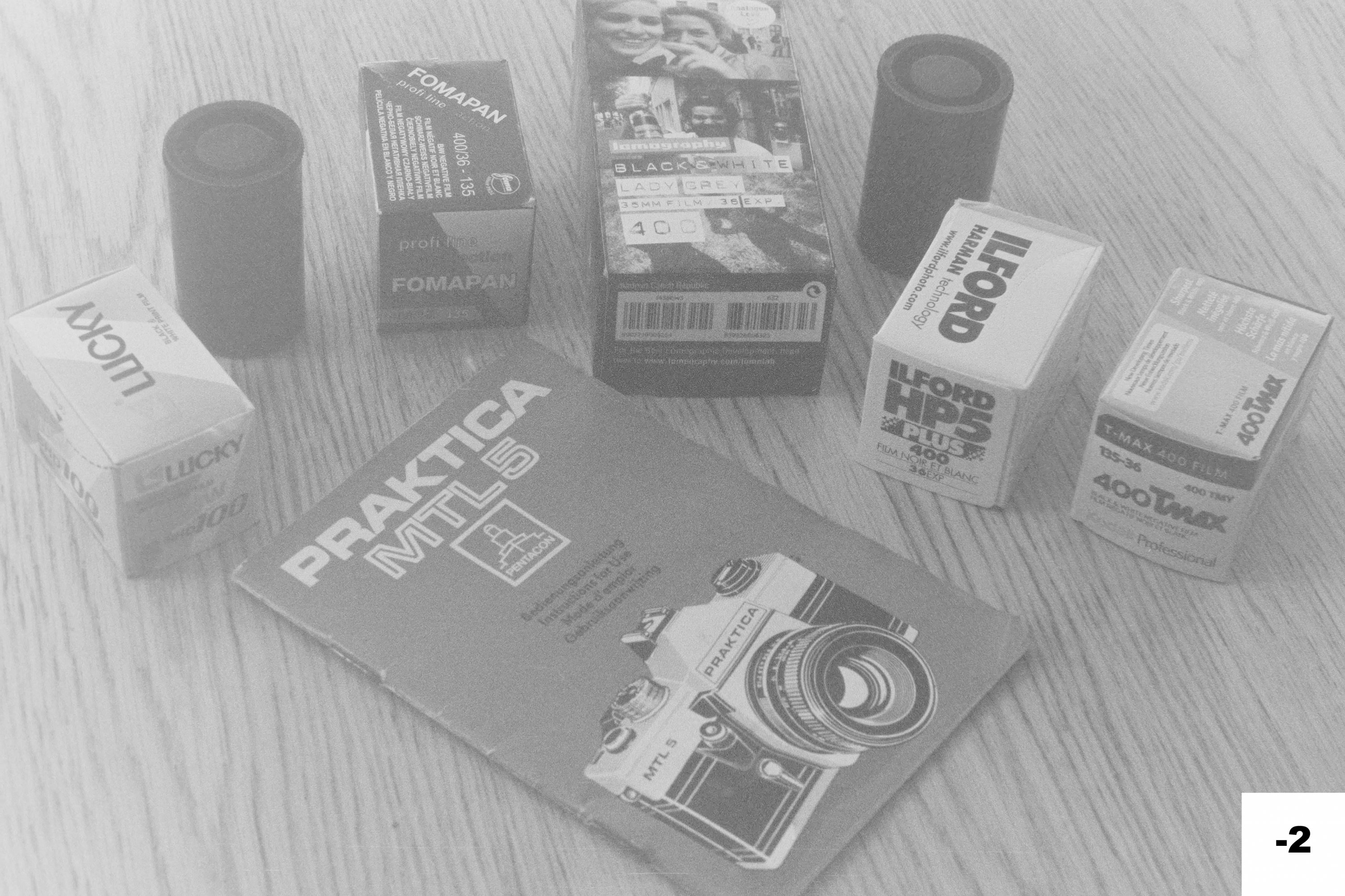

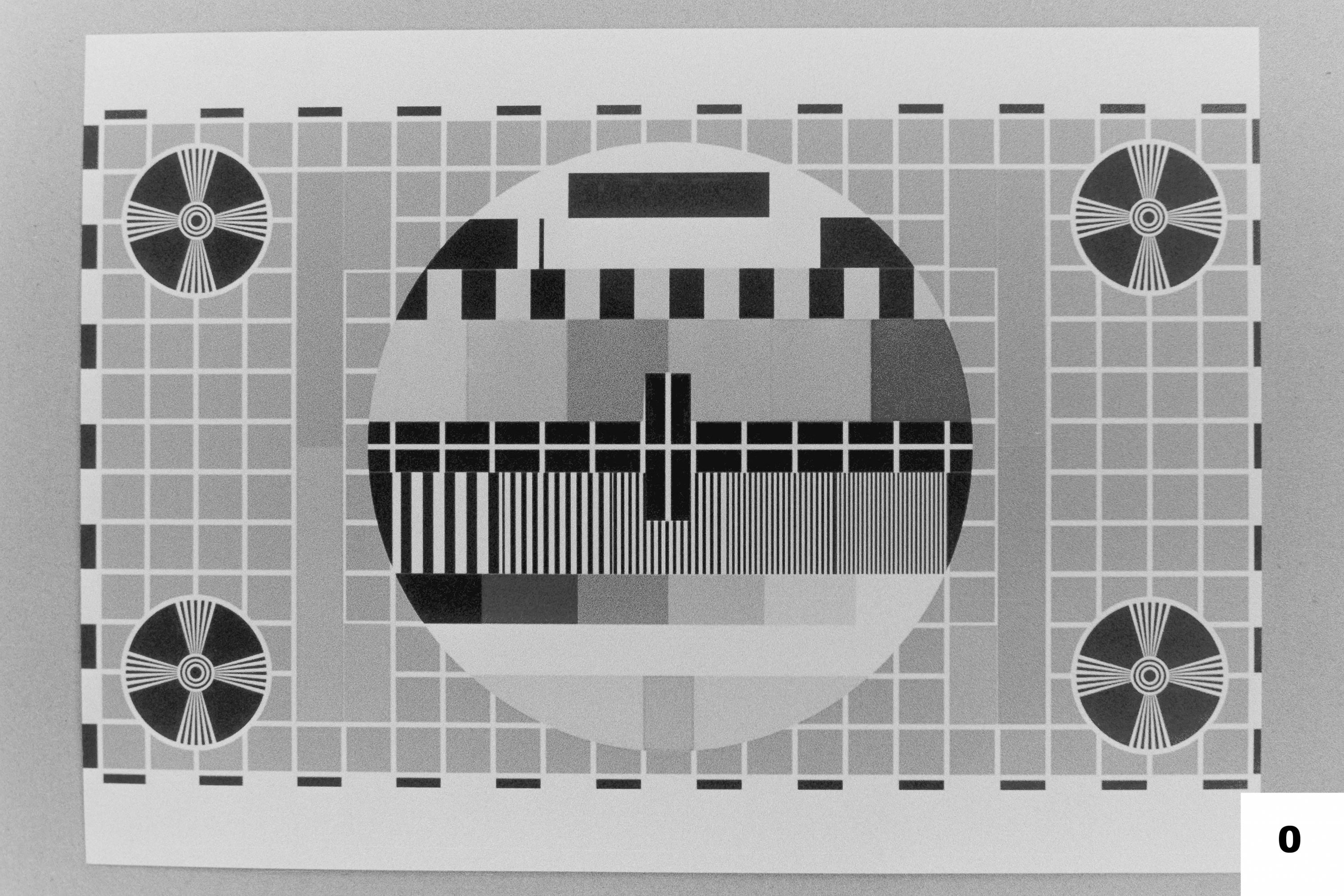

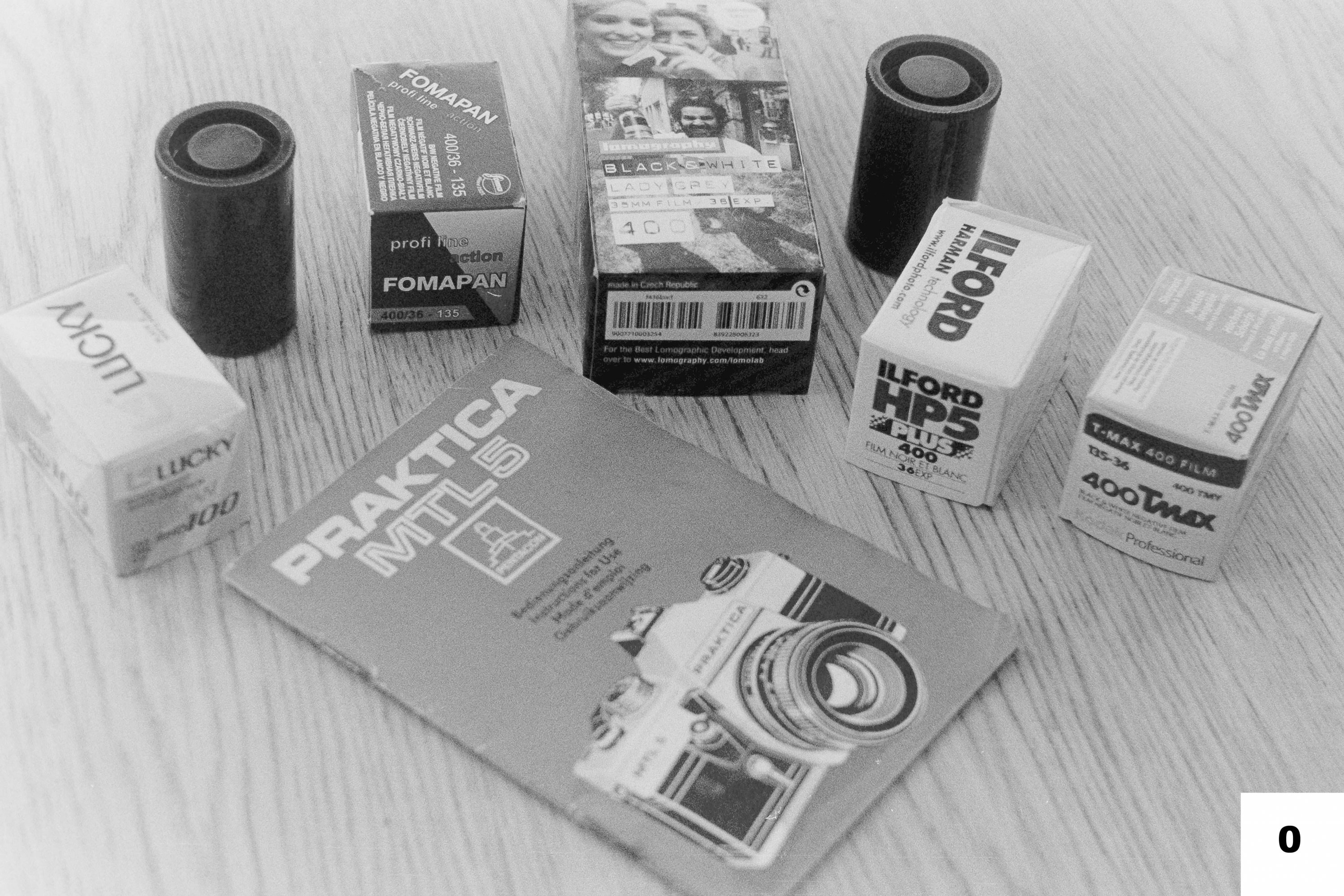

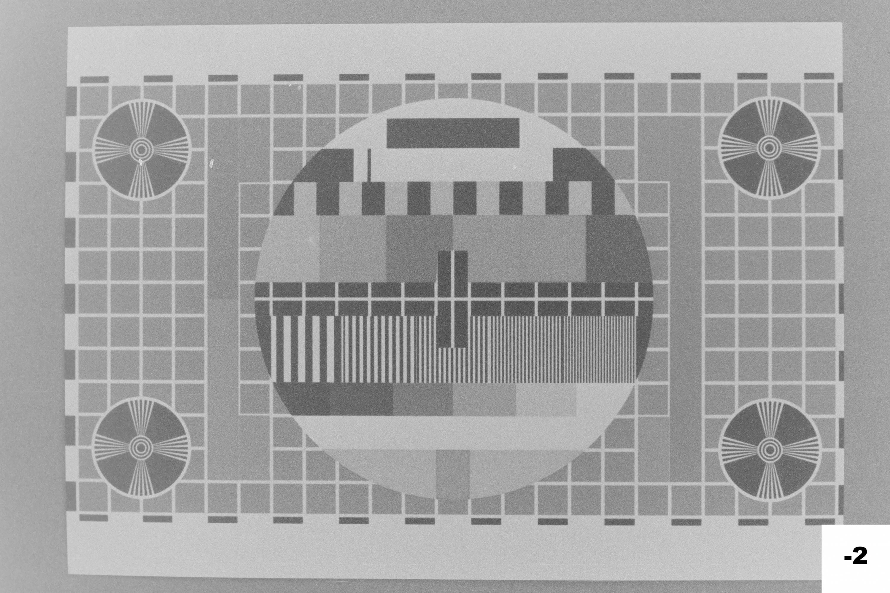

Here are a few shots I was doing for a test, in association with Henning Serger, comparing Lomagraphy Lady Grey and Foma 400 (BTW they are the same film).
Click on the thumbnails to view full size.
Foma 400 minus 2 stops at box speed = ISO 1600. Developed in Ilford Ilfosol 3 at 1+14 for 12 mins @ 20C
Foma 400 minus 1 stop at box speed = ISO 800. Developed in Ilford Ilfosol 3 at 1+14 for 12 mins @ 20C
Foma 400 at box speed = ISO 400. Developed in Ilford Ilfosol 3 at 1+14 for 12 mins @ 20C
I haven't got a chance yet to use one of their own Foma developers with their film.
As you can see the claim to shoot at 1600 but don't change dev times doesn't hold true for the Ilfosol 3 developer. It may hold true with their own developers like Fomadon LQN " the magic water" as it has been described on some websites.
