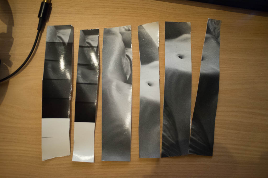

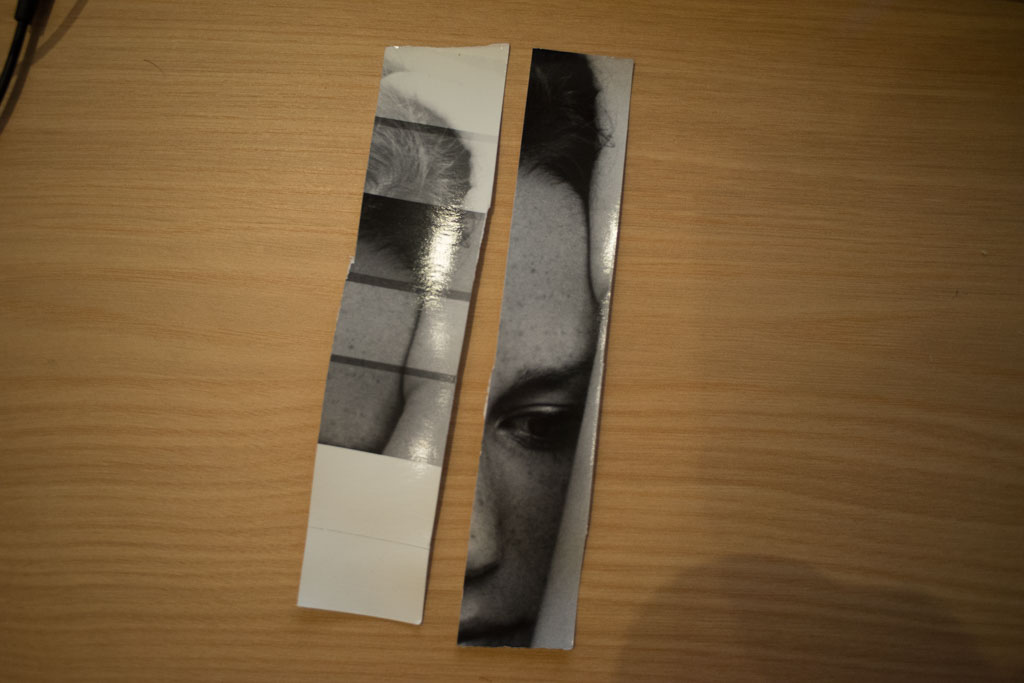

I'm going to suggest an experiment for you.
Using test strips, make a print of a section of your image that contains the highlight areas that you are most interested in. If possible, include some important mid-tones as well.
Adjust the exposure and contrast to make the test strip area look exactly the way you want it to. Don't do any burning or dodging on the test strip. Make sure that the test strip is fully developed.
Now print the whole image using the exact settings you used for the acceptable test strip.
If you can, post a scan of the whole print, along with your impressions about the areas of the print that are outside the test strip area. Include the details about what contrast setting you used, as well as the print times.

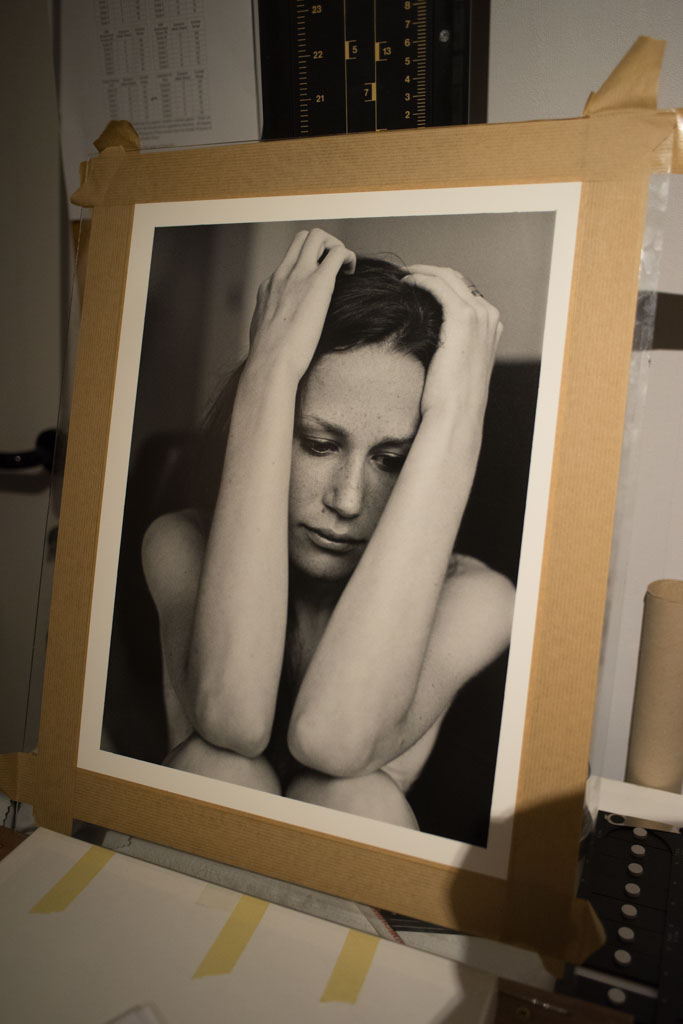

Alright. I'll post it when it's dry. I just printed two images this afternoon. One that printed easy at grade 2, but personal taste wanted grade 3.
Another one neg that was very thin (I'll show this one when it's dry). I did a few test exposures, had to get to grade 5, and increased the exposure time to get "ok" blacks. I knew that was going to happen when I saw the negative... Wish I knew it back then, then I could have metered better as there was enough SBR (at least tonal difference...) just underexposed I guess.. :sad: So I had to get the highlights ok which made the shadow detail get little grainy and not too black. Also toned the final print with Moersch Selenium toner 1+20 for 1 minute.
I first had f16 12.7 seconds, but the blacks where not black enough so I increased the exposure as my grade was 5 already, sacrificing a bit of highlights, but it still looks well.
The final print settings were f16 - 18 seconds at grade 5 with Moersch ECO 1+15 @ 3 minutes on Adox MCC
Will post when it's dry...
Regardless of the work and compromises you had to make, did you get the detail you wanted in the shadows?
Funny thing is that I wanted the shadows to fade away. But yes, the print turned out much better then the scan I had from it.
If the shadow detail you wanted was available to print, the film wasn't really underexposed was it?
Given the use of grade 5 paper and the acceptable shadow detail available, I'd say that development was the reason for the thin negative not the incident meter.
But could have been very short SBR.

There you go :smile: The 6 teststrips are from the difficult neg. Started with 1 stop exposure, then 1/3, then printed it, I think I then increased contrast to grade 5, still not good, then I changed the exposure up a 1/3rd, still not good. Then I did 1/3rd more and looked "ok". After developing and selenium toning it turned out quite well.

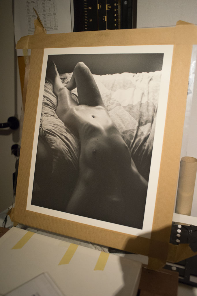

The other print was done in almost no time, 1 test strip (I failed the one in the middle). Used one specific exposure, the 4th on the strip. And turned to grade 3 for personal taste.
