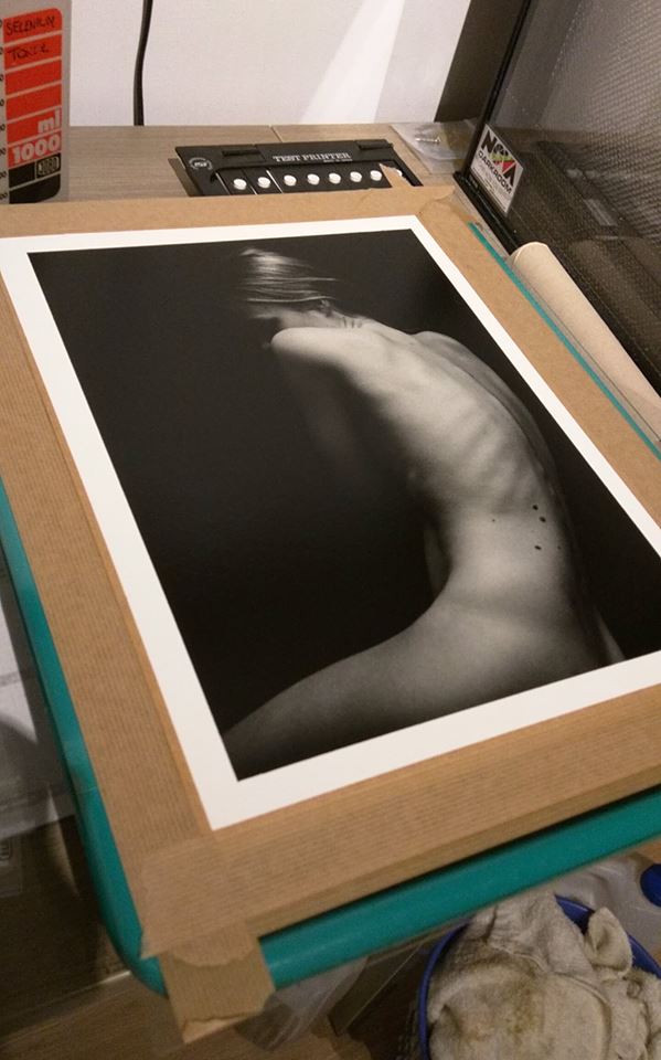

In the attachment you can find a print I made today on Adox MCC, I had to print it on grade 4, so the texture still visible of the couch she is lying on, would disappear. But having to print it at grade 4 doesn't make the negative or print bad? ... At least I hope that would solve my issues :smile: As I'm wondering why I always have to print at higher grades..

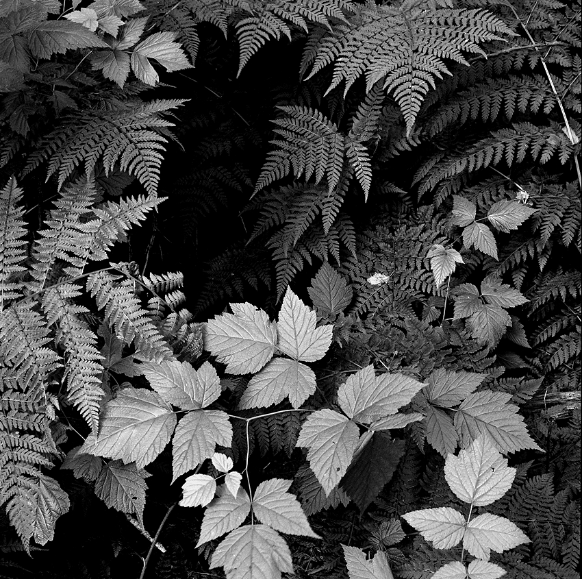

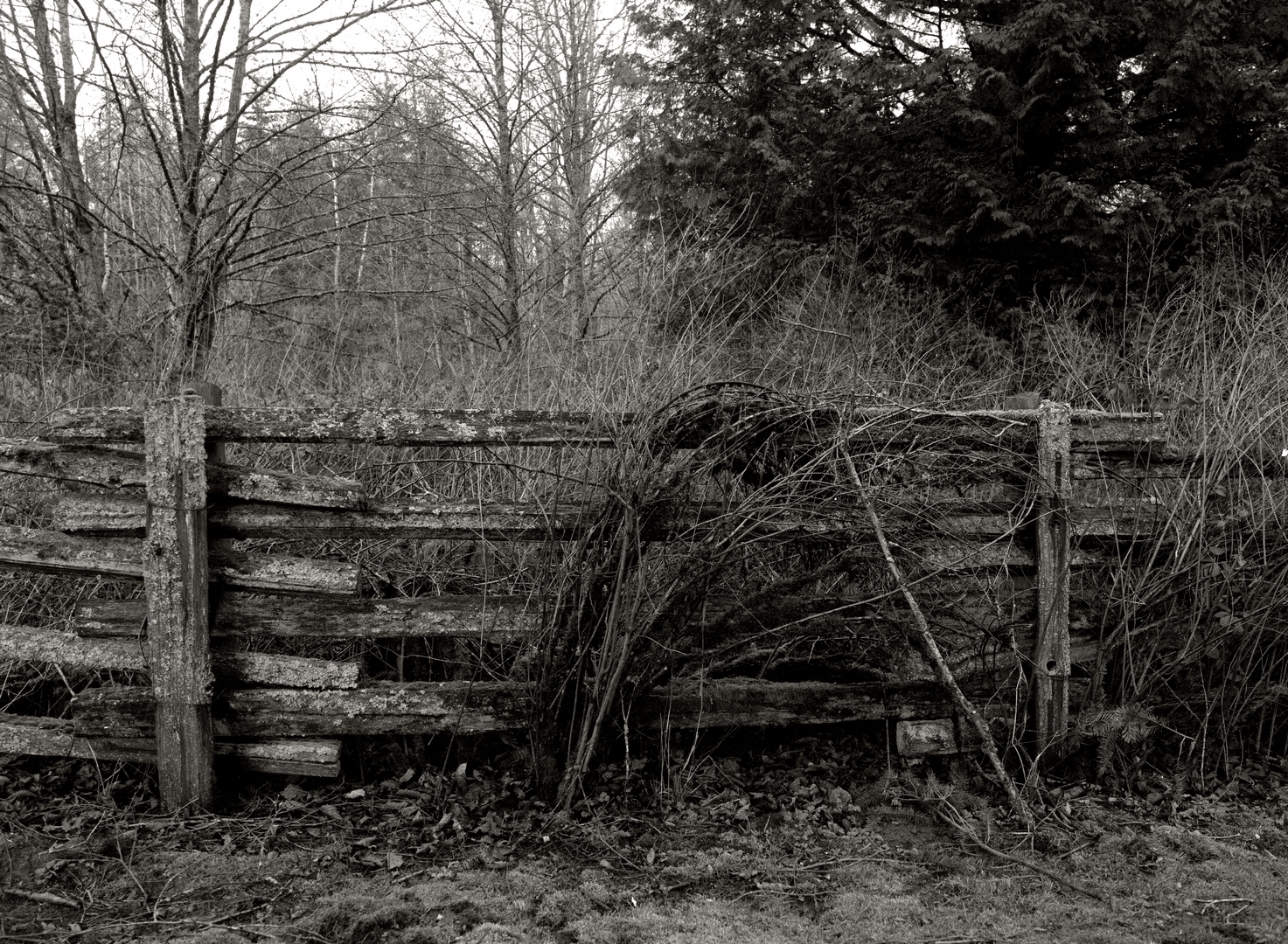

I went to look through the scanned photographs I have to see if I could show you a couple of examples of what I mean. I don't digitize many, so the examples I found are mostly colour, not black and white. But the lesson to be learned from these is that contrast determination is best if it is not made based only on the shadows and the highlights.
42a-2013-10-19b.jpg 2016-02-15-48h.jpg Image10e-2012-03-13-APUG.jpg leaves2.jpg

- If the SBR is less then 10, and you expose for zone 7 (highlight), won't you have to increase contrast too?
- Why is it more difficult to print a thin negative if exposed for the shadows? I know you said SBR > 10 = meter shadows & SBR < 10 meter highlights, but I don't understand why yet.
- If you have an SBR of 8, and thus meter for the highlights, like my first attachment in this topic. The lightest part is her shoulder which is zone 6, where should I meter? Or should I put the shoulder in zone 7 if that is the lightest part?
- If you have an SBR of 8 or bigger then 10, (same question as before) and have no real shadows or blacks in the image, where would you meter and how would you expose? I can provide an example if necessary
That's probably it, if I get to know what and why things are happening I think I'm getting close to the solution. Images that have a decent SBR that I have shot in the past and developed the same, just work out great on grade 2.. So now on to better exposures and development! I hope I can start using the zone system again
