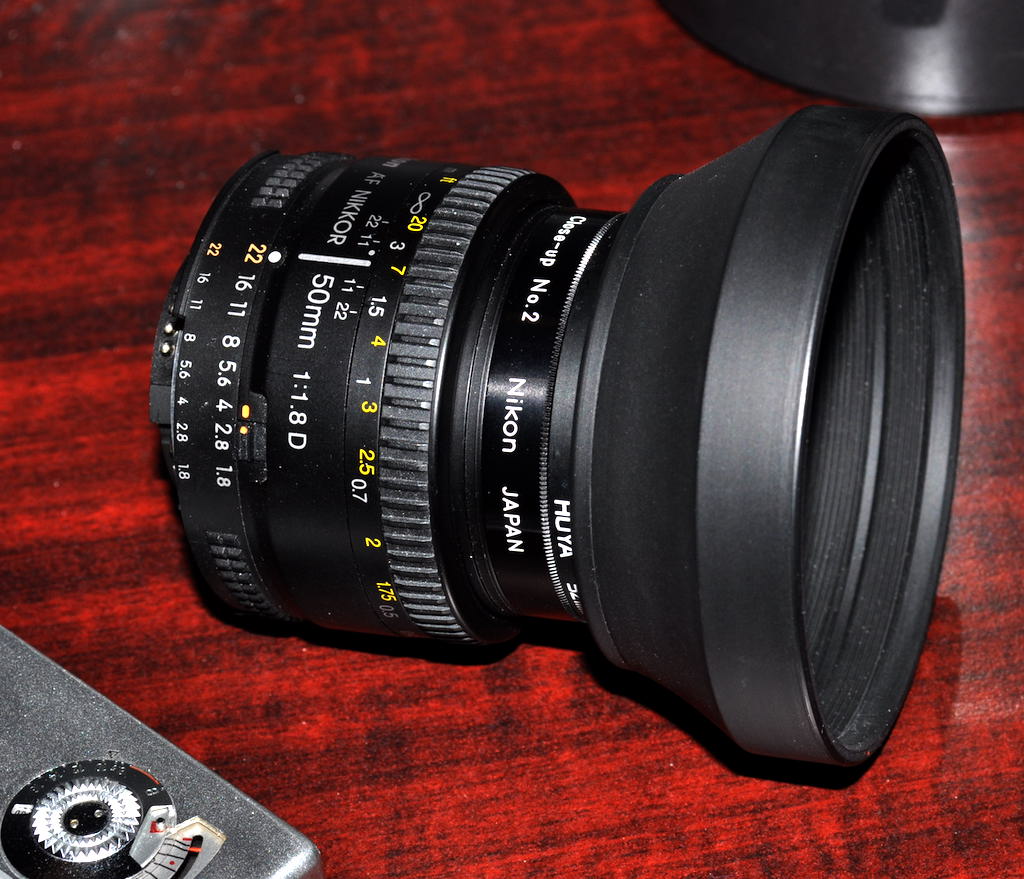

I've got a folding rubber lens shade that is the perfect fit, but it is starting to deteriorate -- one of the seams/creases/folds is starting to split.
My first though is simple rubber cement, but I doubt that will be strong enough, so I thought I'd "Ask the Experts" first.
Is it DOA?????
