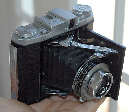

The Zenobia by Daiichi is a favorite folder of mine.
It is a well made, compact 645 folder with Tessar type lens and shutter to 1/500. There were several models, some with built-in rangefinder. They are fairly numerous on eBay and don't cost much.
