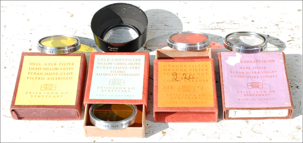

If you do want to use filters, a push-on Series V or VI filter holder, yellow filter (for B&W), and hood is a nice accessory to have.
Many of these cameras need to be uncocked when setting the fastest speed to avoid screwing up the shutter.
... yellow filter (for B&W), and hood is a nice accessory to have.
True ! I have a small collection original filters made for the Super Ikonta III 531/16 - those are build a little special ans some what hard to find
Those are marked with #353 S35.5. In the back a Kenko 32mm slip-in hood that fits the filters.
