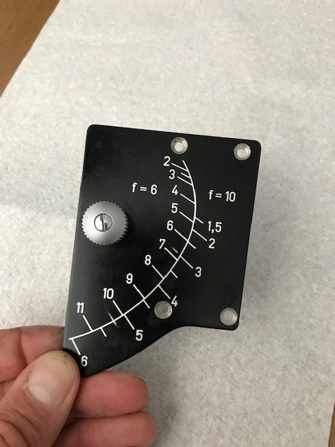

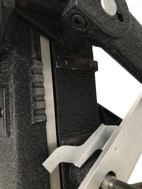

Thank you for everyones help with this. Today I came back with a fresh approach and re-read the comments. I retracted my temporary Bowden cable to enable the wheel to run on the top cam to give maximum bellows movement, I did this to test the movement in the head, I lowered the head as far as it will go, this enabled me to lift the head up and down to test if the head was sticking as suggested in a post. It wasn't. There is plenty of weight there too, so for it to be sticking it would take quite a bit of crud in the runners.

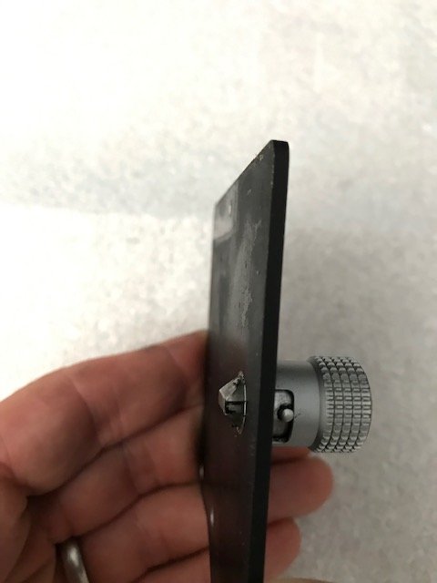

I then looked at the knurled knob and watched the indent move nicely in and out of the ridges as I raised and lowered the head (using the technique of holding by where the Bowden cable enters. I then thought this may be where the enlarger is sticking as it moves from one ridge to another. There are 4 screws that hold the enlargers enlargement scale plate to the enlarger. You have to unscrew the knurled knob that you undue to move the head up and down to gain easier access to the screws. I cleaned all parts and gave them a very light oil with WD40 (perhaps not the best). I then put this back on and the result was the same. I then removed this once more to enable me to dismantle the knurled knob. This I dismantled, cleaned and oiled. There is a grove within the knurled knob that I cleaned too. Unfortunately none off this has solved the problem.
I then looked at WFW's comment regarding - from memory the knurled knob should be pulled out and not in. As you all know I have had the knurled knob selected. I was wrong, it shouldn't be selected, it should be out as WFW and I think someone else hinted at (sorry). With the knurled know selected correctly the enlarger moves up and down beautifully and stays in focus throughout the range. I will always double check the focus before printing.
