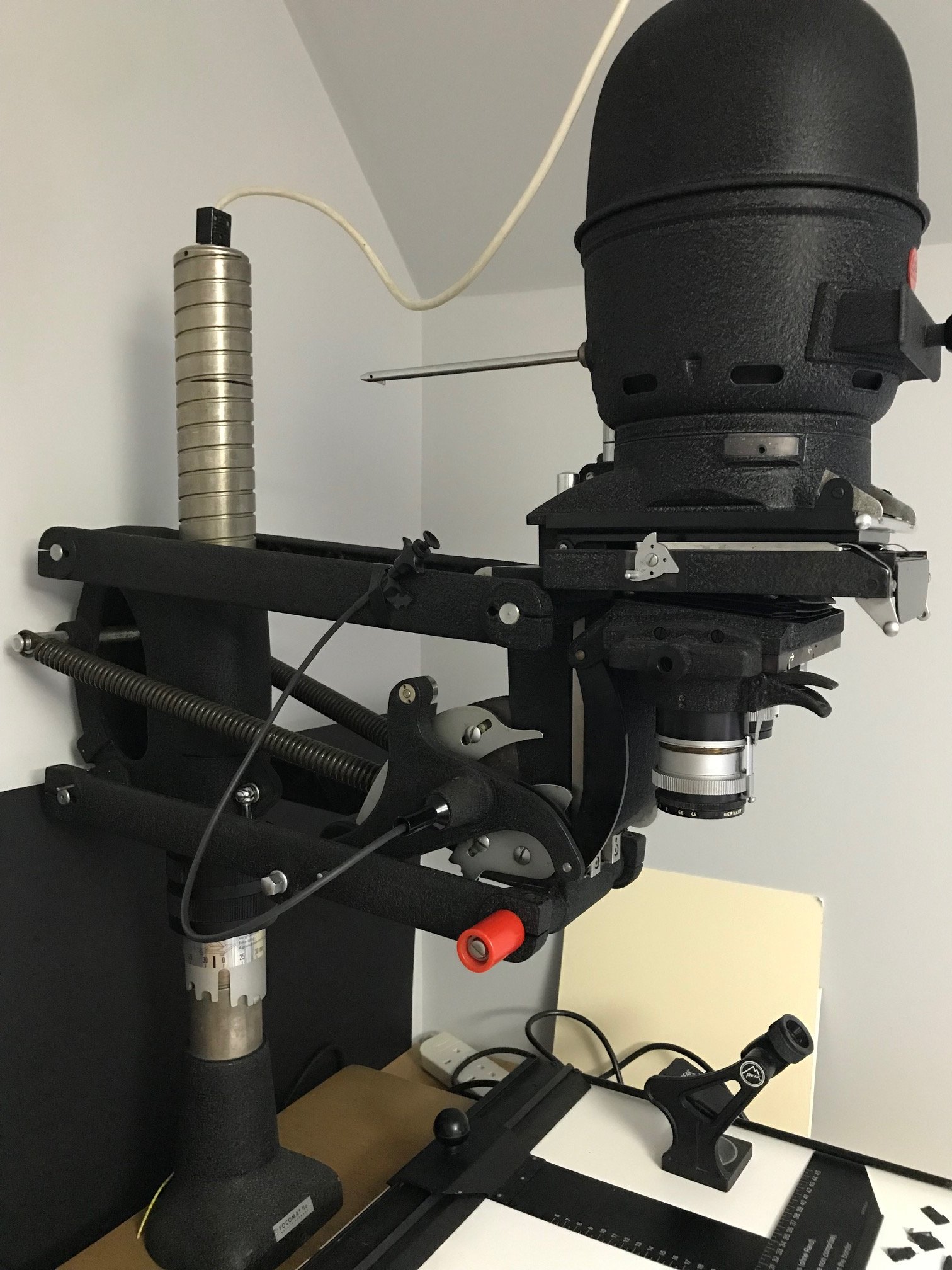

I purchased a black Focomat IIc about six months ago. I've now set up my darkroom and i'm starting to explore the IIc. So far I'm really pleased with it, however, I do have one problem.
I use the 60mm lens for my 135mm negs as I believe I should and when I lower the head with the red handle on the left it suddenly drops and emits a loud bang. This happens when I look at the enlargement scale at 3 and then drops again a small amount at 2.5. The lower wheel is running along the lower cam and then it does lift off of the lower cam the lower the head goes. If I lower the head by not using the red handle on the left but hold just above, the point where the Bowden cable enters it holds the wheel against the cam and works perfectly and the head (bellows) lower smoothly. I do not have to use any force just literally hold and lower at this point. I can clearly see the cylinder running on the lower cam, it doesn't lift off at any point when the 60mm lens is selected and I use the above technique of lowering and raising the head by holding by the Bowden cable.
I should add, using the above technique the autofocus works through the entire range. The same happens if I use the 100mm lens and the upper cam, the wheel doesn't follow the upper cam the entire length and sits above the cam and of course as I lower the head it suddenly drops approx 1cm. If I hold by the Bowden cable it works as it should and follows / runs along the cam.
If I deselect the autofocus by pulling the knurled head (number 37 in the English manual) the head rises and lowers perfectly. If I reselect the autofocus and look at the knurled head you can see the pin moving between the ridges clearly, this moves smoothly if I raise and lower the head by using the section of the enlarger mentioned above by the Bowden cable.
The enlarger is in very good condition. I have oiled the red nipple points with sewing machine oil as described in the manual in hope that something may have got a little stuck, this has not fixed the problem.
I have also undone the tiny screw and removed the pin to release the arm just below the Bowden cable to check they are moving freely, they are.
I have also read a lot about adjusting the cams / autofocus. There isn't enough movement / adjustment in the cams to raise them so that the cylinder runs along the cam for the entire length. This is the reason I thought something may be sticking to prevent the head moving smoothly.
I realise I can use the enlarger by holding it in a different place but it is frustrating me why this is happening.
I hope I have explained this clearly. Has anyone got any idea what could be going on please?

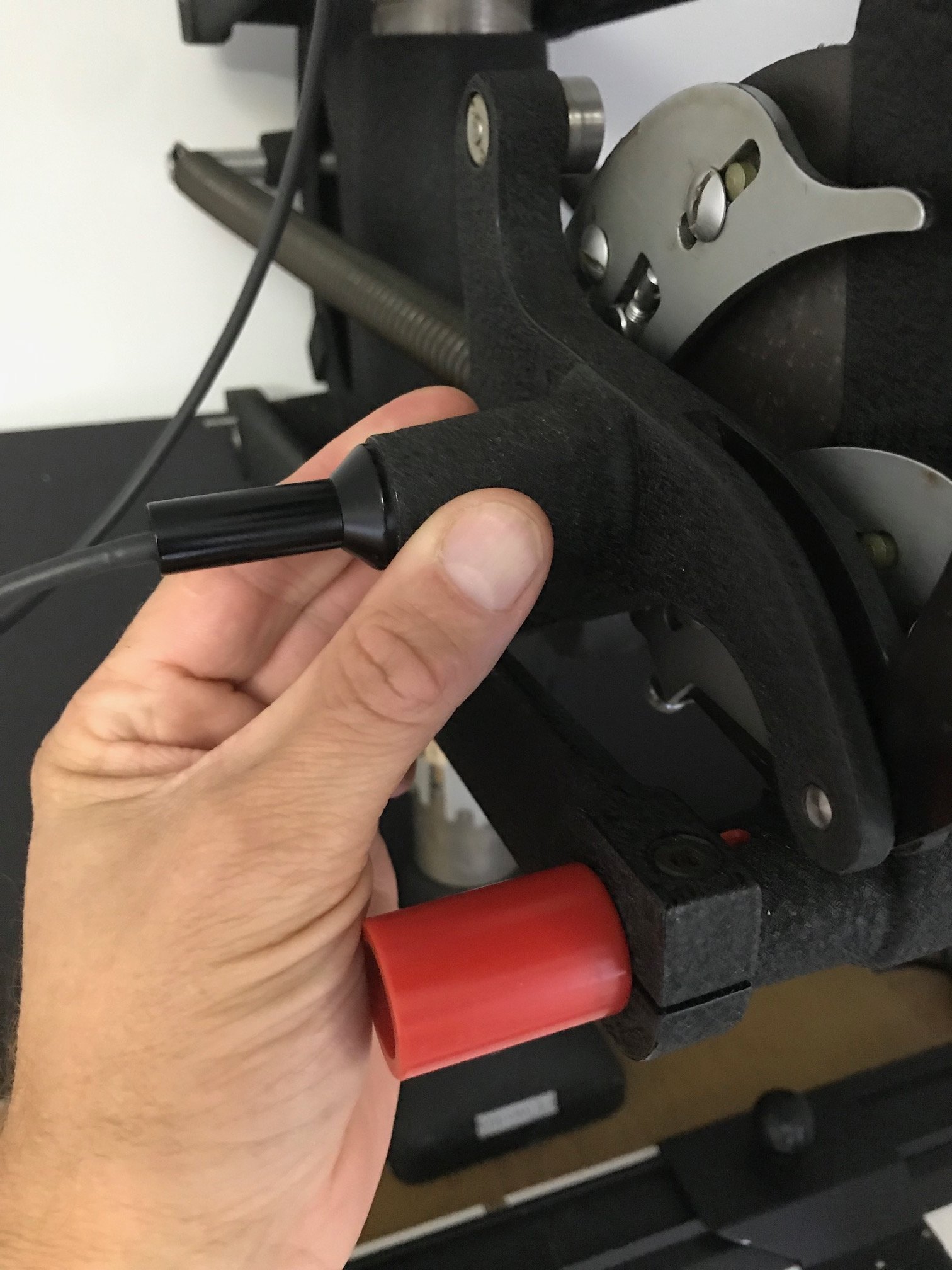

I know the problem, but I don't know why it happens: my first very beat up IIc did exactly that. I never gave it much thought (at 20 years old) and just held my hand under the lens so that it dropped on my hand. I printed like that for over 10 years, pffft. Then I inherited a black IIc that was like new and was actually never used. Because it never operated I took it to a Leitz repair man to be serviced. When that had happened this IIc operated very different. No banging down and everything was incredibly smooth. That was about 20 years ago and it still is like that.
I am not sure if I understand where exactly by the Bowden cable you hold it, and what you do: pushing up or down? Tomorrow (afternoon Holland) I am in my darkroom and if no one else here has come up with the solution, I will have a look to understand if the movements you describe of the wheels on the cams are logic compared to mine. There's hardly any bellows movement with one lens, and quite a bit with the other, I forget which . . .

I'd appreciate it if you could see how and what your wheel does on the lower cam please. I have also checked the manual and the knurled knob is in the correct position - engaged for the auto focus / general use.

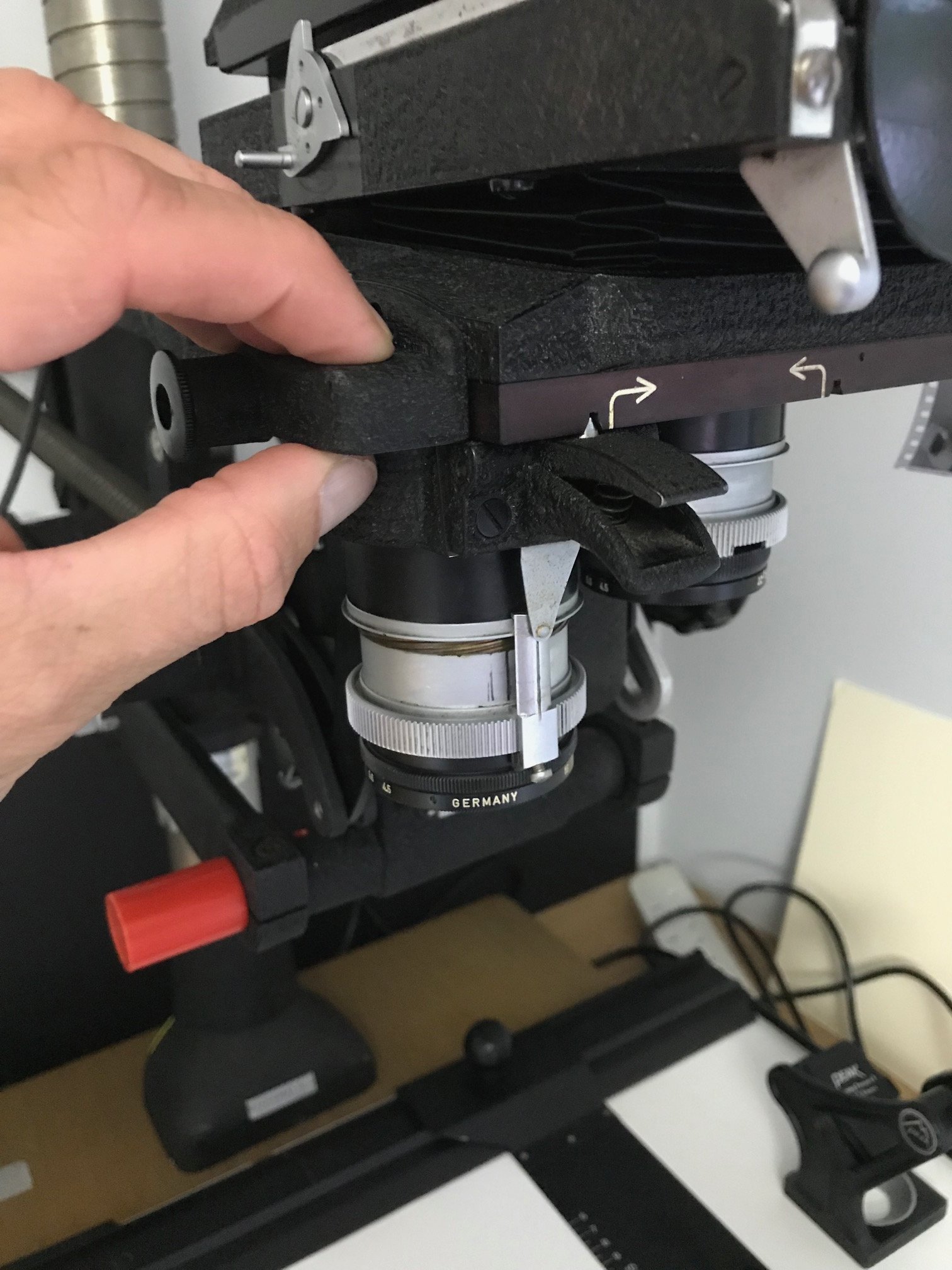

I've uploaded a couple of photos of where I am holding the enlarger for it to work correctly. Also a photo of the side of the enlarger incase someone spots something wrong, in this you can see my temporary shutter release cable that is working as a temporary Bowden cable and keeping the wheel pushed out for the lower cam.
One thing I have noticed, if I hold the section where the lenses are mounted and lift it up and down I have movement. This is the movement I have when I hear the section drop if I hold the red wheel when lowering the enlarger. By lifting and lowering this section the wheel lifts off of the cam. Please could you check if you have movement here please? I've attached another photo to show where I am holding for this.

Gary, ok I understand now where you hold it.
One thing: it looks like you entire head is tilting backwards, from above the bellows. Is that real or an optical joke the camera is playing on us?
It is an optical illusion, I just went out to the garage to get a spirit level to double check. All level.

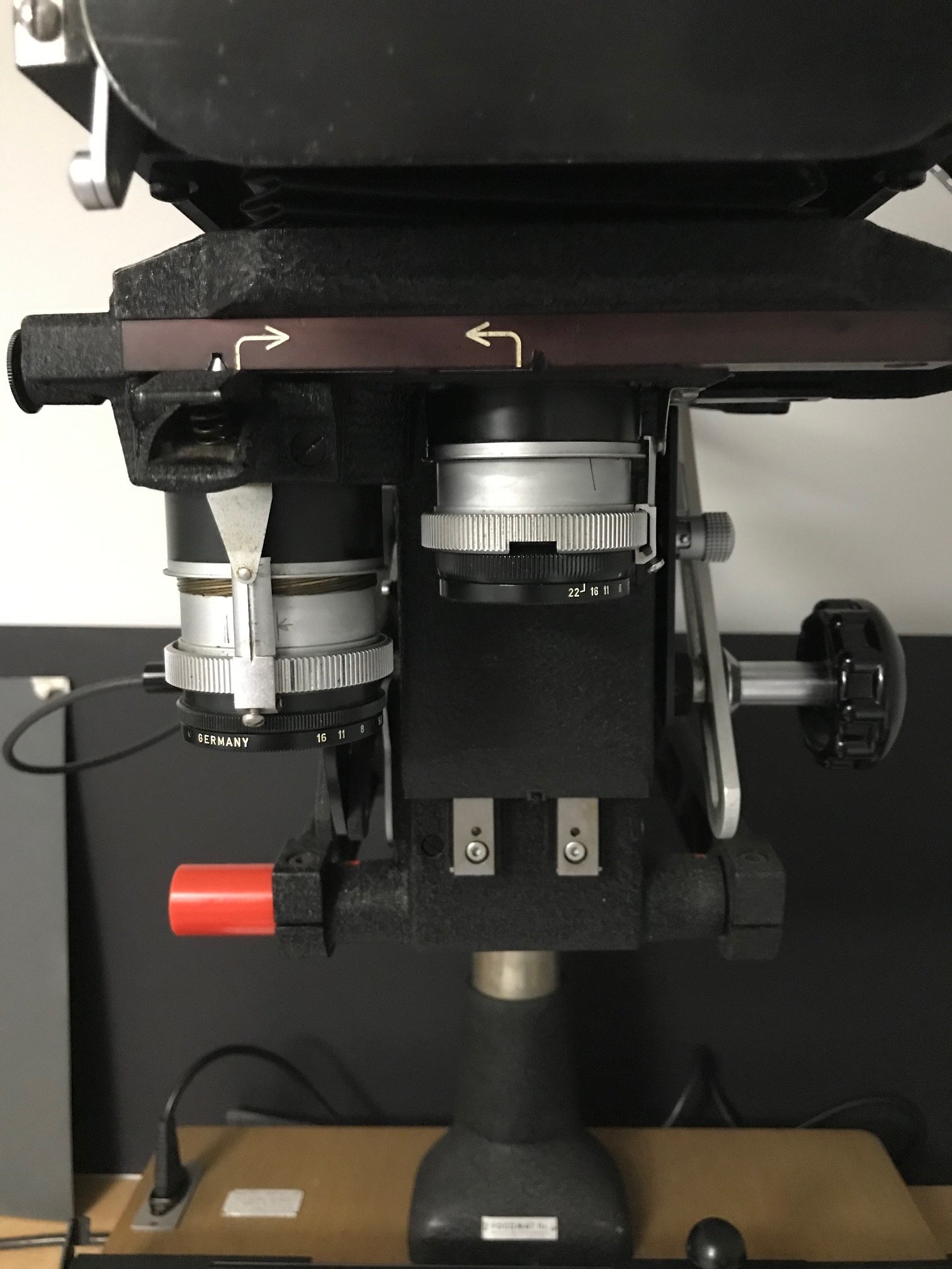

Once thing that has got me thinking is the way you change lenses. On page 12 of the manual (pic attached) First paragraph, end of line 5 - "lift the lens carrier by the handle (31)". I don't lift anything, all I do is pinch the two sections (no. 31 and 32) and slide the carrier and then release so that the carrier locks in to the small indent. If I do lift this is the movement I am experiencing, approximately 1cm of up down movement. I can see the wheel coming up off of the cam. So perhaps something should be locking in.
Thanks for your help.
That's what I tried to make clear before: you must (1) pinch and lift up, then (2) move sideways. With the Bowdon cable, when you don't lift the wheel lands against the cam, not on it
I am not convinced the way you do it caused the dropping. Also, since there's no Bowdon cable you don't run the risk I spoke about before.
But at the moment I don't have the Bowden cable only my make shift shutter release cable. I have made sure the wheel is sitting above / running along the top of the bottom cam. I've looked under where the lenses are and have added a couple of pics of this, is there anything missing there other than the Bowden cable coming in. As I don't have the cable and by having the wheel sat on the lower cam and the 65mm lens selected surely this cancels out the cable as the problem? Or does the cable do something else.
When I pinch and lift up as you describe nothing happens other than the lenses can move to either the 60 or 100 position. Does something else happen when this is done?

On the page from the manual there's a paragraph referring to the longer lens being set to the focussing detent marked "R"
to me that's as clear as mud.

John that's interesting yours does the same, would you mind trying to lower your enlarger and hold it where I have been to see if it still drops please? I have been printing really small for a friend and if the enlarger drops it's nearly impossible to focus, but if you hold the enlarger the way I have had to the focus remains perfect and you can print very small. My easel is the 30mm Leitz one and set the collar to the 30mm setting. I only realised this was incorrectly set along with the collar you wind down the other day, I literally spent hours trying to get the autofocus to work.
I also found that section of the manual as clear as mud.
I don't see how holding in a different place (as you show) can make this difference. I never touch the red thing and just unscrew the black knob on the right and bring it up or down.
Also, I have had several IIc's set up in my darkroom, and I have helped many people to get them. I have never had to fiddle with the automatic focus. Normally all works well and I would not touch that until someone can guide you. Give it a moment . . .
By holding it in a different place it prevents the wheel lifting off the cam and the head suddenly dropping. I discovered this my accident. If I don't hold it here the wheel doesn't follow the line/ run of the cam, the wheel lifts above the cam and then the head drops and goes bang. I look and see the wheel is back on the cam.
I normally only hold the black knob on the right too and it was only after reading the manual again as I was hoping to get a clue re my head dropping that I noticed you should hold the red knob on the left. It was then whilst trying to reach for the red knob I reached above by accident and realised by holding here the head doesn't drop and everything works perfectly.

Yes by holding near the Bowden cable it is simulating the correct procedure, movement. It is gradual and nothing drops / bangs it's not a natural place to hold and move the enlarger head so it does feel a little strange but there is no resistance in the movement.
Looking again at the movement of the wheel and cam, I've noticed the wheel lifts off of the cam at approximately the same height. For example if the 60mm lens is selected the wheel runs on the lower cam and when the arms of the enlarger are horizontal the wheel starts to lift off of the cam. This happens when the 100mm lens is selected and the wheel starts to lift at the same point when the enlarger arms are horizontal.
