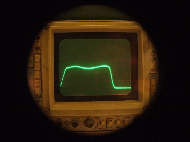

The penumbra of a leaf shutter recorded from a high speed photodiode with a 5 degree angle of view measuring scatter off a ground glass. In this shot the shutter speed was 1/30th s . Th ripple while the shutter is open is from the incandescent light source.
Unknown to me in this relative light amplitude is the light level that will be above the reversible re-halogenation.
That is, I wonder how far up the slopes does the film start/stop to irreversibly record the image?
