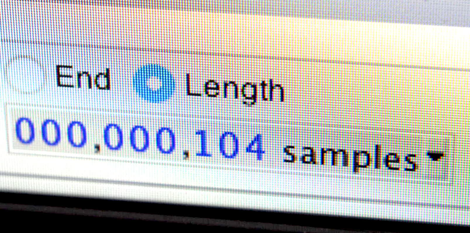

Audio analog-digital converters commonly sample at 44100/sec, which is the sample rate for audio compact disks.
In that case, 1/1000 of a second would be represented by 44 samples.
However, as anyone that has used this method would know, a correctly functioning shutter at 1/1000 produces a waveform with many more samples than 44.
So, there are a number of errors in the system for which need to be accounted.

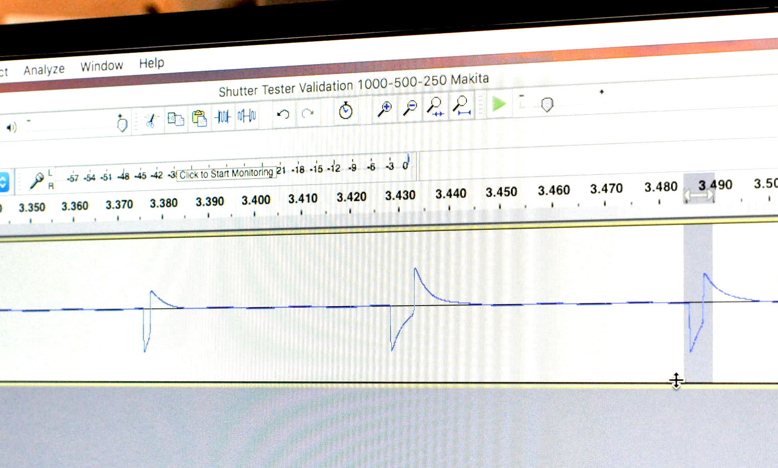

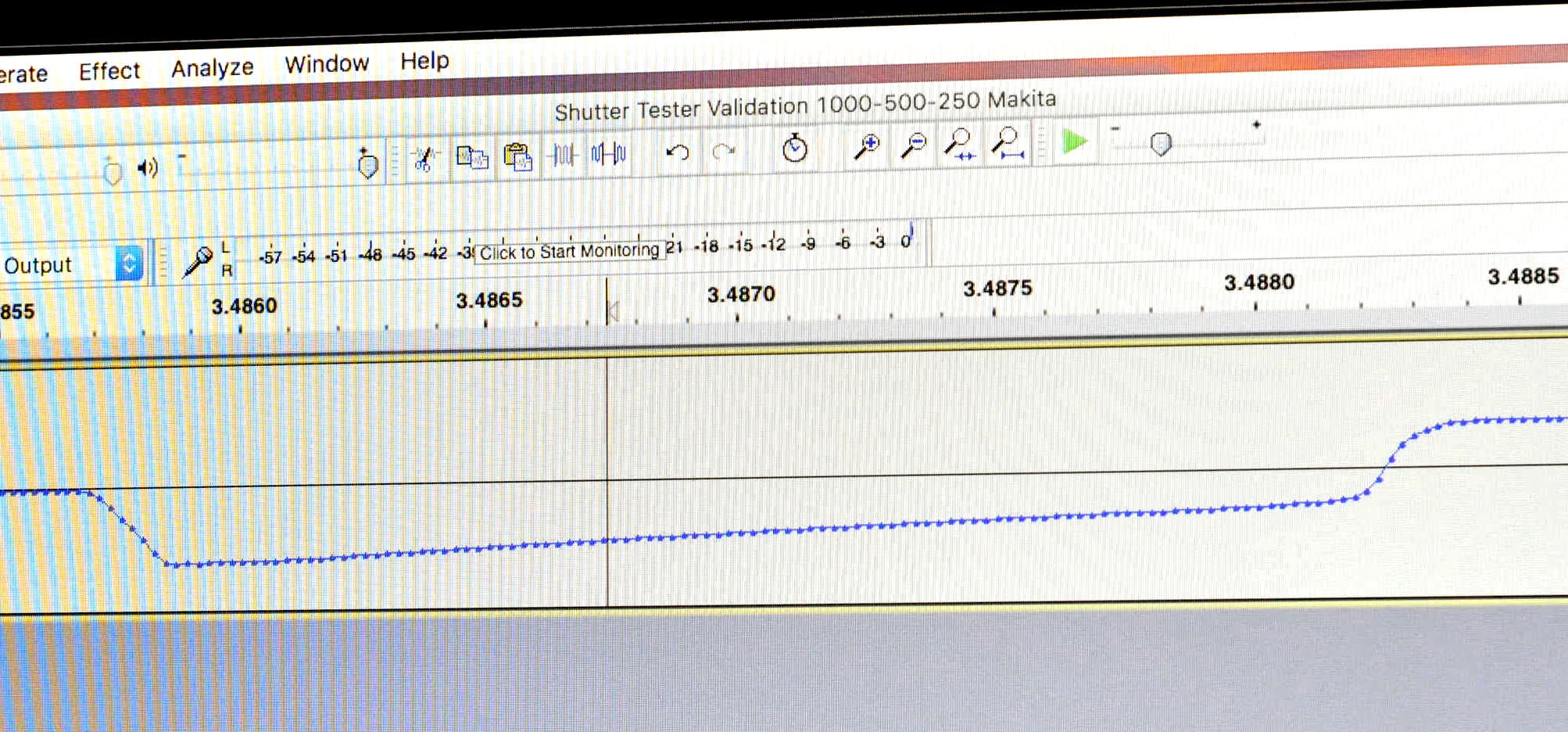

There are numerous methods to validate the readings, I'll only describe a few methods here, and lastly present a simple way that I'll be using as my gold standard.
The first method I used was to calculate the error I would obtain based on the width of my light sensor.
The focal plane shutter is designed to expose each molecule for the designated time. Since no sensor is as small as the molecules in the silver halides, the sensor will give an error because it is not a point source.
It works out that the width of the sensor adds time to the result such that the focal plane shutter slit is effectively enlarged by the width of the sensor.
For example a 1mm sensor makes a typical 1/1000 second shutter slit (2.25mm) behave as if it is 3.25mm.
With a typical cloth focal plane shutter that travels across the film plane horizontally 36mm in 1/60 of a second, the extra 1mm of slit width works out to 0.4 milliseconds extra exposure read by the tester.
So, a 1/1000 exposure would be represented by 44 samples at 44100 samples per second plus the error of .4 milliseconds which is about 62 samples total.
This is pretty close, but still an estimate, because the actual sensor size is hard to measure in the TO-18 package, so 1mm is really a close approximation and the manufacturer does not give a dimension of the actual sensor.
BTW the sensor I'm using has a clear plain glass opening, without a convex lens and I'm using a laser beam, so the distance between the shutter and the sensor does not matter as the rays are not diverging from the light source.

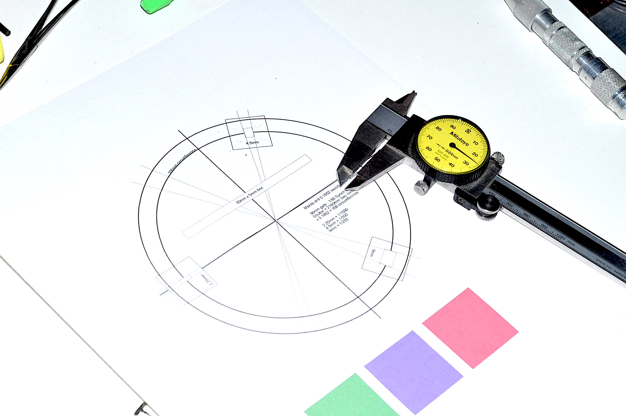

What I describe next is ten cent device that can be used to simulate the progression of the focal plane shutter slit across the laser beam/sensor combination.
To create this device we need to know these items:
Film Gate Horizontal Distance
X-synch Speed
Slit Width at the tested shutter speed
In the case of the cameras I need to test, the Film Gate is measured to be 36mm.
The X-synch Speed is 1/60th. Therefore the shutter curtains need to cross the film gate at 36mm per 1/60th of a second or 2160mm/sec to achieve a correct exposure to the film.
Each speed after 1/60 sees the shutter curtains halving the film gate size. So 1/125 sec = slit width of 36mm/2 = 18mm, and so on so we find 1/1000 of a second would need a slit width of 2.25mm.

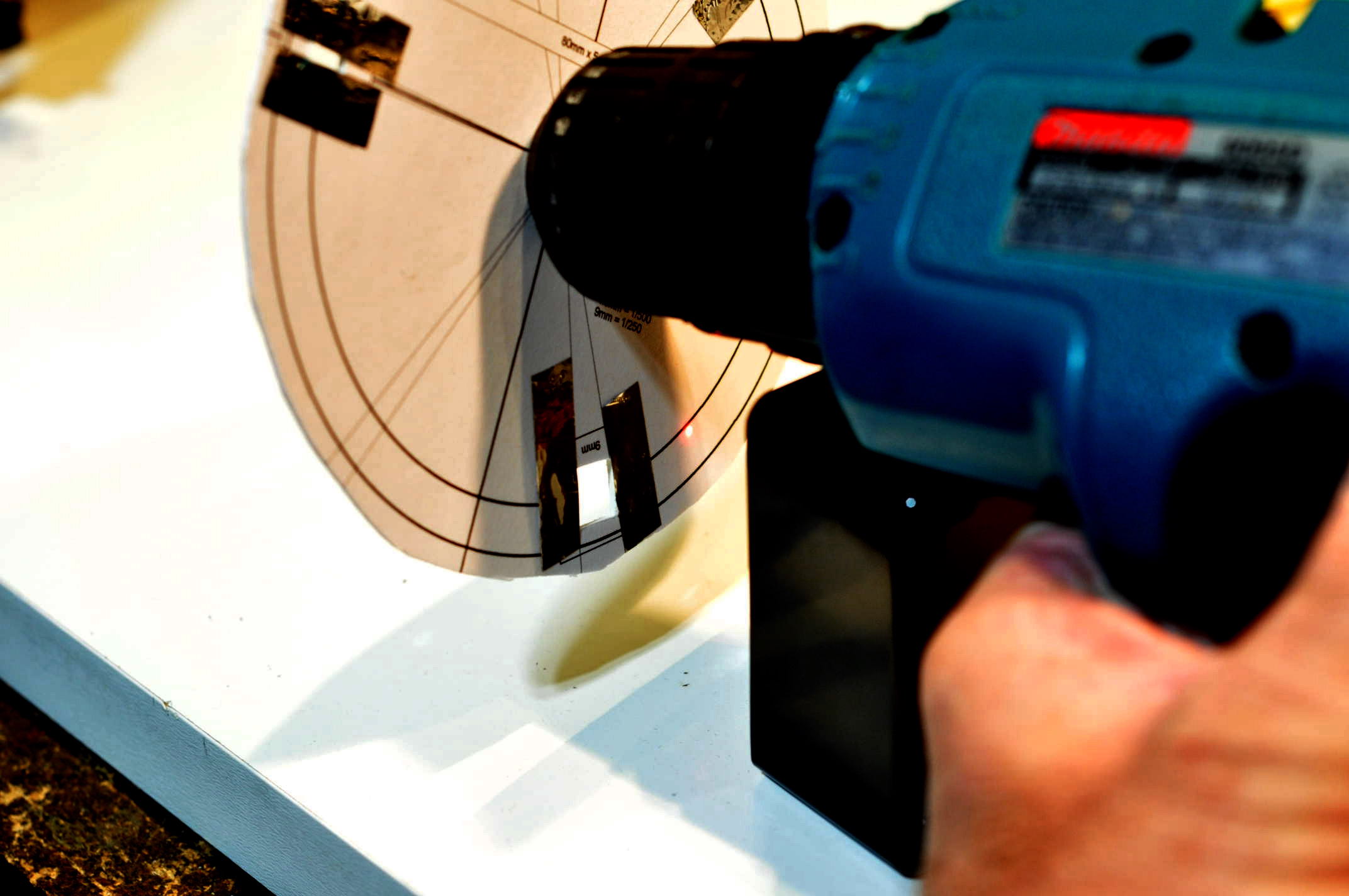

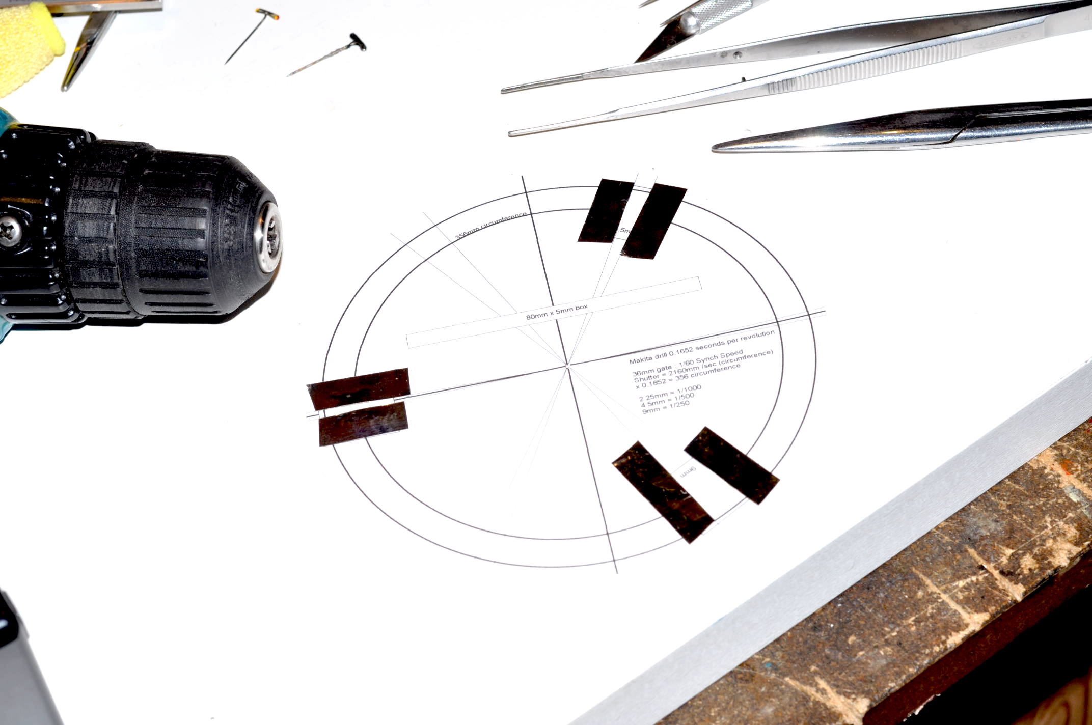

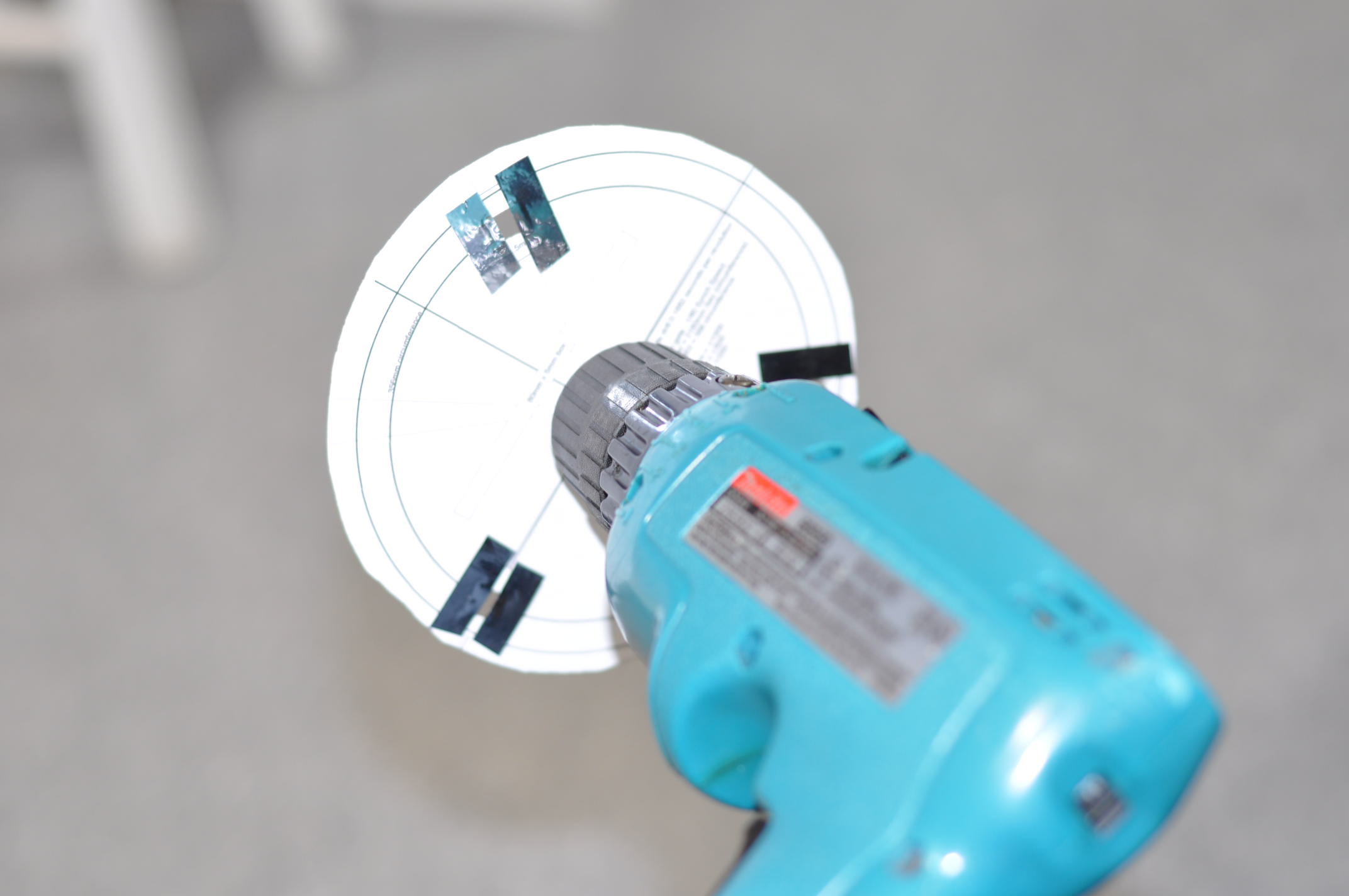

The device consists of a rotating disk with slits which mimic the slits produced by the two curtains of a focal plane shutter.
The disk needs to rotate at a correct RPM so the angular velocity of the slit is 2160mm/sec. This is not that difficult to calculate.
My motor runs at 0.1652 seconds per revolution. This is easily determined by spinning the motor with some sort of flag in between the shutter tester beam. The resulting waveforms total duration are measured and divided by the number of waveforms present in the measured group.
Knowing the motor takes 0.1656 seconds per revolution, we can calculate the distance our shutter needs to travel in 0.1656 seconds.
In one second the shutter travels 2160mm, so in 0.1656 seconds the shutter travels 356mm.
Knowing the relationship between a circles circumference and its diameter (2 * Pi * r) allow us to construct a circle of 356mm by drawing a radius of 56.65mm.
The circle is printed 100% and its dimensions are verified.

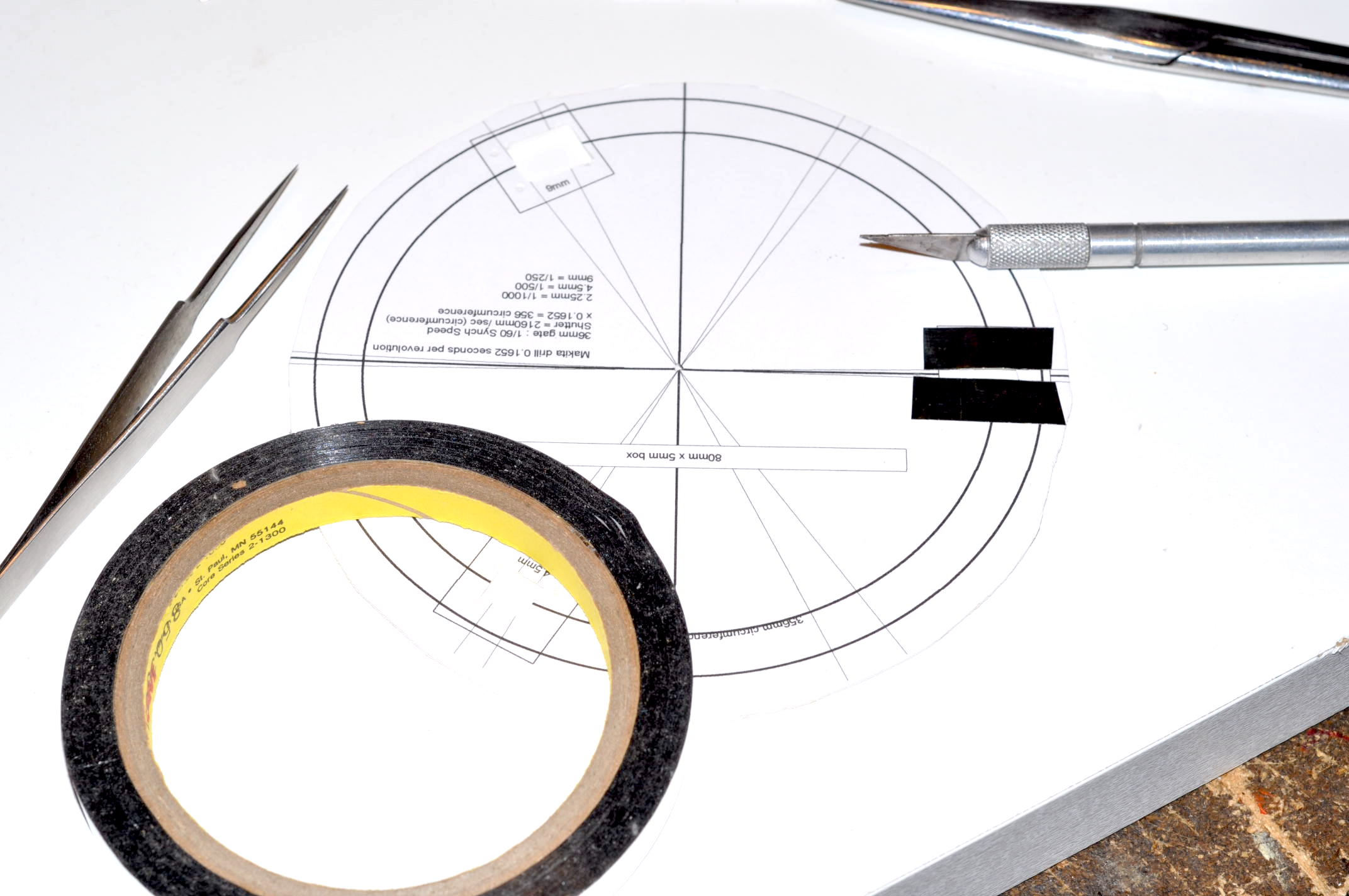

The paper circle was placed on mat board and a punch used to identify where openings should be placed in the mat board.
After cutting the appropriate over-sized openings in the mat board, an adhesive was sprayed on the two items to affix them together.
The mat board was cut in a circle and precision gaps in the disk were created with fine-edged slide masking tape.
The device was then attached to the precision drive motor (Makita 6095D) and spun in between the laser and sensor of the shutter speed tester and the results recorded and analyzed with free Audacity software.
The waveforms were recorded and saved to be used to compare those produced by the camera shutters undergoing speed testing.

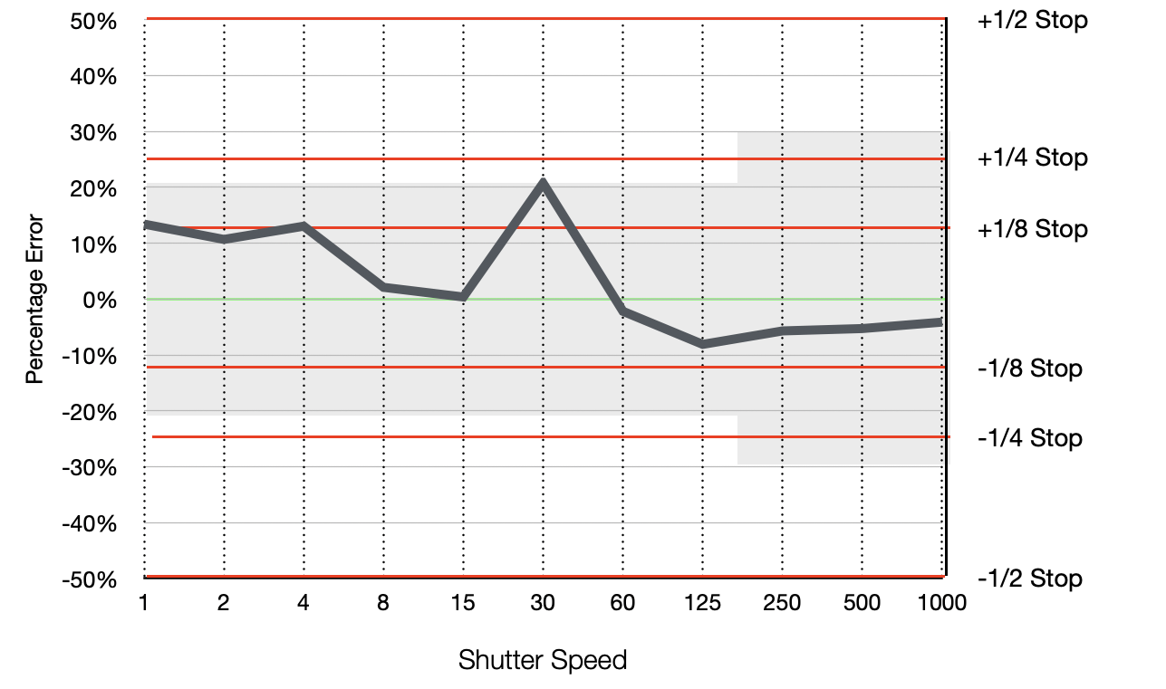

Now that I have calibrated my shutter speed tester, I can make error tables for my shutters like this one.
This is a camera that needs to be cleaned.
