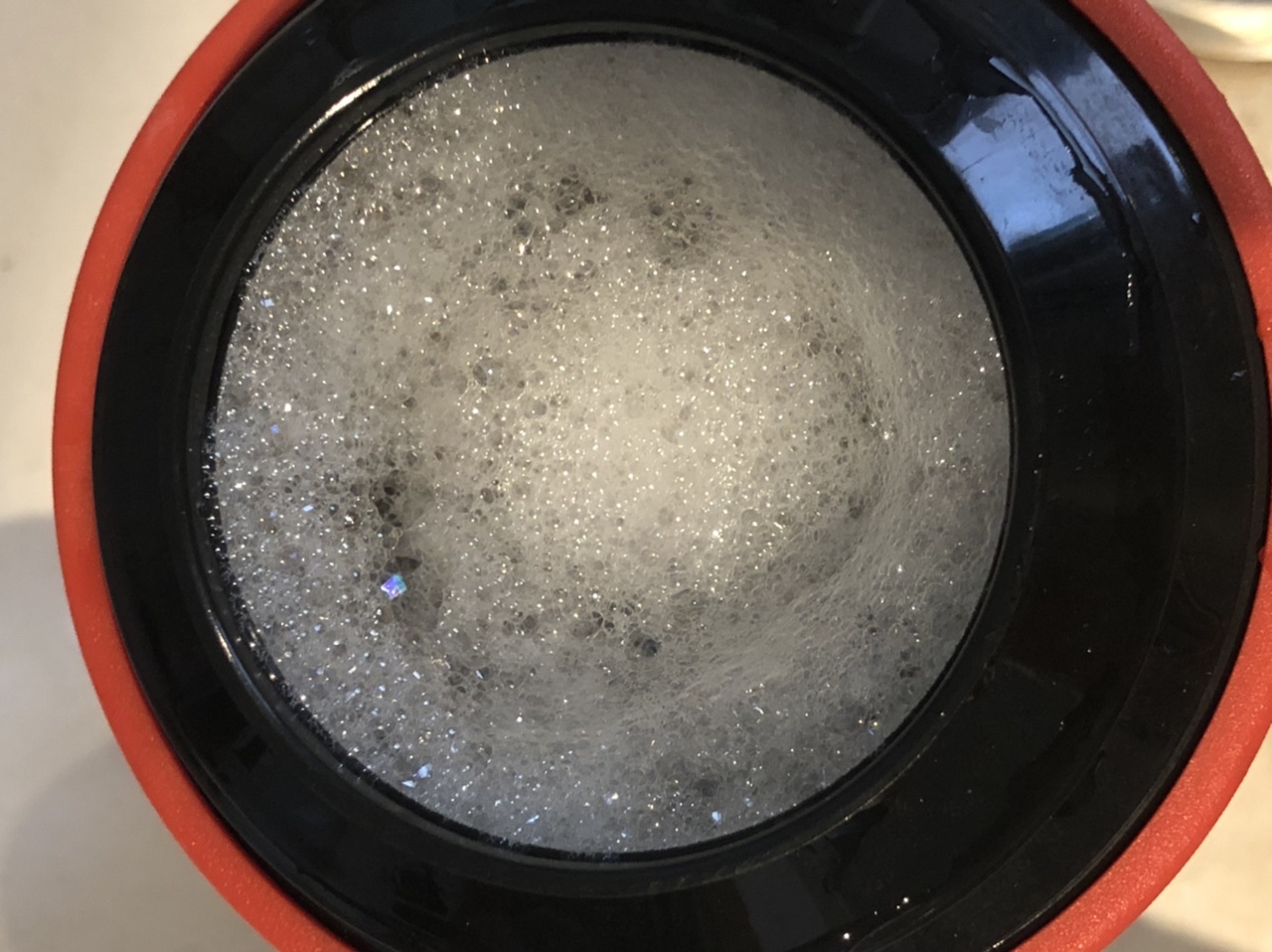

My Jobo tank gets filled with tons of foam during development - so much that it prevents the developer from flowing quickly during inversion (I don't shake - just invert 6 times for 10 seconds - every 60 seconds). I haven't noticed any problems with my films during the last 30 years so it's probably not an issue - but I'd prefer the developer to flow more smoothly during inversion and it would be interesting to know why some people have no foam. I use distilled water with xtol and delta 100 in 120 format. Maybe there is a difference between film formats? Or distilled water types?
I have been home processing film for 30 years and never encountered this much foam and I have shot all formats from 135 to 8x10 many brands of film and chemicals. And I always just use tap water.

BTW, the foaming I see in your images is pretty much what I see. Based on what you are saying and others, maybe its simply some poor stock that I own and the foaming has no bearing on the issue.
I routinely get a lot of foam when developing TMY400 roll film in Jobo hand inversion tanks using PMK pyro. I haven't sleuthed the specific reason for this, and it's the only combination of things which produces it in my case. But I haven't had any adverse effect from it, like streaking or bubble marks on the negatives.

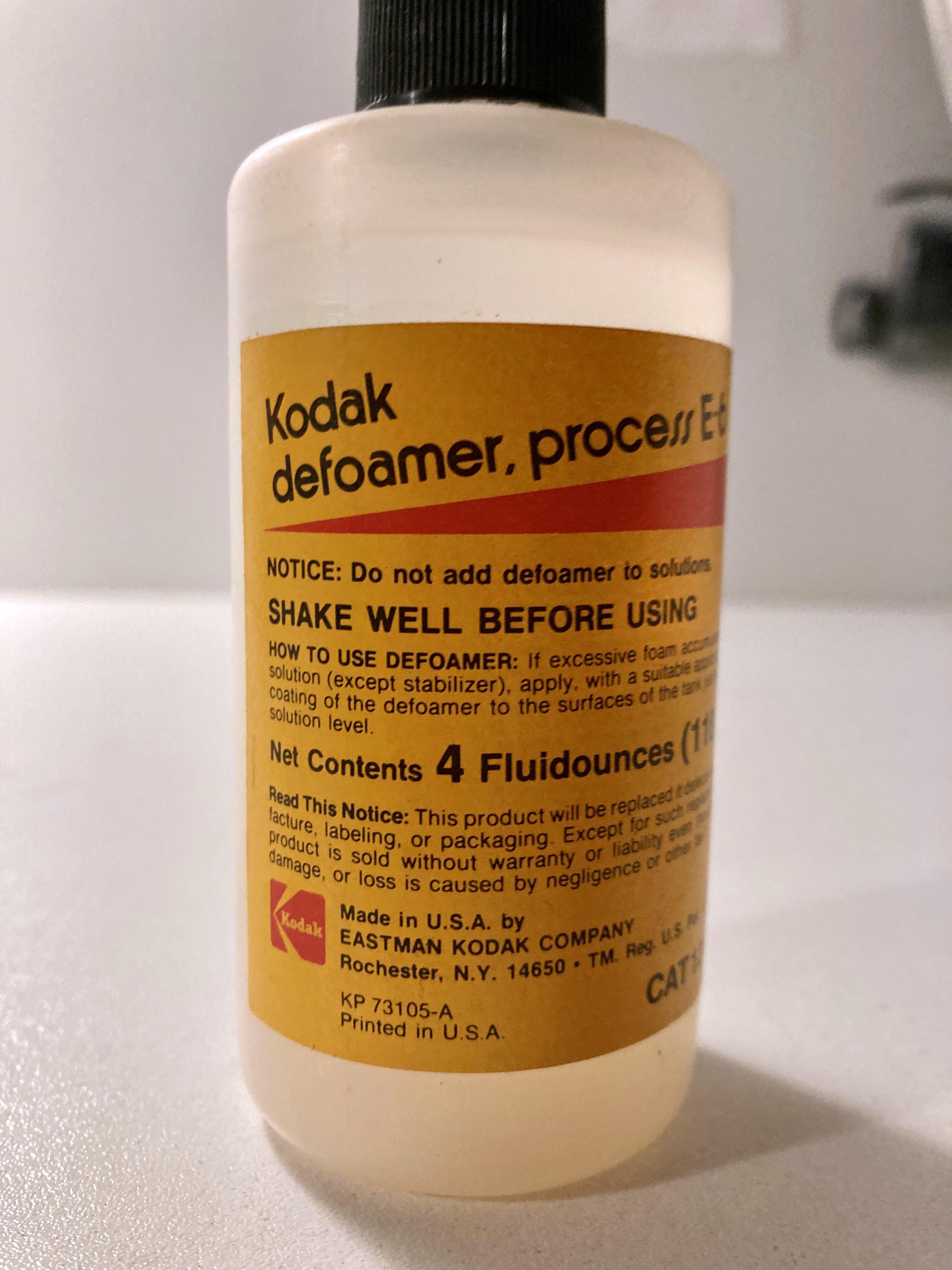

But if this problem might persist and annoys you so much, try to find a bottle of this:

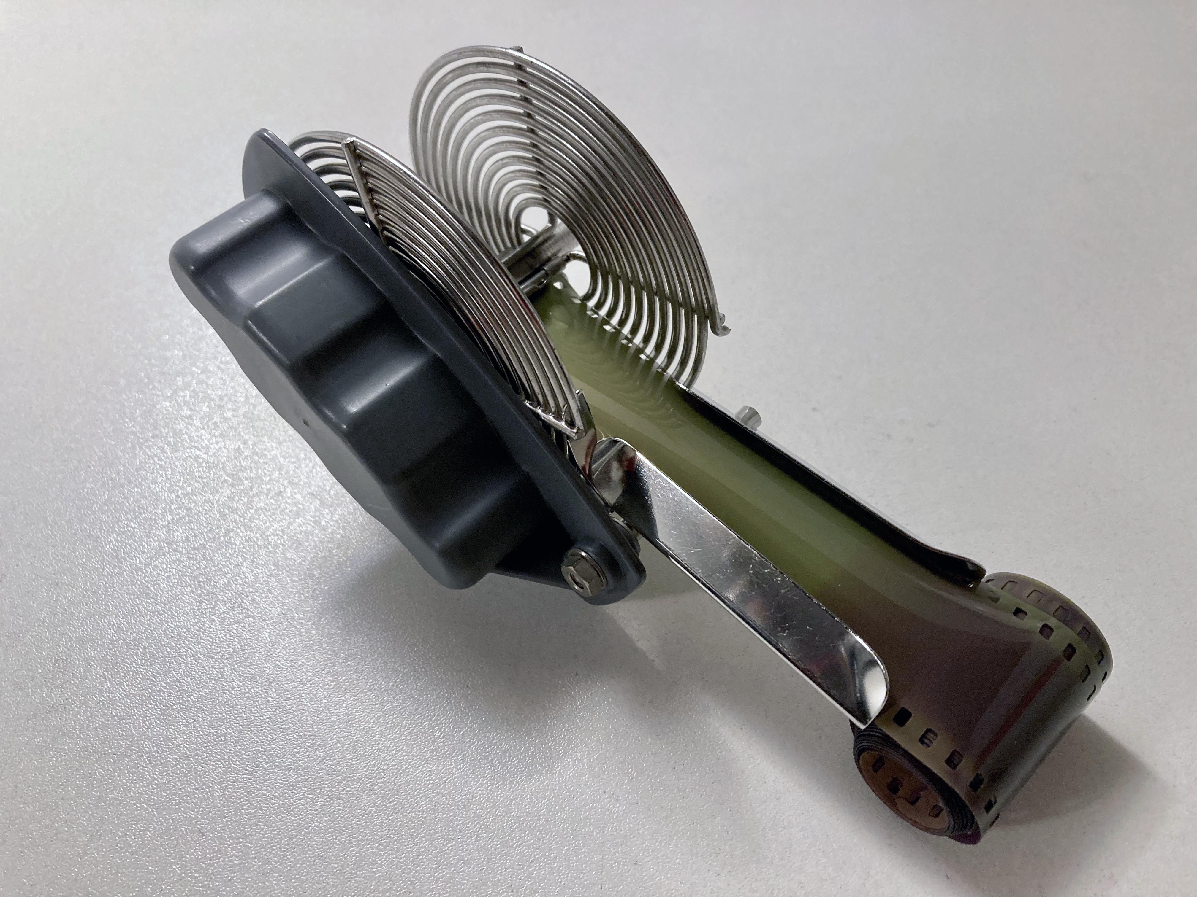

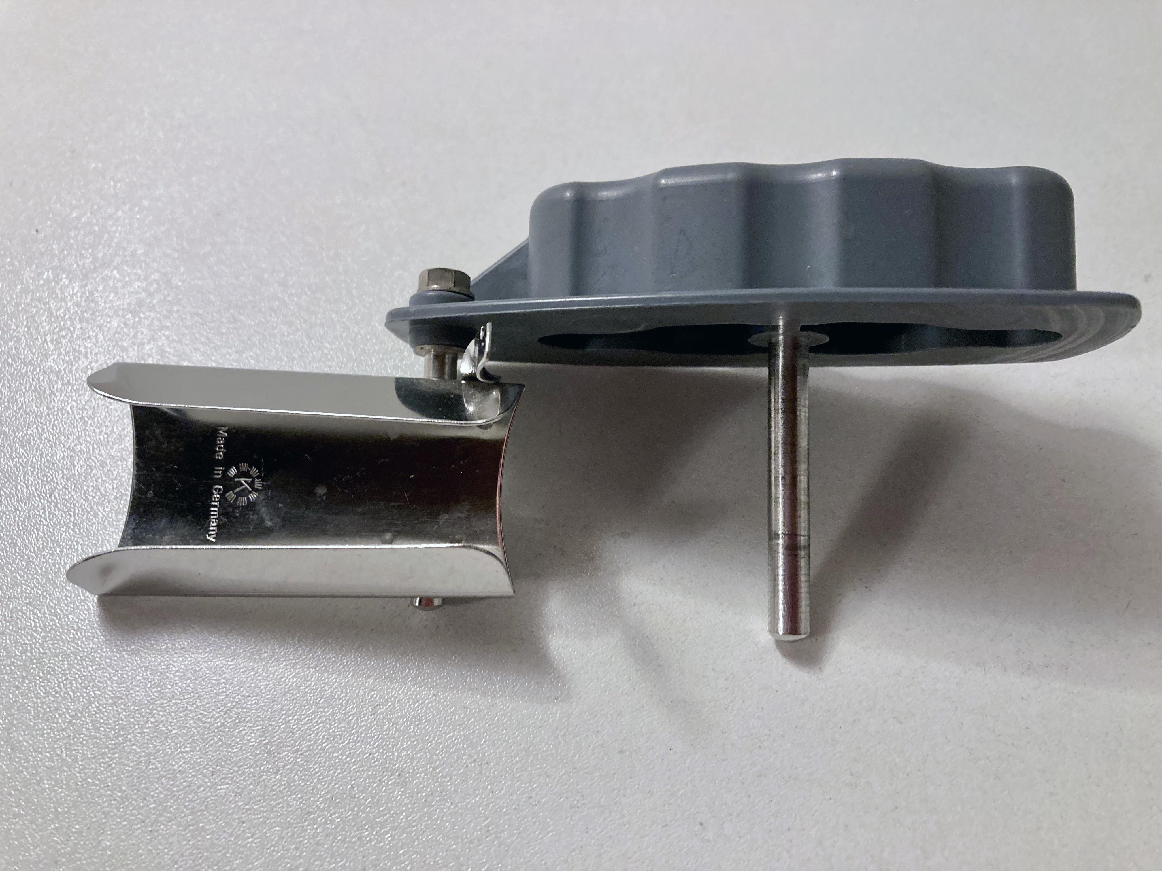

For 35mm film, the best thing one can find is the winding device by Kindermann (sadly out of business), see photo's; but the UK based and still active Hewes has a more sophisticated system.
A modified version of this Hewes loader was also sold by Ilford to load the, rare but interesting, HP5 72 exposure 35mm film system on their special large reels, which I used a lot in the early '90s in my motor driven Pentax LX for reportages.
This Ilford loader can also be used with 'normal' reels.
