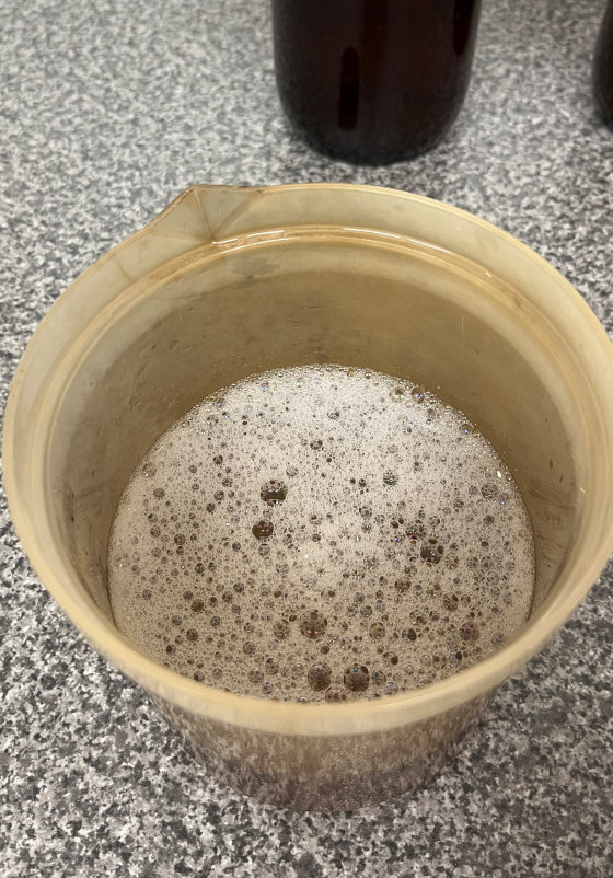

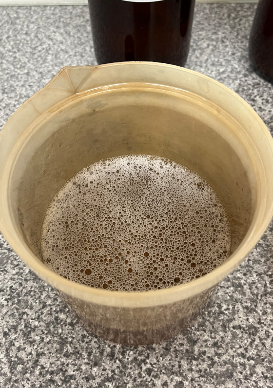

But I am beginning to believe in bubbles. I have just processed a spoiled roll of Delta 100 in my usual 2-bath developer, specifically to photograph what happened. This is pretty extreme, because my routine is continuous agitation for 4.5 min in bath 1. Evidently my memory has down-played the amount of foaming I get - my apologies for that. This is the result after 4.5 minutes of inversions, and again after resting for 5 minutes. No medical jokes please!
Clearly these are quite persistent bubbles, so there must be a surfactant present. I experimentally poured the rest of my developer stock repeatedly from one measuring cylinder to another, and showed that I could generate the same amount foam without adding any film. So the puzzle is not how the bubbles are formed (agitation is enough), but whether the surfactant comes from the film or wetting agent residue. This 1-litre batch of developer had already processed 5 rolls, so there could be an accumulation from either source. I don't do more than rinse my tank after using wetting agent.
There are several obvious further experiments I can try, to identify the main source, so I will report back later. Meanwhile it would be interesting to hear from anyone who uses Ilford films, single-use developer and no wetting agent.
However, I'm still not clear what issues folk believe bubbles cause in their negatives? The classic air-bell circles should not arise if agitation is sufficient and the chemical is taller than the spiral. It's worth stating that in this respect too, my use of a 2-bath developer is quite an extreme case, because I do very little agitation in bath 2. The amount of foaming in bath 2 was somewhat less than in bath 1, but still there. And yet I don't see any negative defects.
View attachment 312207View attachment 312208
