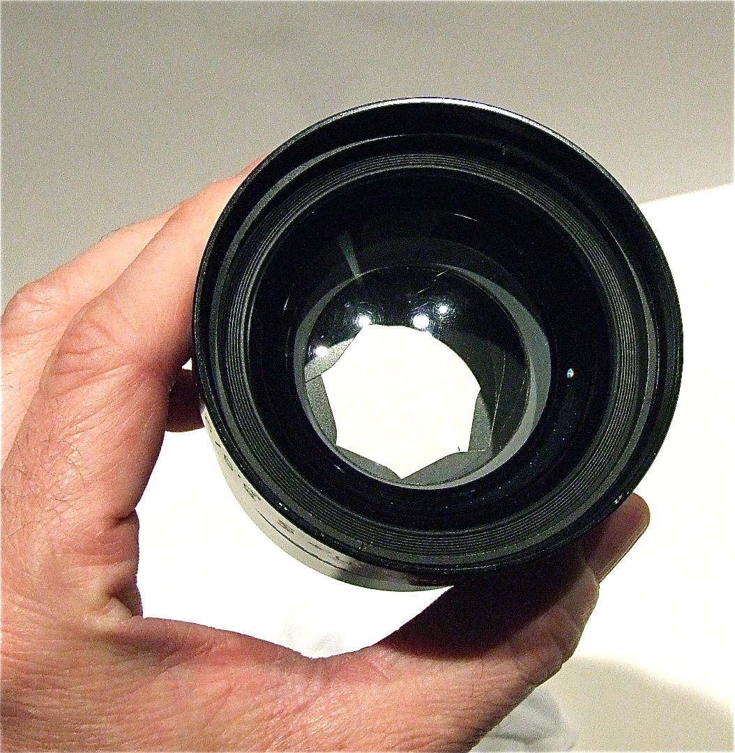

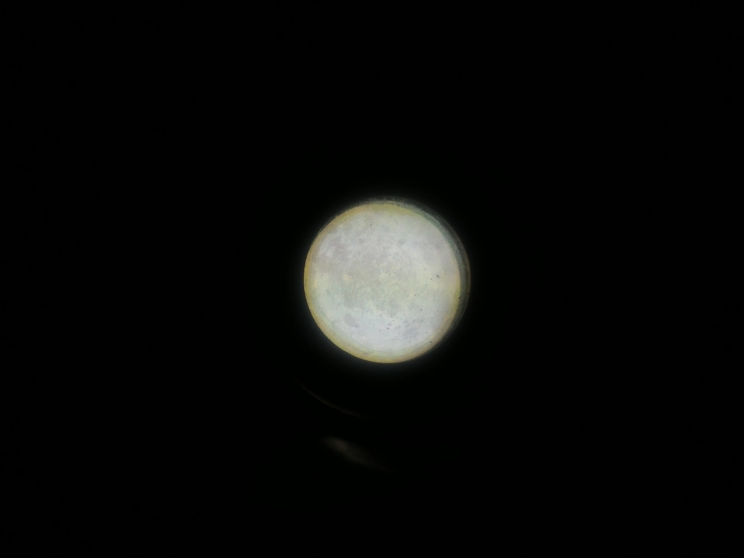

I would say it is haze plus cleaning marks. The attached image should give some idea of how it looks. I was pointing the camera at a well-lit white wall with the back open while taking this picture.

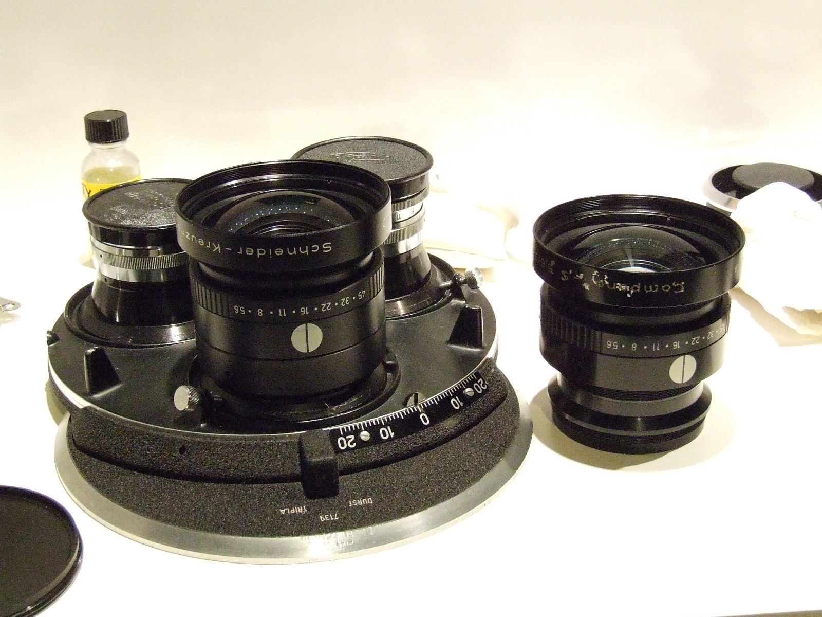

I had some similar projects like that. In this case I swapped all the lens elements from the beat-up barrel to the pristine barrel with the Durst flange. The 'good looking' lens barrel with the Durst flange had lens elements that were destroyed by 'cleaning marks.'

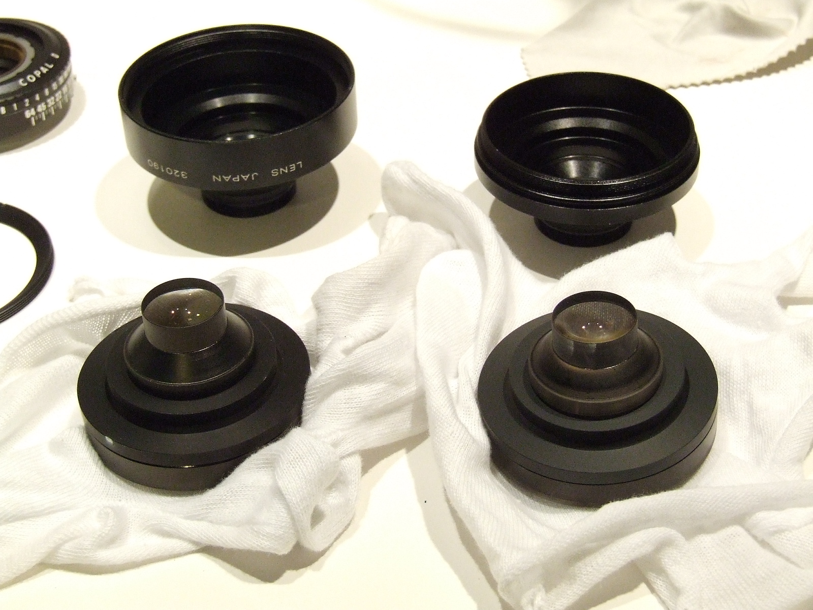

This was another similar project. A 90mm lens with a special barrel to fit the Horseman 4x5 camera. But it had fungus. I swapped lens elements with a similar pristine lens that had the exact same lens elements (a Caltar HR) but a different barrel.

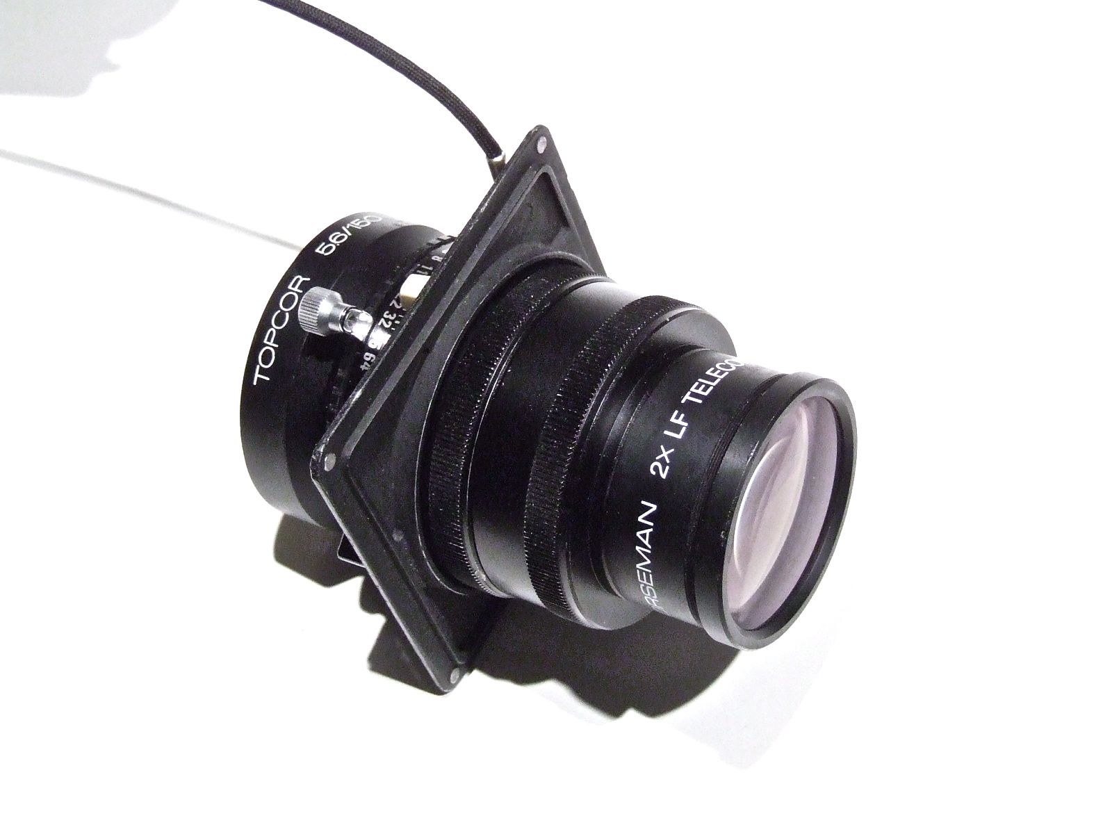

Ok so one last "Not So Happy" story. I paid fair market value for this large-format teleconverter. That little thing has seven lens elements and 14 surfaces and it was hazy (more lens elements than your entire Yashica lens). However, after total diassembly (a major ordeal) and cleaning, it is still hazy. :sad:
